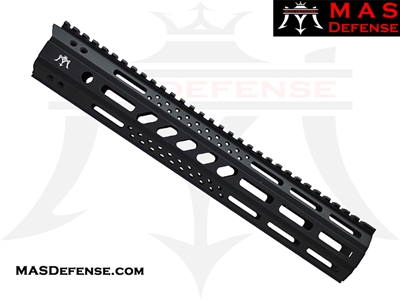

Honestly I just stuck with the BCA rail. It's a heavy pig for what it is, but on the plus side It doesn't flex much at all.
Matrix Arms will work.
Dirty Bird Industries will also work. It's basically the old Expo Arms rail, but it doesn't have anti rotational tabs.

If you are looking for handguards without any type of anti-rotation device, then the field is wide open.  Anti-rotation tabs that will play well with the BCA upper is a much smaller list, I think.

For those looking for fat handguards to tuck a suppresssor, I found a US company that makes a bunch of different lengths with 1.8” ID.
https://www.masdefense.com/MAS-DEFENSE-12-62-MW8-OCTAGON-M-LOK-AR-15-RAIL-p/mas00106512.htm
https://i.postimg.cc/6q4CMGqf/IMG-5142.jpg
Mas Defense is GTG
Looks like an Aero Precision style BAR Rail. Those are pretty nice for tucking a suppressor into. Not sure if the MLOK slots will be usable though.
