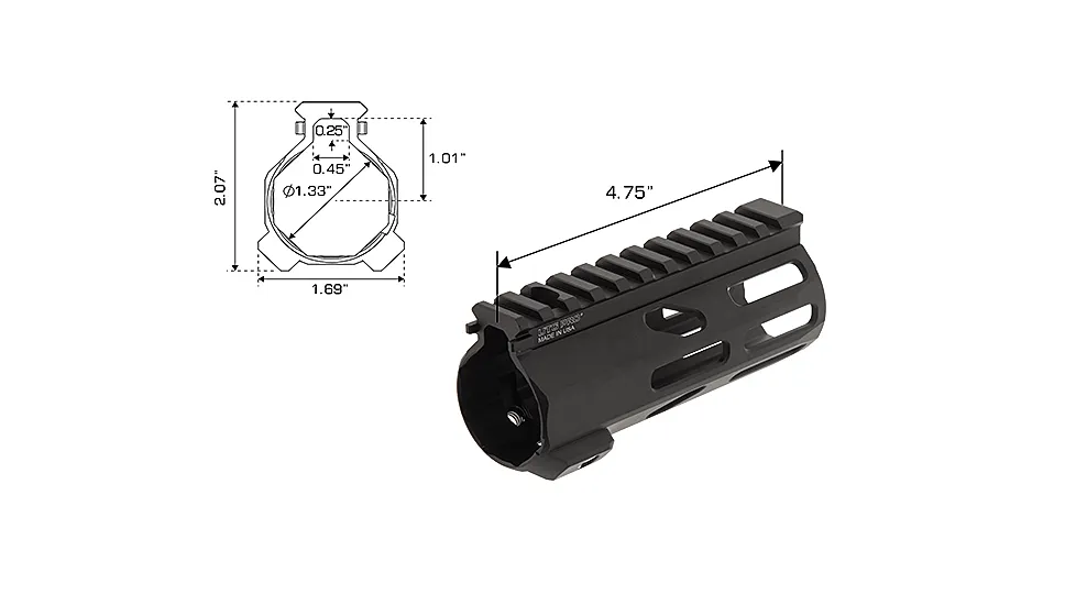

Looking for a handguard for my 308 build. How do I tell if this is a high or low profile receiver?
2/16/2026 2:12:41 PM EDT

Does anyone have a measurement of width where the magazine inserts?
Fired off an email to bear creek and never heard back.
Looks slightly larger than standard, and I’m curious if I can run it with my SIX8(SFAR etc) lower and wider mags.
2/16/2026 2:22:57 PM EDT
I seen where google said measure the hight of the charging handle tang, but these uppers don’t have one lol.
2/16/2026 2:35:32 PM EDT
hold it next to one with a charging handle and give it a best guess

bca is dpms high
actually like this for building a backpack bolt gun.  has a lot of advantages
2/17/2026 7:48:30 PM EDT
Really you think it’s high profile? I was really leaning toward low profile based on the rear tang dimensions
2/17/2026 7:57:16 PM EDT
[Last Edit: AL1EN][Edited] [#21]
Just found this endlessly searching through BCA Q&A… ok it wasn't endlessly, I got pretty lucky.
*What platform pattern are your AR10 Uppers?
Our uppers are made based on the DPMS Gen1 Low Profile model. With the AR10, there are many different designs and models out there, and each company tends to create and design its own unique platform.  For that reason, we cannot guarantee the fitment.../*

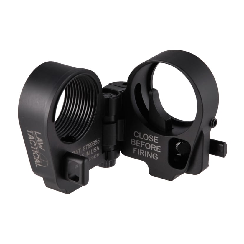

Bummer, I was hoping I could use LAW folder in the FOLDED position, but I can't.
Even the LAW folder with the ARIC end cap is just a hair too short.
I mean, I probably could use the folder in the folded position if I cut the bolt, but I was hoping to not have to do that.
Regardless, I'm now the (proud?) owner of a 6" 300blk Bolt Action BCA upper!   The "plan" is to install my 12.5"  300blk barrel on it and give it a try.

I need to add a caveat to using one of these with an uncut bolt and a LAW folder in the folded position.  It "can" be done, but it will require you to use two hands and most likely hold the straight up by placing the muzzle on the ground.  You will need to use your right hand to operate the bolt as normal, but you will need your left hand to hold down the "release" button on the LAW folder.
When the folder is open, it is that vertical piece that I think is made to keep the BCG from sliding out of the back of the gun is the problem.
That vertical piece is attached to the spring loaded locking/release mechanism and it slides to the left when the release button is pushed and/or when the folder is closed.
What might also work is a some type of metal O ring that just sits in that spot and keeps the locking mechanism open.  Just tighten the tension on the hinge so is this not swing.
I've probably worked the action 600 times so far.  It isn't too bad.  First thing I did when I got it was put a bunch of thick lube on it and went to town.  Whatever grit and dust was in there was going to be my grinding powder.  Probably cycled it 300 times before I took it apart, cleaned it, re-lubed it, function checked it, and then cycled it a bunch more.  I cycles really easily unloaded.  It is a hair tougher loaded.  I only have two 300blk snap caps, so using those are annoying to reload, but I don't want a bunch of light primer taps on my ammo.
2/28/2026 7:54:48 PM EDT
Update!
Or.....spend 90 seconds reading the LAW folder manual, and 60 seconds removing the one hex screw so you can remove the spring and latch, then another 30 seconds to loosen, then tighten the hinge tension.
I can now cycle while folded with an uncut BCG.  I just stuck the spring and latch in a plastic baggie with the BCG extender plug it comes with anyway.

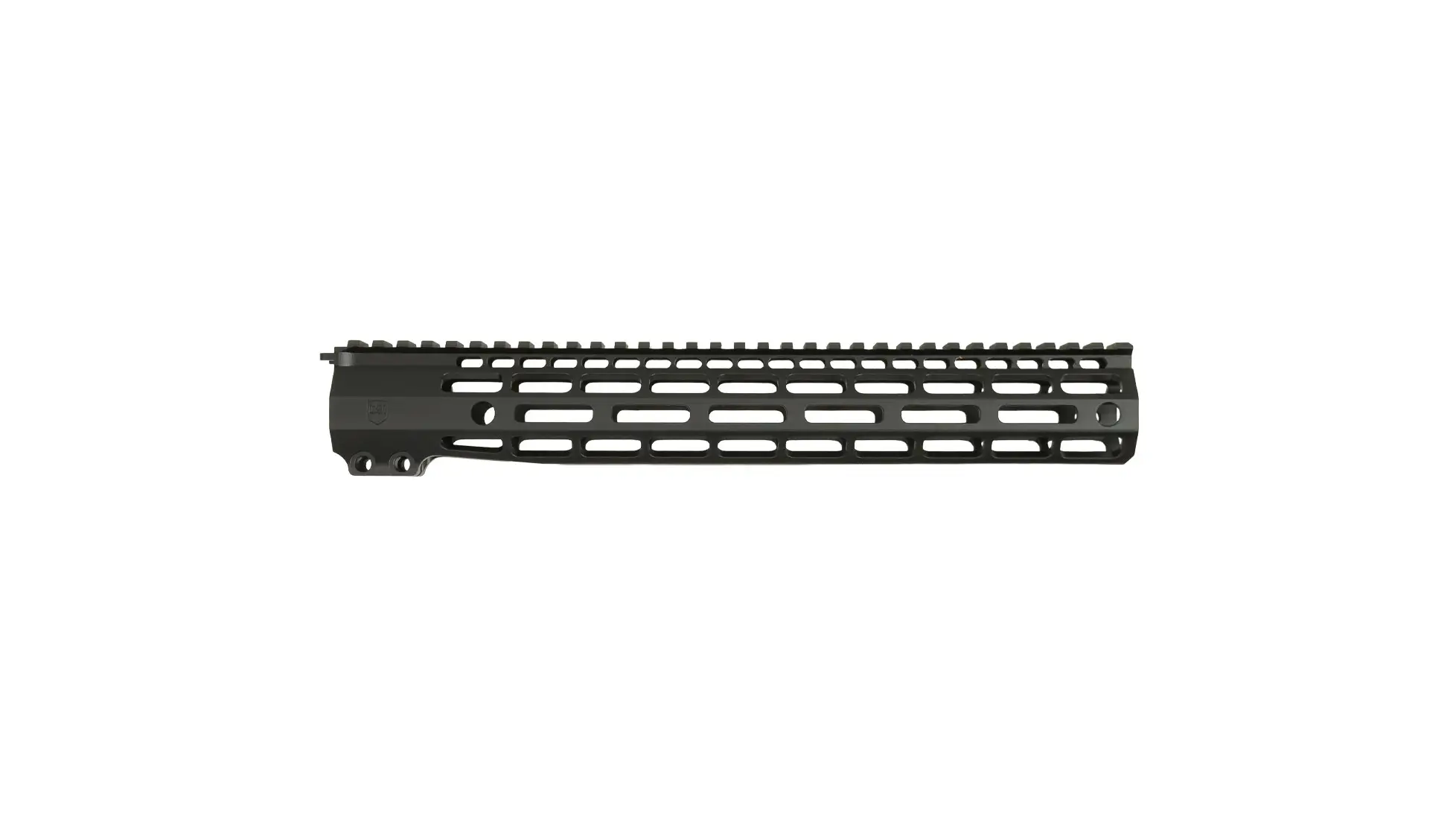

Maybe I missed it, but is there a running list of solid rails with anti-rotation tabs that work with these uppers?
I know my Midwest Combat rails and Aero Atlas rails do not fit because of the anti-rotation wings.  However, I have and old PSA rail that has the anti-rotation tabs up on the pic rail section that does work.
What else is available?
Troy?
Would BCM work?
3/3/2026 1:44:13 PM EDT
[Last Edit: PreacherOfGadget][Edited] [#49]
Hmmm...  in all honesty, it would be nice to have a post documenting anti-rotation tabs, height and placement so compatibility can be determined.
BCM's anti-rotation tabs are high enough to work fine with BCA's receivers.  They use the same tabs for all of their free float rails, so that applies to KMR, MCMR, QRF, and Raider Rail.
My most recently purchased BCA bolt-action receiver (late spring 2025) measures 0.31" from the bottom of the picatinny rail down to the point where the receiver begins widening.  So any anti-rotation device that sits above the main body of the receiver, in the ~0.3" below the rail should work.
Most handguards that just extend the body of the handguard backward to form anti-rotation tabs will not work.  There are some handguards with large enough barrel nuts, like those designed for suppressors, that have an extension of the handguard rearward which is high enough to clear the body of the receiver; for example, based on my measurements, I suspect the MI Suppressor Series One Piece (ID 1.67", 1.95" between m-lok slots) would fit or need only minor modification of the tabs to fit.
Troy MRF rails probably will not work because the tabs are too low, and others similar to it might have issues, too.
Their rails w/o anti-rotation tabs work fine.  I have a BCA bolt action upper in 338 ARC with a Gen2 SOCC Low Profile M-LOK BattleRail.  No tabs on that line or their Bravo Rails.  I don't think there's one on my Alpha Rail either.
ETA:
Looks like UTG Pro Arwen and Forerunner handguards should work.

Dark Storm Industries, too
Image from OpticsPlanet
SLR Solo Intrepid Lite
SLR Solo's is a little different, as it uses the gas tube for anti-rotation.
ZRO Delta Mission Ready LVOA Rail
Some of Samson's rails might, or might work with minor modification
Stern Defense MOD4 and MOD5 M-Lok Handguards
Next Level Armament NLA AR-15 M-LOK Handguards
Sharps Bros. Full Top Rail M-LOK Handguard
Outerwild AR15 Premium Line Handguard
XTS AR-15 M-LOK Rail
I want to make clear the ETA list is a list of handguards that should work based on apparent geometry.  Do not take this as any sort of endorsement of their quality.

It can be operated while folded, but the folder does not latch shut.  I contacted LAW tactical earlier today to see if I could get some spare parts to work on before I go about cutting down my bolt...I really don't want to do that. I want to keep the back of the action sealed when the bolt is closed.
