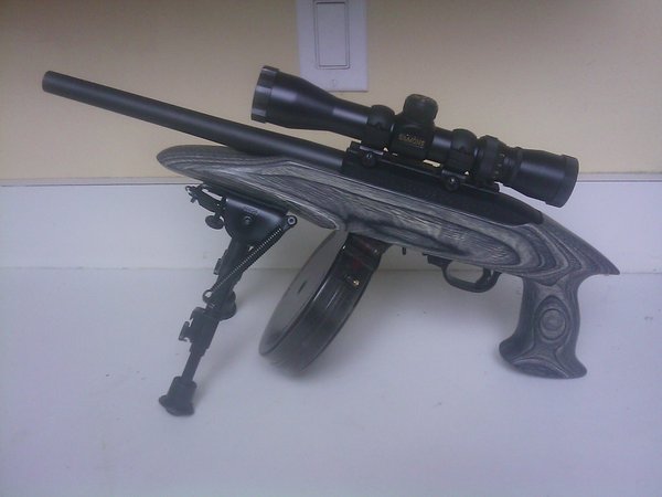

Posted: 5/12/2010 10:08:13 PM
Well, I can't compete with ^^^^
But here's a pic anyways:
It looks cool but doesn't feed for shit!
