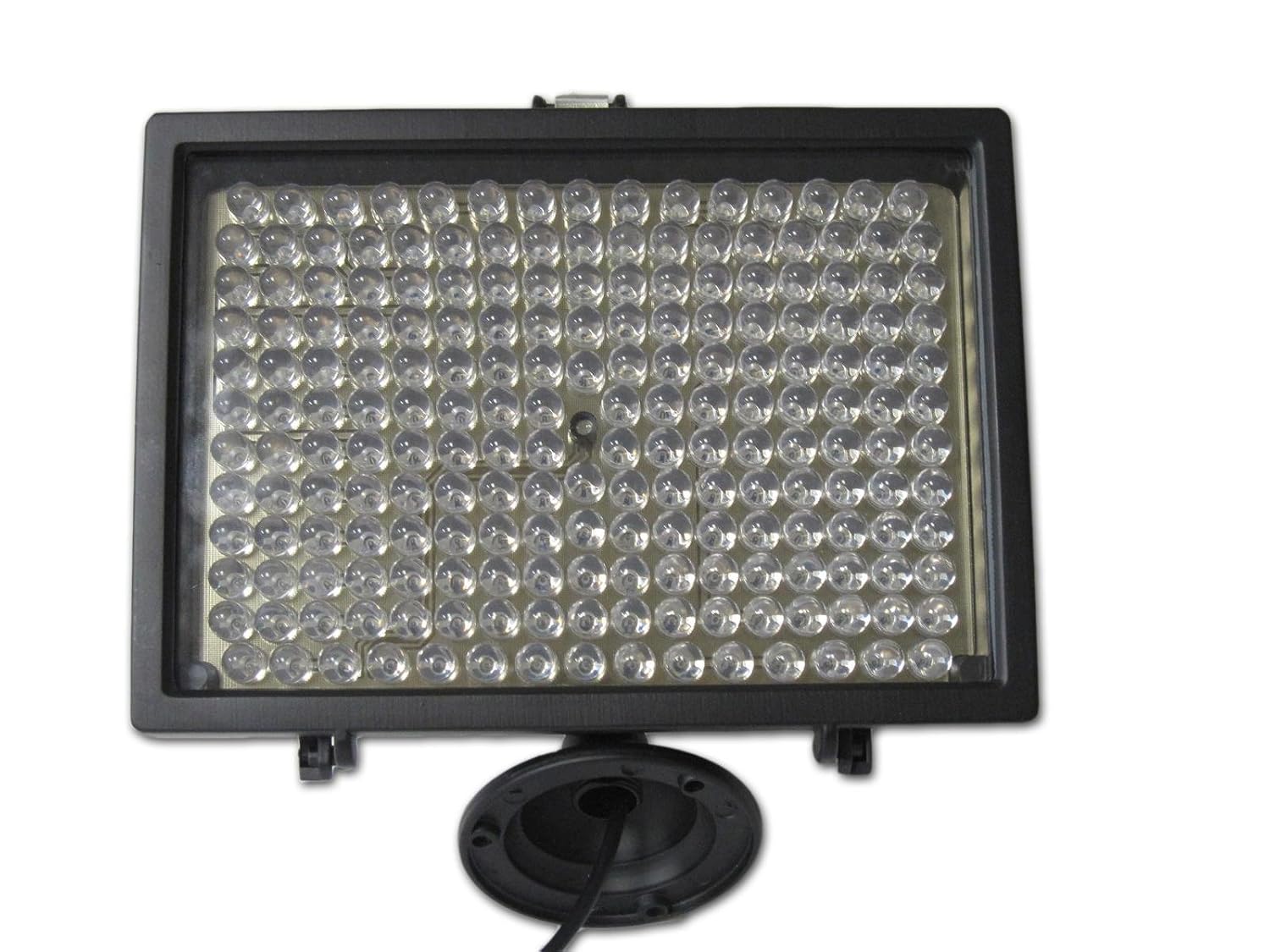

And now for a few night pictures (same illuminator used in all pictures):
Acti E72:
Hikvision:
Mobotix M12:

Yikes...  The Acti actually had a slower shutter speed (1/15) than the Hikvision (1/60)... so the Acti image should have been better/brighter.
Here are the comparisons between the two cameras, both at 1/60th shutter speed:
Acti E72, 1/60th shutter speed:
Hikvision, 1/60th shutter speed:
Now don't pay so much attention to the foreground, since the Hikvision image contains IR light from both the Acti camera, and the Hikvision camera.  The Hikvision images were taken when the Acti and the Hikvision were mounted side-by-side, and the Acti image was taken while the Acti camera was mounted solo... so the foreground part of the image in the Hikvision JPG is benefiting from the IR light from BOTH cameras... while the Acti JPG has only its own LEDs.  It shouldn't make a huge difference (since camera IR tends to be weak anyway), but I want to make that very clear from the start.  To truly appreciate the difference, look at the fence area in the background, and the playcenter further away from the camera.  You can appreciate the lack of digital noise/"hash" in the very dark areas of the image.
The Hikvision has better night performance.  Straight up.

Seeking to know if this is a bad idea!....
I want to use a splitter to run this, along with a bullet camera:
http://www.amazon.com/dp/B004V9Z7ZY/ref=wl_it_dp_o_pC_nS_ttl?_encoding=UTF8&colid=1KAG83TZNAUNP&coliid=IY05AQWNQB345
With this kind of cable:
http://www.amazon.com/VideoSecu-Video-Power-Security-Cameras/dp/B000P8X65S/ref=sr_1_1?ie=UTF8&qid=1394685874&sr=8-1&keywords=camera+bnc+100ft
I know I am missing specifics here, such as the amperage each unit draws (I don't have that info yet), in my head, one cable should be able to power a camera and this IR illumination spot light....no/yes?...am I crazy?
Thanks, ahead of time!

That illuminator probably pulls 800-1000mA, and your camera (depending on type/brand) may pull that much as well.  So let's figure a maximum of 2 Amps of current down that skinny little power wire (which is probably 20 or 22 gauge)
That's a LOT of current for a 100-foot run, and you're going to lose a LOT of voltage to line loss.  Think of putting a high-pressure stream of water through a skinny little tube (like a straw)... you simply can't force that much down a thin tube.
Reference this voltage-drop calculator
If you assume that power wire is 20 gauge, you're going to lose 4 volts just from cable losses.  In other words, with a 2 Amp current draw, put 12 volts in the head end, and you get 8 volts out of the other end.  This isn't enough to run most devices.
If you assume that power wire is 22 gauge, it gets even worse.  Now you lose HALF of your voltage from exactly the same cable run.
So skinny wire = bad.

Is anyone here using a central bus-based power distribution system for their cameras?  What I mean is, rather than finding power (assuming not POE) near each camera location, home-running power cables back to a central location, and then having a sufficiently robust power supply to power the cameras and compensate for wire length loss.  I'm looking at some POE cameras, but want to keep my options open for standard DC-powered cameras as well. Just don't want to have to locate power (or relocate, possibly against code and therefore voiding my homeowner's insurance policy) to get them to work.
Even if I go with POE cameras, I would like to install an IR illuminator with most or all of them, so power will be an issue there also.
Thanks.

Yes.  I use one of those for my illuminators (I have a half-dozen or so 12VDC-based IR illuminators around the main house, connected to a 12VDC camera PSU).  There are several others that are higher-amperage (and cover larger areas), and those have their own power wiring off household current.

I made a post on page 87, of this thread about this... perhaps it will help?
