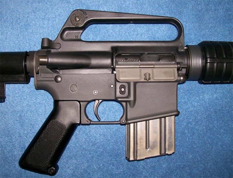

If your upper is already gray, just use one of NoDaks NDS-16A1 lowers already anodized gray.
Anyways, Norrell's moly resin "GRAYISH-BLACK Flat" is close.  Here is a pic of a lower that was sprayed with Norrells.  The upper is factory anodized.

http://www.ar15.com/forums/topic.html?b=3&f=123&t=406431
I'm building a 604 at the moment, that's why the receiver differences are fresh in my mind.
Just waiting for NoDak Spud to get caught up and send me my lowers.
I might go with the anachronism of the full-fence lower with a three prong flash-hider.
