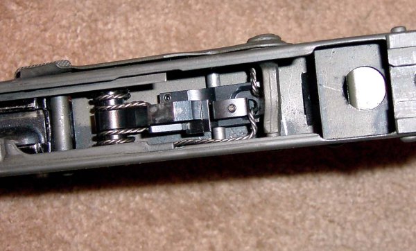

I installed one in my Maadi.  took it to the range.  Pulled the trigger.  Bang.  Tried to pull the trigger again.  No pull, no bang.  Worked the action.  Live round popped out.  Pulled the trigger.  Bang.  Tried to pull the trigger again.  No pull, no bang.  Worked the action.  Live round popped out.  Pulled the trigger.  Bang.
What should I do?
Link Posted: 5/22/2003 11:33:20 AM EDT
With firing is the bolt going all the way home? Push on the handle(safety on first) and then try. I'll bet it isn't. Maybe internals hanging up bolt a little. A little stoning required or just some break in maybe.
Try taking the top cover off and working the action. Pull trigger, etc. Do so unloaded of course. What happens.
When you work the action is there a lot of force required to pull bolt back? There should be a little bit of "hang up", for lack of a better term, but it shouldn't prevent functioning.
If it is short stroking due to hangup on the hammer and disconnector you would have this problem as the hammer is not being locked down on return of the bolt/carrier. Hence, no pull. Fire it and put on safe. Remove top cover. What do you see?  Pics would be great.
Also, are you sure that the retainer is properly placed and that trigger and hammer pins are fully in place? That could definitely lead to the above problem. Eventually will work themselves out of the receiver also.
Disconnector and spring properly installed?? The disconnector spring should be fully seated into the hole for it in the trigger.

The bolt is travelling back far enough to strip a new round, So I don't think that's the problem.  It is going all the way forward, and the hammer is following it.  The hammer is simply not catching on the trigger for whatever reason.  It ran like a, well, like an AK before I replaced the trigger.  I just sent an e-mail to Ken in response offering a plate.  I'll put it in and see if it helps.
Link Posted: 5/23/2003 9:51:48 AM EDT
However, everything is working properly when you cycle the action manually, is it not?
That's what makes me wonder about it short stroking for some reason and if that is the case and the only thing different is the FCG...
It might still strip a round but not reset the disconnector if this were the case. I guess the question really is what happens internally that is different with manual vs auto cycling?

Replaced shepards crook with plate.  Pins were defeinitely all the way in this time.  Same drill at the range, exactly (fire, no pull, live round in chamber, hand charge, fire, no pull...).  checked pins again.  They had not walked out at all.
Checked action.  No unusually difficult hang up, no extra force required to charge.  After firing the new round was completely chambered, the only issue was the hammer was down instead of back.
I have not yet moved any of the set screws at all.  I left them factory original.  My next thought is to adjust the disconnector screws.
