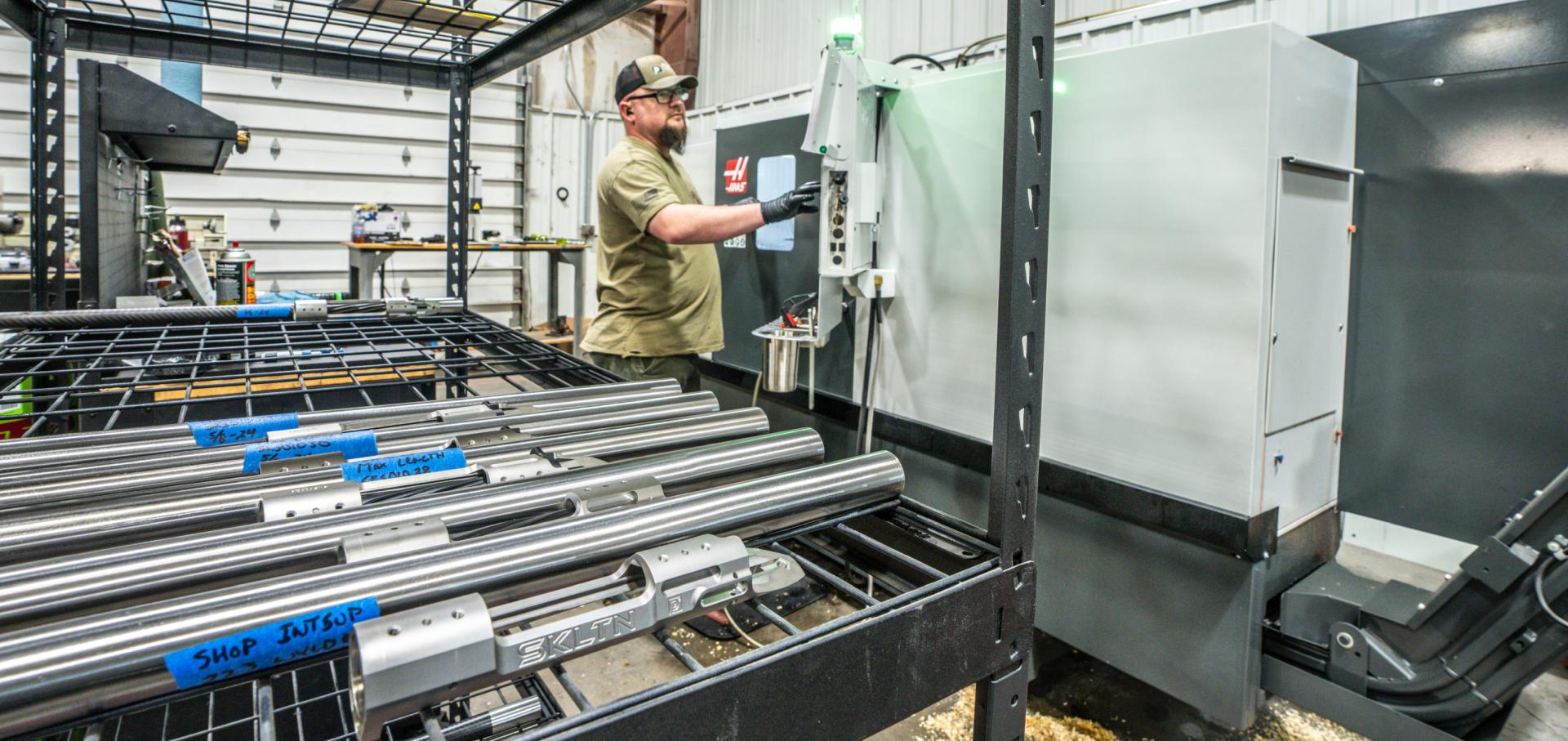

Since that time, PurePrecison has grown their manufacturing by taking on partners from an aerospace machine shop they had previously worked with so that they now manufacture actions in-house. The SKLTN we will be looking at in this review is the first such in-house manufactured action model from PurePrecision. While still including the custom rifle shop function that produced the Crux rifle a few years back, PurePrecison has also added a large retail function they are calling The Battalion that sells a variety of high-end optics, reloading components, ammunition, shooting accessories, and rifle build components from both PurePrecison and other makers. Their in-house manufactured actions we are looking at here are intended for their custom rifle business, to supply other smiths for custom rifle builds, and for use in the increasingly popular DIY pre-fit market. Pre-fits are available from Carbon Six, Helix 6, Precision Rifle Blanks, Straight Jacket, McGowen Precison Barrels, and Proof Research. As such, the Proof barrel utilized in this review is a pre-fit and was pre-chambered to spec by Proof instead of being chambered, threaded, and crowned by the PurePrecision guys.

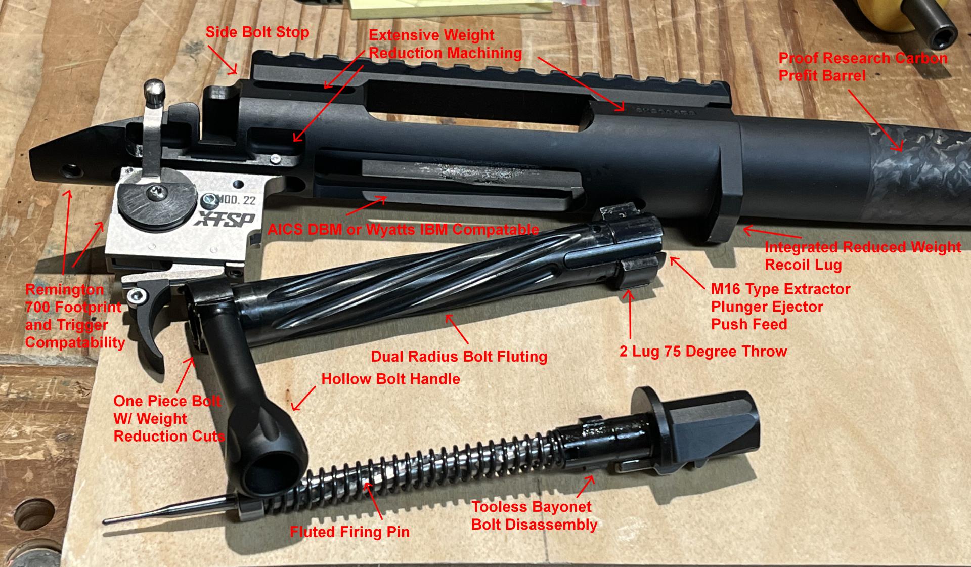

As I am sure you guessed from the name, the SKLTN is a lightweight skeletonized action. At 16oz for the titanium version and 21oz for the stainless, I believe it is actually the lightest 700 footprint action available. PurePrecision has been more creative than most to facilitate this, including hollowing out the front of the integral recoil lug, fluting the firing pin, and removing some material on the flange of the one-piece bolt. This skeletonization, combined with the integral recoil lug, has been so effective at reducing weight that the Stainless version of the SKLTN action I am looking at in this review is the same weight as the Crux Titanium I previously reviewed. As with that previous action, the SKLTN features toolless bayonet style bolt assembly and disassembly, a two-lug bolt with 75 degree throw, an M16 style extractor with plunger ejector, and a side bolt stop. Updated for the SKLTN are the overpressure relief vent hole, an integral recoil lug, and one-piece bolt design. Like the Crux, the SKTLN is a lathe turned action and can have an optics rail attached with large screws and pins or can accept Nesika Bay style rings for even lighter weight and a more hunting rifle look. The SKLTN can be used with AICS magazines or with Wyatt’s extended internal box magazines. The stainless SKLTN is made of 416 stainless and the titanium version is grade 5 TI-6AL-4V titanium. By default, the Titanium action comes with a black PVD coating for better lubricity, whereas the stainless one is uncoated. Black PVD can be added to the stainless at the customer’s request for $80. They can also have Cerakote done for less if you’re just looking for the color. The bolts for both the stainless and titanium versions have a black nitride coating. These bolts have a deep spiral fluting on the bolt that is done in two stages for both lighter weight and removal of the sharp edges that result from single-stage deep fluting. The effect is excellent:  the bolt does not scratch up the cartridge case as those with sharper deep fluting often do, but aggressive weight removal remains. In addition to stainless and titanium options, you can also choose short or long action as well as standard, magnum, or the .223 rem size bolt face I have on this example.

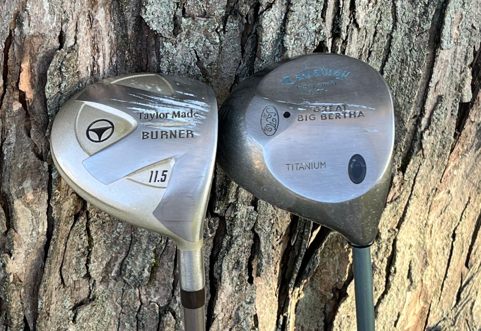

Whether it be guns, golf clubs, race cars, springs, or orthopedic implants, titanium and steel are often suggested as alternative material choices for the application involved. The strength, flexibility, corrosion resistance (in the case of stainless), and lack of toxicity can be quite similar, depending on the alloys involved, between these two elements. In the case of this action, the alloy we will be speaking of is Grade 5 Ti-6AL-4V titanium.
Comparing this alloy with the variety of steel alloys used in actions will yield a few general trends. The first and most obvious trend is that the titanium (“Ti”) is about 40% lighter per volume. It is a common misconception that titanium is also stronger. By weight this is certainly the case, but by volume, the comparable steels will be a little stronger. Both materials have good flexibility properties in that they flex and return to original size without fatigue or strain hardening over a fairly large range. This is why Ti and steel alloys are the most common spring materials in industry. The titanium flexes more easily however, and this does mean that in a Ti rifle your brass casings will flex many times more, wear quicker, and could cause harder bold lift in high pressure loads. While stainless, as its name implies, does have corrosion resistance, it has nothing on Ti, which is basically immune to corrosion at normal atmospheric temperatures even in the presence of salt. Ti can be made fairly hard at about 36 Rockwell C, but steel is commonly harder than that and this hardness, combined with less of a tendency to gall, makes steel actions feel smoother and want for less lubrication than Ti. Despite Ti's corrosion resistance, titanium actions do not run well dry.
Stainless Steel and Titanium Golf Clubs
The dominance that steel enjoys over titanium in terms of prevalence does not result from hardness and strength advantages. This dominance has far more to do with costs of the raw material and, to the greatest extent, costs and expertise to machine. In cost of raw material, titanium is somewhere around twice the cost of steel for similar quality stuff, but in terms of machining, it is often said to be about five times more costly, once slower feed speeds, greater tool wear, and various other things like the chance of its little shavings catching fire are considered.
The sum of all this comparison is that you are probably not going to use titanium for the PRS rifle which you are going to go through barrels and brass like water with, but if you are looking to make a lightweight hunting rifle, a titanium action saves 5 oz for the cost of $400 in the case of a SKLTN short action.

It is interesting to see the evolution of the thinking of the PurePrecision guys between the Crux action and this SKLTN action. The unique 75 degree bolt throw and toolless bayonet style disassembly remain, as well as the basic design choices such as being two-lug with push feed, M16 extract, plunger eject, and pinned trigger, but a number of other aspects have been updated. First off, PurePrecision has switched from a two-piece bolt to a superior one-piece design that will be more precise, more robust, and with a lower cost to manufacture. They have also switched to an integral lug on the action and ditched the beautiful (but suboptimal) hexagonal bolt fluting in favor of a more common helical style. Their choice to run a second radius on the fluting is a big win. It is far less sharp and this is noticeable in how smoothly the action runs. The SKLTN action I have here is stainless but has been Cerakoted. Like other Cerakoted actions, the bolt movement was a little sticky to start with but it is well worn in now and feels great. Also feeling good is the bolt lift which, despite being only a 75-degree throw does not feel noticeably heavier than the various 90-degree actions I have lying about. That is a big win as cocking force is a common complaint on actions with less than a 90-degree throw.
The first day of testing with the SKLTN action Proof Carbon barrel 350 legend topped with a Sightron S6 5-30x56 scope in Hawkins ultralight rings.
The biggest update on the SKLTN action is, of course, the weight relieving machining on a number of the components. PurePrecison has been quite thorough in their search for places to machine off weight. The bolt handle is hollow. The integral recoil lug has been relieved. A number of bevels and pockets have been machined all over the action body, even underneath were the trigger attaches. They slimmed down the cocking piece shroud and fluted the firing pin to go with the fluted bolt. A few tiny little pockets have even been machined on the bolt behind where the handle attaches. On the bolt alone, the machining and slimmer shroud combined are enough to drop two full ounces from 11.3 to 9.3 from the bolt present in the Crux rifle. That is an 18% weight reduction in an otherwise similar part. That is huge difference.  All of the machining on the SKLTN looks absolutely excellent. The fit and finish is top notch and it has drawn appreciative comments on nearly every trip to the range.
A few other notes from my use are that I very much appreciate the lighter ejector spring on the SKLTN relative to most other push feeds I have used. The brass from the SKLTN does not bombard the shooter in the next lane over and send you on a scavenger hunt if you want to collect it. Another simple design element on the SKLTN that has offered an outsized quality of life improvement is that there are flats machined in the action where the trigger connects. These offer purchase to keep the action from spinning when a trigger is added or removed. They are super beneficial. One note though:  if you Cerakote an action with a pin-mounted trigger, be sure to either plug the holes when you coat it or scrape off the coating after before hammering in the trigger pins. They were a bear to remove that first time. Lastly, PurePrecison has done a great job with the attachment of the optics rail. It is secured with big, honking robust machine screws as well as pins. In general, I am a fan of lathe turned actions such as this SKLTN. They are a lot cheaper than one-piece machined alternatives and offer more choice to the user in rail angle. Lathe turned actions are also much rounder and I believe this provides better average performance than one-piece actions have when used un-bedded in chassis systems or in stocks that do not require bedding. With this robust rail attachment mechanism, I believe PurePrecison has done a good job shoring up the largest potential downside of this construction.

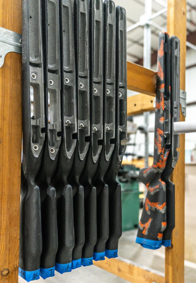

PurePrecision Altitude stocks mid-process
The particular model I have here is the Remington / Clone Adjustable Altitude. In most respect its geometry is very traditional for an American hunting rifle. Its departures from that size and shape are a slightly widened forend to accommodate larger barrel diameters, a more vertical grip angle, and an adjustable comb. This adjustable comb has a pretty large 1.25” or so of vertical range and is adjustable for more than just height as well. The comb can be moved right or left around .25” each way or angled in the horizontal plane using the same mechanism. This adjustability is not immediately obvious, as it is done by loosening the vertical rods using the hex heads you may be surprised to find they have on their bottom. It’s a pretty clever mechanism. The same size hex key is also used to raise or lower the comb. No thumb wheel toolless alternative fastener is included. The finish of the Altitude stock is a nice looking sponge camo paint job over some sort of matte undercoating that provides a bit more grip when wet than shiny bare resin. The stock also has molded-in texturing on both the grip and forearm. All in all, it’s a nice comfortable stock and it’s priced at the entry point for a traditional hand lay up composite stock.

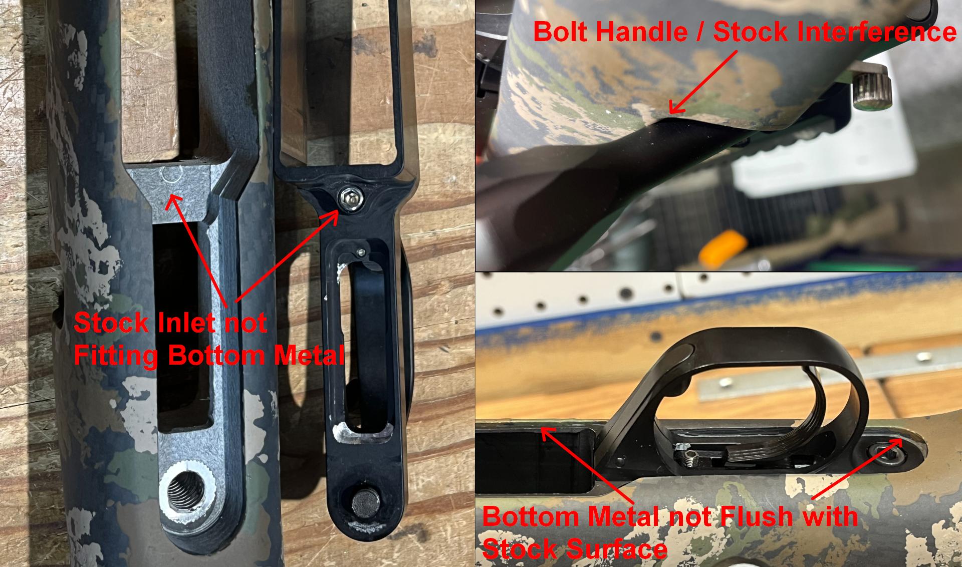

Instead of building and bedding the rifle myself, I had PurePrecision do this. Unfortunately, the bedding and bottom metal fitment were not great. They were not done to the standard of the bedding job PurePrecision did on the Crux a few years ago. The bedding job on the Crux extended an inch or so under the barrel and was continuous to the tang. The fit of the barreled action and bottom metal as well as the bedding job were perfect. Exactly what you would expect from a custom rifle builder. The SKLTN rifle uses a two point bedding technique with tape creating space between the barrel and the bedding compound forward of the lug. There is nothing wrong with this bedding technique vs. the continuous one used on the Crux. Different philosophies exist on this point and competitions are won with both. I’m just noting the change here. What is incorrect is that there was bolt handle / stock interference such that the bolt handle came to rest on the stock instead of the notch in the action where it was supposed to rest. The bottom metal was also impacting the stock fill at a central point, causing it to deflect and for stress to be added to the system as the action screws were tightened. The barrel is very slightly angled left in the barrel channel. This is purely cosmetic, the barrel is still properly free-floated and the angle is slight enough it might go unnoticed by many, but I did notice it. Lastly, the back of the bottom metal is sitting about 1/16th of an inch below stock surface, causing the lip on the Hawkins hunter magazine to impact the stock and not fully seat. This is not an acceptable fitment and bedding job to be leaving a custom rifle builder, and training and QC needs to be improved to prevent this. This is always a difficult point as a custom shop expands beyond its founders and new employees come on board.
Problems with PurePrecision’s Bedding and Bottom Metal Fitment on this Build

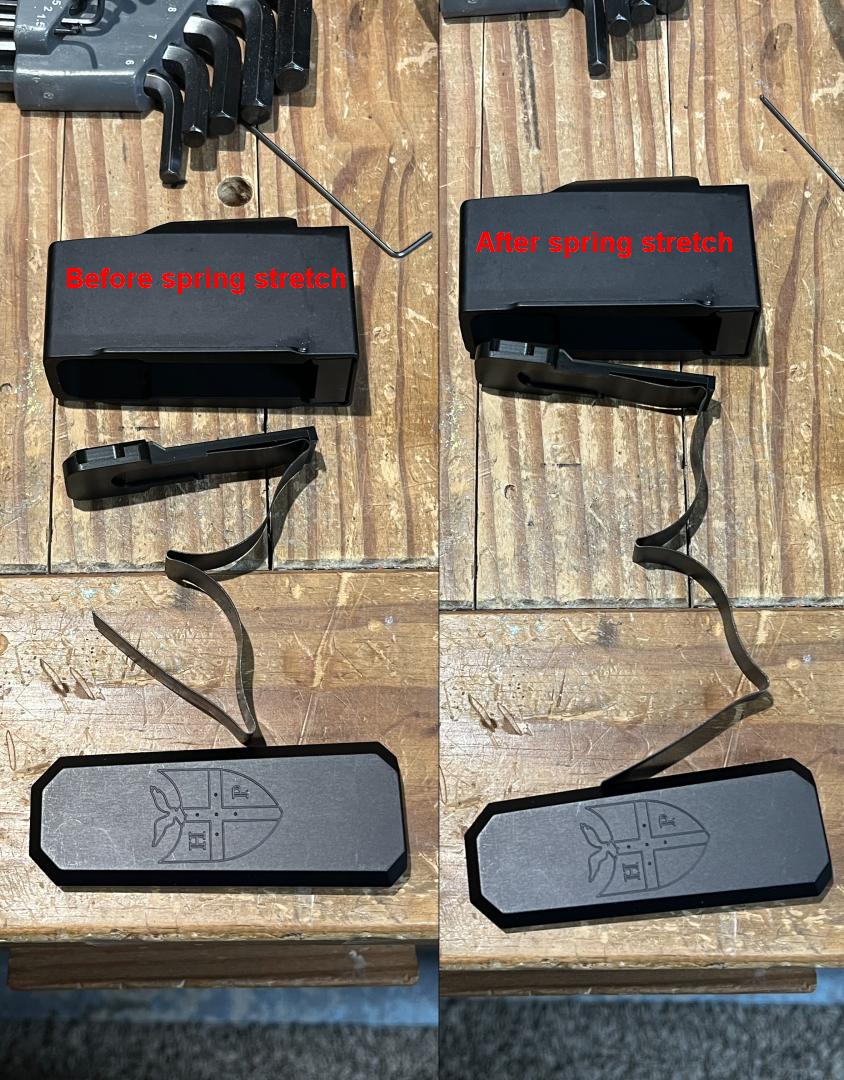

Update 1-14-2025
Nick from Hawkins had an idea to improve the feeding reliability on the Hawkins .223 mag when using it on 350L. On some of their latest spring shipments, the springs have exhibited more closed geometry than in the past. This has lead to nose diving issues such as I experienced. They are now remedying this by stretching the more closed springs such that the top and bottom leafs are parallel to each other. My example had predated this change. I have now done this myself though I may have overstretched mine a bit. The magazine now feeds reliably with a variety of ammo though so problem solved.
Spring stretch remedy for nose down 350L misfeeds in the Hawkins Hunter .223 magazine

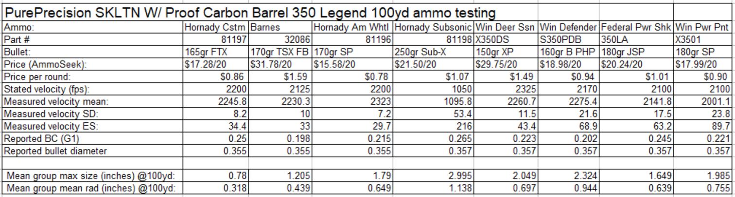

Accuracy Testing

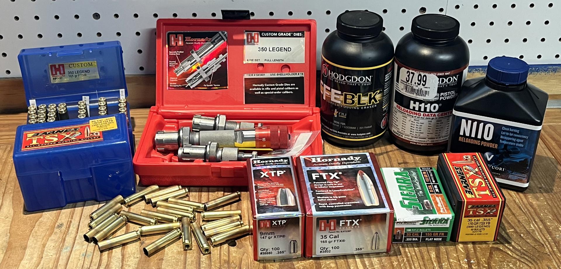

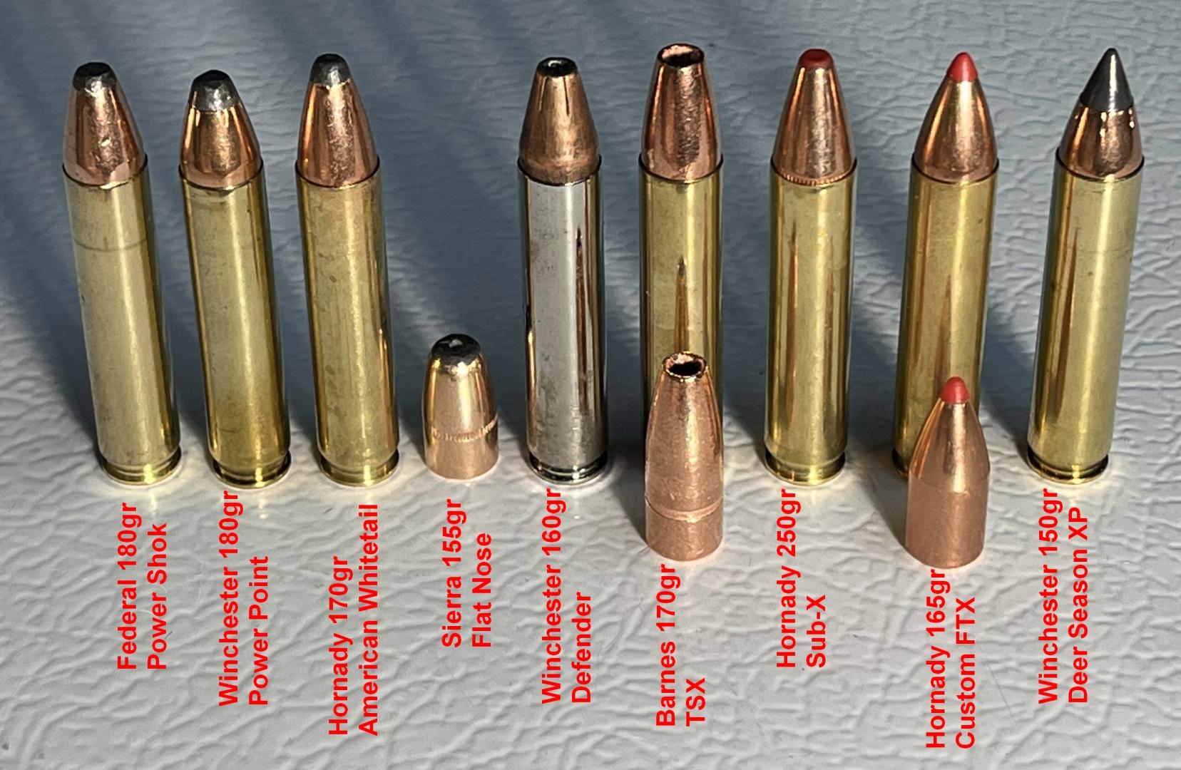

All eight factory ammunition offerings that were fully tested in the Proof barreled PurePrecision 350 Legend rifle as well as the bullets that were handloaded.
As you can see from the above comparison photo, I have tested quite a number of different factory ammo offerings in this 350 Legend rifle. Additionally, I have done handload testing with four different bullets and three powders. That is a lot of testing. It’s quite a bit more than I did for either the Kelbly Atlas or PurePrecision Crux reviews in past years. Both of those rifles shot quite well with much, or most, of the ammo tested and took little work to find high performing handloads as well. There were also no complicating factors along the way. With this 350L, there were some previously mentioned bedding issues. There was also a bad lot of Hornady Black ammo that showed large velocity fluctuations and was recalled and then discontinued. I may even have a scope issue with one of the scopes I was using. I have not yet had time to fully test and verify this, so I will not be giving any details at this time about that. Without question, the biggest issue is that most factory ammo as well as most handloads just don’t shoot anywhere near the potential of the rifle system though. I have a pile of targets more than an inch tall here to attest to that. Some of these predate figuring out all the rifle’s complications and, boy are they sporty, but about half of the targets made after getting the rifle squared away are still 2+ inch groups. This even includes some handload targets, though the majority of those are between 1” and 2”. All that being said, the rifle can shoot. It’s average five shot group with the better lot of the two lots of Hornady Custom 165gr I have comes out to just over .75” with an average mean radius of .318”. This is right in line with what I had hoped to be able to get from a custom grade 350 Legend and shows the rifle is quite capable.
Handloading Supplies for the 350 Legend.
As I will soon be doing an entire article on accuracy in the 350L as well as handloading for it, I don’t want to write you a multi-page summary of each ammunition here or go into detail on what factors I think commonly cause performance to be much lower than the rifle is capable of. I’m also only about halfway through the handloading work at this time and only now that I have switched to Vihtavuori N-110 powder am I having somewhat more success.
Factory Ammo Test Data for the PurePrecison SKLTN 350L Rifle with Proof Carbon Barrel.
For now, I will say that at this point in the resurgence of straight-walled cartridges, there are issues both with the quality of ammo being produced and with the ability of even quality ammo to perform across a wide variety of user rifles. The 350L cartridge itself also has some design aspects that are suboptimal for accuracy, such as a super long jump to the lands and a long, thin powder column. However, performance can be had and this PurePrecison SKLTN action / Proof Carbon barrel rifle is an excellent platform to figure that out on.

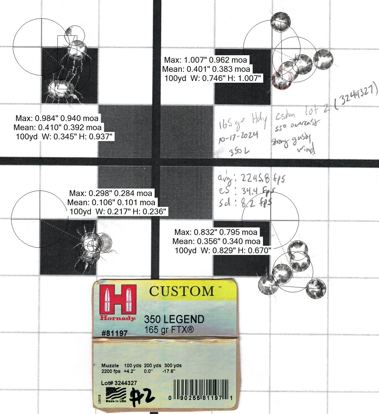

Hornady Custom 165gr Ammo Testing in the PurePrecison SKLTN 350L with Proof Carbon Barrel.

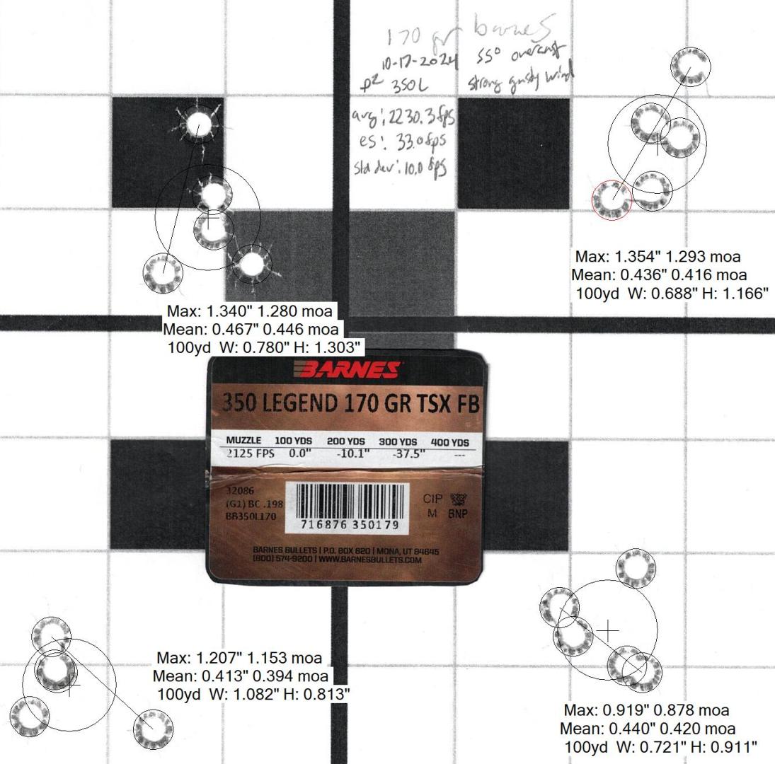

Barnes 170gr TSX Ammo Testing in the PurePrecision SKLTN 350L with Proof Carbon Barrel.

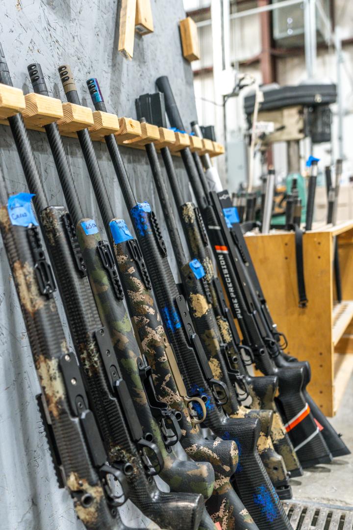

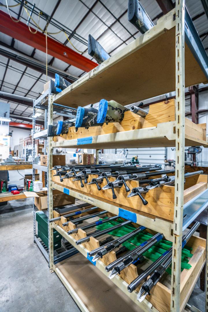

PurePrecison rifle builds ready to ship out
Since I last took a look at one of their products, PurePrecison has expanded rather dramatically. Clearly, the partnership with a machine shop to bring action manufacture in-house is paying dividends in the design, quality of manufacture, and pricing of the SKLTN. It certainly strikes me as a winner. Judging by the bedding and communication issues I had with the Altitude stock, there are probably still a few loose ends to sort out in adding the large Battalion retail operation. Hopefully they already have that squared away as it has been a number of months since the SKLTN rifle arrived at my local FFL.
