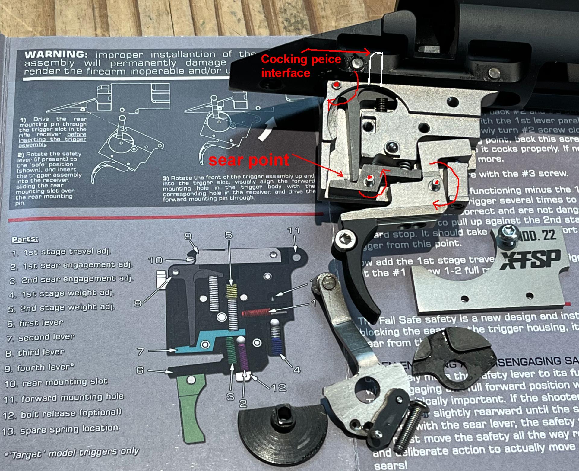

XTSP manufactures the Mod 22 trigger in a lot of different configurations. This includes not just different safety configurations and different trigger shoes, but also the substantial difference of a 3 lever tactical and 4 lever target variance. Pretty much all of these features can be mixed and matched. For instance, bolt stops can be added to either variant for those using the Mod 22 on a factory 700 that lacks the now ubiquitous side bolt stop of the clones. Adjustable trigger shoes can also be added to either Mod 22 variant. The example I have is the 3 lever tactical configuration but with the adjustable shoe more commonly found on the 4 lever target variant. This adjustable shoe utilizes the same dovetail as the Accuracy International triggers. XTSP switched to this configuration from the round Anschutz trigger shoe attachment previously used when they started making the AXSR trigger for AI, as they found the design more robust.
Looking more closely at the 3 and 4 lever Mod 22 variants, the image below includes the printed diagram of the 4 lever variant below the 3 lever variant being tested here with its side panel off and safety removed so that you can see its inner workings. As the top of lever three in the 3 lever variant is obscured both by the trigger housing and the rifle action, I have traced in white what that part of the lever looks like. You can therefore see that in the 3 lever variant, that third lever contains the topsear part and that the topsear in this configuration falls forward when firing. With the 4 lever variant, the topsear is on lever 4  and falls downward when firing. In practice, the difference between the two designs is that the 4 lever variant will have a somewhat lighter second stage trigger minium pull weight because much of the force of the cocking piece on the topsear is being born by the front pin on that fourth lever resulting in much substantially less force, and therefore less friction, at the sear point. This will not be a huge difference, however, as the pull weight springs do not differ between the designs, and the vast majority of the geometry is also shared. The product literature lists the pull weight range of both models as from 10oz to 3.5lbs.
In my testing, I was able to get the 3 lever variant as low as 1.76oz on the first stage (with the light spring) and 6.17oz on the second stage for a total minimum pull weight of ~8 oz. Maximum pull weight exceeds my gauges and is listed as ~3.5lbs in the literature. As you get low in weights though, you must be careful. It is possible to screw out the weight adjustment screws too far, such that they are no longer under any compression and the trigger no longer functions properly. It can be unsafe and erratic in this state. For instance, in the case of the second stage weight adjustment screw being set too loose, the trigger will not reliably reset to full sear engagement after firing and may have either partial sear engagement or not reset at all. For those looking to adjust for the lightest pull, the XTSP trigger is unique in that its side panel can be removed with the trigger installed allowing you to see the springs directly. If you are going to do this, remove the bolt from the rifle first, as you do not want force from the firing pin spring on the trigger components with the side of the case off, as you may bend pivot pins if you do so. On another note, you do not need to remove the safety when you take the case side off in order to see the adjustment weight springs. The case side and safety mechanism remove completely independently of each other. Each are attached with a single fastener and there is little reason to remove the safety at any point as you can visually adjust the trigger or thoroughly clean it with just the case side removed. With the case side off, you can see the stage weight springs as you adjust them, allowing you to adjust them the minimum amount necessary for contact with the corresponding internal parts they must be in contact with for proper function. Be sure to test the function thoroughly after replacing the case side as those pins shift a little when the side is put on and the springs need full engagement for safe function. I will add here that being able to remove the side of the trigger case with the trigger still installed in the rifle is an excellent feature I have not encountered in competitors’ designs, as it allows for cleaning without the onerous task of pounding out the pins attaching the trigger to the action. Incidentally, on installation or removal, only the front trigger pin is pounded out or in on the XTSP trigger. The rear pin is left in the rifle and the trigger simply hooks around that pin and rotates into place.
As I experimented with different weights, I found the XTSP Mod 22 gives you a lot of pull weight adjustment in both the first and second stage. This is not a big spring, little spring type arrangement where you really only get substantial pull weight adjustment on one of the two stages. On this trigger, you have similar adjustability on both of the stages.
Regarding the XTSP trigger’s safety. It appears unique in that the entire safety mechanism removes with the lever. It functions by essentially hooking the bottom arm of lever 3 when engaged and pulling forward so that the sear is no longer engaged. As with other 700 safeties, it cannot be engaged with the rifle not cocked.
I will mention here that the XTSP trigger comes with a second spring option for the first stage pull weight. In the case of my example, the trigger came with the light spring installed and the heavier one in the Ziploc bag. There is some overlap in ranges between the two, but it looks like you will probably go with the light one up to about 10z and the heavier for anything above that. In the past, the XTSP trigger had a hidden compartment for storing the spare spring under the case cover, but that appears to have been dropped at some point. In addition to that second spring, the XTSP Mod 22 trigger comes with the very informative three-panel instruction card containing the labeled diagram of the trigger internals I pictured, as well as two hex wrenches for adjustments.

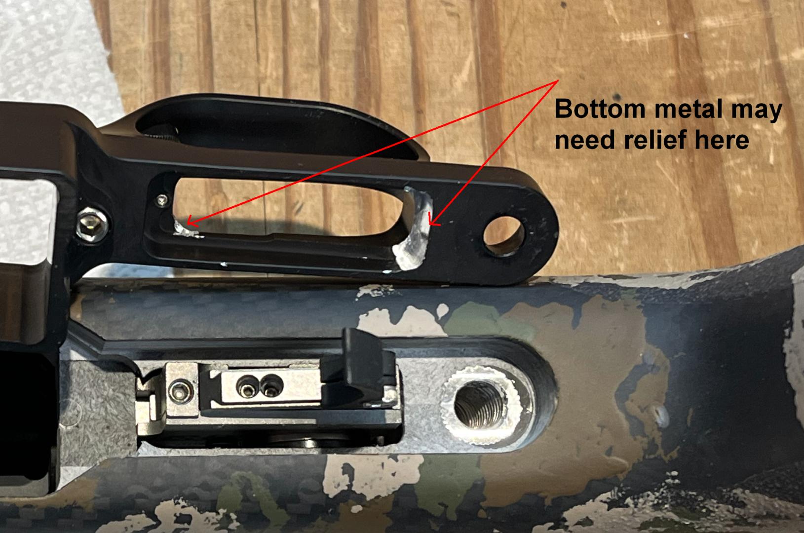

The most likely fitment point you will find with the XTSP trigger is that, like many aftermarket triggers, it is slightly longer and slightly wider than a stock 700 trigger. You will likely have to remove some material from your bottom metal and perhaps open up your stock inlet a little to accommodate the larger size. In the below image you will see I had to remove a little material in two places from the Hawkins Hunter bottom metal for the trigger to fit. I did this with a Dremel high speed cutter bit. I was careful and so the resulting alteration is not visible on the assembled rifle. Some fitment in this regard is very likely necessary for those using a stock and bottom metal, as all of the different bottom metal I had on hand from a variety of different makers requires such modification to fit. I believe modification is probably less likely for fit on a chassis system, as the one I had on hand had room to spare.
Modification of the Hawkins Hunter DBM Bottom Metal to Accommodate the XTSP Mod 22 Trigger.

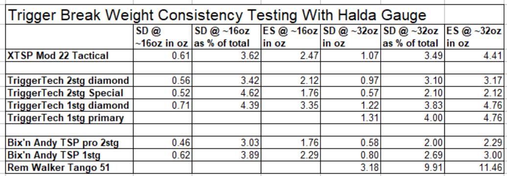

A few trigger reviews ago, I picked up a used Halda force gauge for testing consistency in pull weights. You would not believe how inexpensive you can get a really good used force gauge. I would recommend this to my fellow shooters over one of the low quality gun brand options - if I thought there was really any reason for most shooters to have a trigger pull gauge. I certainly never did until I needed quantitative data for doing reviews. The range on my Halda is ~3.5oz to ~35oz with a little leeway to estimate on either end of the range as it is analog. To test consistency, each trigger was therefore set at ~16oz and ~32oz when possible. For the two-stages, pull weights between the stages are set as close to equal as possible at each test weight. The XTSP Mod 22 tactical, and TriggerTechs were capable of being set equal at both pull weights, but the Bix only goes up to about 8oz on the second stage, so that was the setting for both its tests. Twenty pulls are done with each trigger at each weight and extreme spread and standard deviation are calculated from the resulting data. Consistency testing is always done in the Kelbly Atlas action for consistency and because that action has a trigger hanger allowing for easy trigger swaps without violent pounding. All of these triggers were run without lubrication.
Performing the pull Weight Testing on the XTSP Mod 22 Tactical Trigger in the Kelbly Atlas Tactical Action with the Halda Force Gauge
The break weight consistency of the XTSP Mod 22 Tactical was where I would expect it to be, in close company with its high-end aftermarket competitors and far more consistent that the professionally tuned Remington walker trigger. The XTSP did not have the lowest variance amongst the premium aftermarket triggers, nor did it have the most. In practice, all of these aftermarket options are consistent enough that the user will not note differences in break weight from shot to shot.
Results of the Trigger Pull Break Weight Consistency Testing with the Halda Force Gauge
One important note on the XTSP following testing is that, in the process of testing, I moved the adjustment screws in and out enough to strip the polymer anti-vibration component from them. The result was that the adjustment screws, particularly the one on the second stage pull weight, became loose enough to back out over time. The fix for this is to re-apply a polymer anti-vibration product to the threads of those screws. Vibra-tite VC-3 is the appropriate product for this. Do not use an anaerobic thread locker such as Loctite for this, as these products form a hard and non-adjustable bond. You are looking for an elastic adjustable bond. If you regularly readjust your trigger pull weight for different situations such as hunting vs. competition, expect to periodically reapply an anti-vibration product when those adjustment screws start to feel loose as you adjust them.
This brings us to safety testing. I tested the XTSP Mod 22 Tactical for slam fires as well as drop safety in a variety of states in several different actions. I was not able to induce a slam fire with the safety on or off. I was also not able to induce a discharge by dropping the rifle on its butt with the safety on. However, it is easy to induce a discharge by dropping the rifle on its butt with the safety off. This is not just true at minimum pull weights but even with substantially more pull weight. Being not drop safe with the safety off is not uncommon for triggers in general, and is especially common for target triggers. Still, the XTSP is easier to set off than others I have tested and I have encountered triggers that did not go off even at minimum pull weight.
