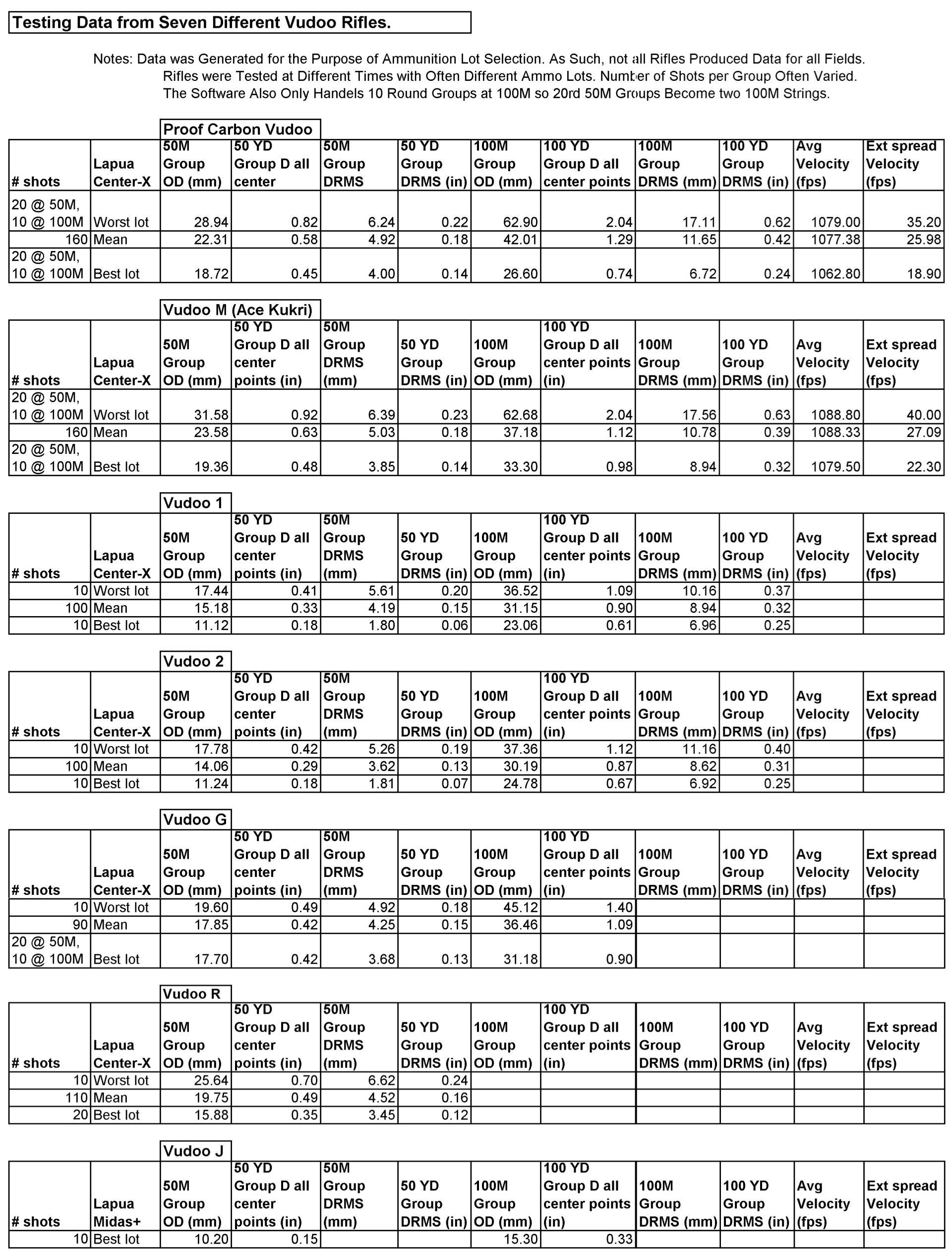

The Compiled Test Data from Seven Different Vudoo Rifles
Those are some pretty impressive numbers aren't they? The one thing I did find maddening in the data was the 10 shot rifles. Specifically, Vudoos 1 and 2. Predictably, these posted significantly smaller group sizes and DRMS numbers than the others, but these furthermore posted groups smaller than any of the individual 10 round groups from the other rifles whose groups were combined to make the 20rd groups. I find this maddening because I do not have enough data to know if these rifles were a bit better than the other Vudoos, if they got some better lots, if they just got a lucky small sample size, or if it is a bit of all three. To support the lot hypothesis, I have data from some other high-end benchrest and 3-position guns fired with those lots and their performance was similar. On the other side of the argument, Vudoo G fired the same lots as 1 and 2 but did not have the same level of success. Further complicating things, Vudoo G was also tested with Midas+ and did have groups in that range with the Midas+. The Proof Vudoo, M and R all had entirely different lots, with the Proof and M sharing lots and R having lots all to itself. In any case, I don't think it enough data to conjecture whether Vudoos 1 and 2 just shot lucky groups, lucky lots, or are particularly exceptional examples. In any case, I think the data collected is more than enough to give a darn good idea of what to expect from a Vudoo rifle. Every one of the rifles tested was less than .5" @ 50yds even with 20 rd groups.

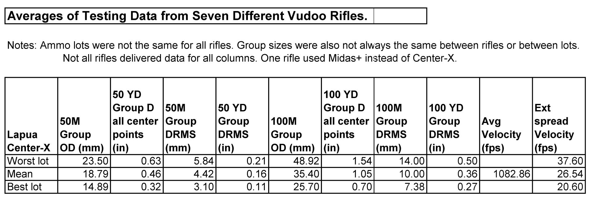

Averages of the Testing Data from Seven Different Vudoo Rifles
What I have shown in this table is to help you see the range of performance to expect from a Vudoo rifle paired with the Lapua Center-X it was most designed for. If you go though the lot selection process yourself or at a test center, you should expect to find a lot that gives you a DRMS @ 50 yds in the range of .11". The worst any rifle did on this was .14". I expect that using the conventional 5 shot groups with extents measurement, you would probably average significantly better than .5" groups at 50yds. Probably, quite close to .25". At 100yds, the average DRMS was .27" with the worst rifle at .32". I expect this will come out around .75" average 5 shot group sizes,  which is pretty amazing given that true sub-MOA .22lr's are a rare thing.
I hope that the above data is also convinces the reader of the value of ammo lot selection as the expected improvement for going through the lot selection process is not only large, but also a bit better than the expected improvement from stepping up in grade from Center-X to Midas+ or X-act. However, if you do decide to lot test Midas+ or X-act along with Center-X, more than likely your best performance will be with a lot of the higher cost fodder. The relatively little data I have from folks that tested Midas+ as well as Center-X suggests that the difference can be quite substantial and that in many cases, all of the Center-X lots available are significantly limiting the Vudoo's performance. It is important to understand that Midas+ and X-act start off their lives in the same production line as Center-X. Lapua tests its production lots and the best end up as those higher cost products. The same is true for Eley with Ten-X and Match. I suspect that Lapua does the same thing as Eley when too many lots to sell as the higher grade product test to that level:  some of the higher grade are just marked as lower and so we all hunt for them.

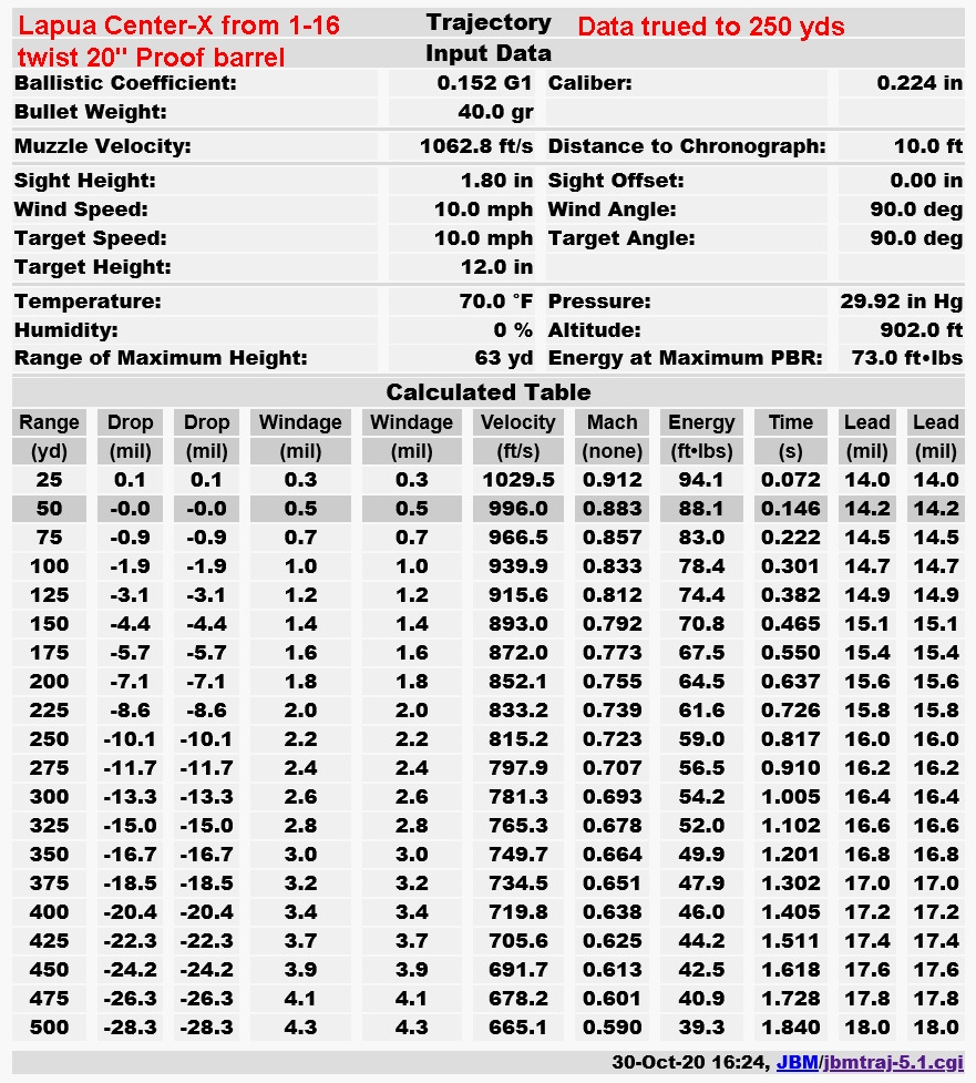

Dope card for the 20" Proof Barreled Vudoo V-22 with it's selected lot of Lapua Center-X
