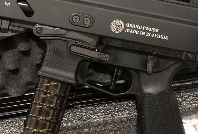

Stribog A3 is finally finished. ACR/Tailhook brace is great. Can't wait to run it at the range.

10/22/2020 12:17:29 PM EDT
It’s a beauty!
Those who beat swords into plowshares usually end up plowing for those who don't. --Benjamin Franklin.
10/22/2020 12:28:15 PM EDT
Thats purty.
The ACR stock has been a far greater success by itself than the ACR ever was.

Hey everyone, long time lurker here. I just picked up a new SP9A1 yesterday from a dealer off of gunbroker.com. One thing I'm noticing is that I have a flat trigger and not the curved one that basically everyone else has. Is this new for the next batch of Stribogs? I tried to call Global Ordinance a few times, goes to VM. I'm trying to figure out the whole posting picture thing so I can show you guys. Anyone have any details on this? Thanks.

[Last Edit: BigC6Mike][Edited] [#46]
Originally Posted By ak_guy:
Does anybody know whats up with the new trigger GO is shipping with the Stribog SP9-A1 Gen2? I cannot seem to find any documentation on it.  I very much like it, reminds me of a nice single stage.
I'm just seeing this post after I posted my inquiry. Glad to see that I wasn't the only one. I haven't put any rounds through it yet but it does feel very crisp in my opinion.
https://i.ibb.co/JzjdNJD/Flat-Trigger.jpg
Just saw this trigger for the first time on FB the other day.  At first I thought it was an aftermarket trigger.
