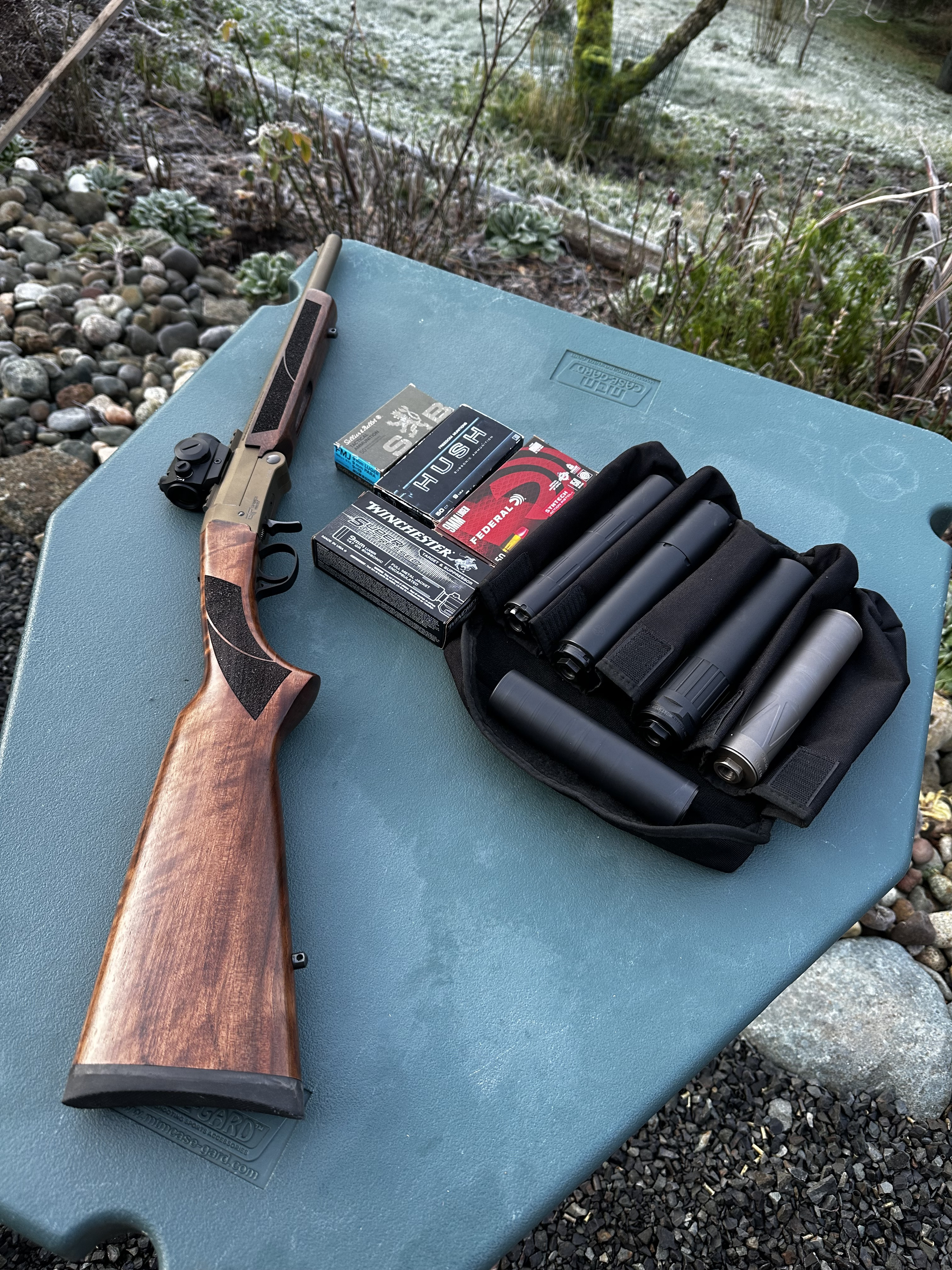

I would love for Ruger to come out with a bolt action 9mm rifle.  For now I’m pretty happy with my GForce 9mm break action rifle.
