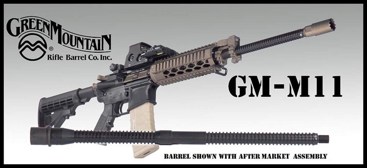

    Are the now out of production Green Mountain finned AR15 barrels okay for a Lima Six build?
    9/4/2026 3:05:06 PM EDT
    https://www.filepicker.io/api/file/xBxgVvC9SeiCSQwiob9t
    Honestly that looks pretty skinny.
    An optimal barrel has both mass and surface area. That one looks like maximum surface area but its still low mass.
    https://www.limasix.com
