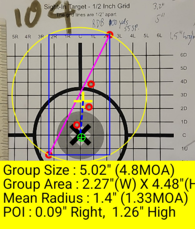

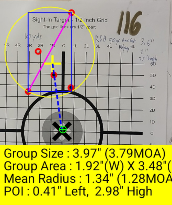

Originally Posted By lazyengineer: 12/30/2023 Update : 250 rounds fired (275 total). A few jams while experimenting with gas adjustments - other wise no jams (er.. no jams with the RDB that is - read on). Per the above photo, I brought out the RDB, the AUG a Chrony, And about 20+ different magazines preloaded with different ammo between the two guns. Todays outing focus was mostly on 100 yard paper with some targets at 50 and 200 yards. After spending a few minutes setting steel and about 50 paper targets for the day at the different distances, I then went back and unloaded at set up at the bench on this cool but pleasant sunny 50 degree day. First order of business is to figure out if I'm going to stick with the ACOG or not, and I brought a spare Primary Arms 2.5 CQB just in case. All my other guns run the 2.5 CQB as my standardized glass, so going different with ACOG is kind of mixed emotions, that and I still think 4X is a lot of X for a gun that might be CQB usage too... Donno. For now I'm running the ACOG, but did switch to the smaller and less rail-space consuming PA mount that comes with their 2.5 scope (that works on ACOGs). But if this is going to work, I have to zero that ACOG. So at 50 yards, it was impacting in the dirt at the base, like 3+ feet or so below point of aim. I finally said F'it, and lightly used a multi-tool to see if I can twist the stiff dials (but careful like). they quickly loosened up, and to my suprise, had enough clicks that I was able to travers that sucker all the way up to impact. I then went out to 200 yards, and zeroed it with my 55 ball, which is my reference distance and round I zero essentially all my 5.56 guns on. Accuracy was... ehh... well, still warming up and figuring out the scope at this point. Over the course of the day, I fired mostly at 100 yards, and some at 200. I'm still compiling my data and performance activity, but did find a few trends of note. 1) The RDB is easily as accurate as my AUG. But it still wasn't very accurate. 2) The RDB is a much more pleasant gun to fire, than my AUG. 3) The only magazine that had issues with my RDB, was a GI C-Products aluminum mag, where that sucker just did not want to securely latch in. All other mags (Lancer, GI 20s, PMag, ETS mags - all ran great). 4) There were no accidental mag releases. Even in handling and things getting bumped, there were no accidental mag releases. But most of this was bench shooting today. 5) The new Garmin GPS is completely F'ing Awesome - and I'm so glad I dumped by LabRadar to help pay for it. 6) The ACOG green illuminated reticle is awesome, but in some settings kind of hard to see that green. Though the ACOG glass is ridiculously good quality. That is some amazingly sharp clear glass. While I like my PA 2.5X, this glass is better. 7) When shooting from a bench with a side-cutout for your chair - placing a box on the ground below the gun a tidy way to get all of your brass collected nice and easy. 8) If I could only have one bullpup in 5.56; which would I pick. man, I have to say, as iconic as the AUG is and as much as I like it, I'm going to have say, that RDB was basically better than the AUG in every category - and in particular in just how pleasant it was to shoot and the overall user experience. I will say, I watched a few of the recent Guntube "Influecner" video's of late that came out in the last few months with tacti-bro's running several bullpups at once, and in all of them, they all picked the RDB as the best one. I kind of see why. 9) the 17" RDB barrel was equal or greater velocity than the AUG 18" Barrel. I suspect this is to do with the HUGE gas port venting out the side of the AUG; because at Steyr, it's better to run way too much gas to the gas system, and vent what you don't need; than it is to just constrict how much gas you vent, to just what you need. (I once layed a business card across that vent port for grins in my AUG, and it shredded that thing into confetti) Where RDB basically uses all the gas it takes, and vents very little to waste and lost velocity. it's also drawn much further down the barrel, where port pressure is lower. I doubt many will study this, as that's quite a data dump. https://i.postimg.cc/hvYZDjMC/image.png In general, neither gun shoots very well, with 3 MOA being a good group, with some ammo and on some strings. It appears to do better with lighter ammo, and for whatever reason both guns really like that 55 gr HPBT. Historically the Hornady 55FMJ Ball lot will shoot 1 MOA in a National Match AR, so that bullet CAN shoot. And it does good in other AR's, but only decent here in the bullpups. The 50 gr JHP round also went well. The national match competition 77 gr Lapua load, did mediocre in the RDB, even with the reduced gas setting. In general, -1 (almost full open), was needed for much of the ammo, and the hotter heavier ammo was able to throttle back a little bit, to -3. You can sort of feel when the gas might be able to be throttled as you shoot - or maybe that's in my head. Here's a photo of a casing out of the RDB. Note how it has striations markings on there - almost like it's fluted. I don't think it is fluted, but it's interesting. https://i.postimg.cc/nrWcY4cn/20231229-143440.jpg For failures, the AUG had one broke shell, though no broken shells from the same lot of ammo in the RDB. this has to do with AUG's sloppy chamber. this isn't common or frequent, but it has happened before. https://i.postimg.cc/5yXpRJ18/20231229-154543.jpg Brought the RDB home and pulled it apart. very little wear or fouling to show for it. Maybe a slight wear on the gas piston. Total round count: 275 rounds on the gun. View Quote Have you tried the PA 2X? It’s the optic I eventually plan on putting on mine. Thought I read somewhere the 2.5 was going to be discontinued soon but couldn’t find the info. It’s hard to explain but magnified optics just feel weird on it. I tried a LPVO and a PA 3X Microprism but struggled on follow up shot speed. I can throw the muzzle around easier but I think my stability off hand is reduced with the bullpup. Something about it is just awkward trying to be accurate. |

The accuracy with the 55gr is impressive for the RDB..I would have figured it would not like those (accuracy wise) being 1/7. My 1/9 Rdb (basically a preproduction) also does well with the 50(ish)gr projectiles. There is another thread kinda like this where a guy (Potts for the Bullpup Forum) tried alot of different ammo and it was reposted on KTOG ..Best ammo with groups under 2" No Targets.. RDB Accuracy Thread |

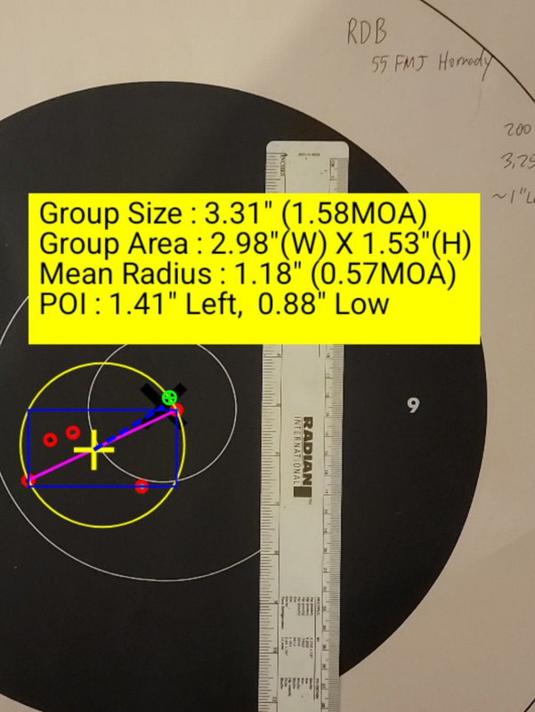

Originally Posted By mcantu: This is ADI 69gr SMK https://live.staticflickr.com/65535/49543021116_4f6f386877_o.jpg View Quote View All Quotes View All Quotes Originally Posted By mcantu: Originally Posted By lazyengineer: Originally Posted By mcantu: Originally Posted By lazyengineer: Holy crap - I would drink with this guy. That is some AWESOME work he did, and excellent testing and communication. I'm blown away. Totally upstaged on everything I'm trying to do here - just awesome thread! most every idea I had rattling around in my head, he had too - and he broke out a welding machine and tested it. I also find his AUG performance data in that thread refreshing as well. Lots of people keep saying AUG's are 1 MOA capable guns. Mine's not. Not even close. I can shoot 10 targets and cherry pick one that might be close with just the right tuned ammo - maybe. But his performance is pretty close to my own - in general, the AUG is a 3 MOA gun. How can it not be, look how many contact points are on that thing - it's ridiculous, combined with short-stroke piston, and tolerances to fit it all. And a chamber and throat that takes toxic-masculine vulgarity words to describe how oversized they are. Maybe some people have amazingly tight tolerance machined parts of all the many many contact points on that removable barrel and have found just the right ammo; but his honest AUG accuracy post I believe. But.. wow, after every clever Idea thought I had - that he implemented with a welder and parts - NOTHING materially improved the RDB's accuracy. That's a heartbreaker. https://www.ar15.com/forums/General/View-of-an-AUG-1-5X-Donut-of-Death/5-2609646/ Envy. My CHF CL A3M1 can't do that. My friends CHF CL A3M1 can't do that. My other friends malonited A3M1 can't do that. Sigh. This is ADI 69gr SMK https://live.staticflickr.com/65535/49543021116_4f6f386877_o.jpg Oh I've run 69 SMK's, and everything else imaginable. Maybe the original AUG's could do that; though I have no idea how with that many contact points on the barrel, but the current A3M1's sure can't do that. |

Originally Posted By lazyengineer: 1/1/2024 update (will probably break into multiple parts) Part 1 - bench testing again (Part 2 will be the action shooting): 265 rounds fired..... View Quote Continuing this update from this day - Part 2 is the action bay shooting. " /> Took over a 50 yard bay with side-walls, where you can run and gun and shoot sideways at targets on the sideberms. Ran up and down the bay with both rifles doing similar course of fire. Had issues with my timer, so no timed run data to show. Just some summary items. Recoil control and Run and Gun: the RDB recoil is... different. It's a very mild and pleasant recoil at the bench. Compared to the AUG which is jumpy and unpleasant, and the M4 is somewhere between. Afoot though, it was ... different. My experience is biased by running 4X, which is quite a bit of X for CQB at 5-10 yard running shots. The RDB recoil is more of a long drawn out push. It's not a snap recoil with instant snap back into position, but a long dragging slow push, and long dragging slow return. "long" being a relative term. But it made doing double snap shots harder, in my opinion, than an M4. Where a long drawn movement moves the scope off target, and then long drawn closing moves the scope of target, and is harder and more involved to compensate for, to keep the gun on target for the next shot. Where the AR is snap, and just moves very little, and is back on target when it's done. Interestingly, the AUG, which I hate at the bench, is an excellent gun afoot, as its recoil while standing is an instant snap, and back on target, and not all unpleasant while standing and your whole body is in play, It's actually quite good in run and gun. And so is the M4. The RDB was.. different. That said, it did decent. In comparison, run and gun with my ultralight patrol spec M4 and the nice LaRue 2 stage trigger, and the good CQB fixed 2.5X Quala of Death Primary Arms scope; kind of was just better, than the RDB. I will say, shooting paper at 100 yards, the 4X was certainly better than the 2.5X, especially on finer targets, but the 2.5X still worked fine. Sighting - Aside: the neighboring group had a guy with an M4 with a 35° offset red dot; which he let me try. That was going to be my concept for CQB with the RDB while having the 4X ACOG. TBH, I didn't really enjoy it, didn't find it any faster, and didn't find it helped my target aquisition much. That said, he ran his in front of the scope (far away), with a tiny RDS (smaller than even typical), and it was partially obstructed by the handles of his scope - so maybe not an ideal run. Between the above two experiences though, I have decide I'm going to pull the ACOG and mount my spare backup 2.5X CQB instead. the gun's not accurate enough to realize benefit from more magnification anyway, and it really wasn't a great CQB experience with 4X of power; and my plan of running 45 degree is ... on pause. Heat: At first, teh RDB didn't really get that hot, but when I did a couple of 30 round magdumps afoot, that sucker got HOT. The plastic handguard was not well engineered for hot usage, and even the plastic got quite hot. I suspect the metal screws that KelTec uses (bleh) to hold it together, were part of the problem. I was still able to adjust the gas by hand, if I wanted (I found the the hot 62 gr had a good bit more recoil, and so cut back their gas a couple more clicks). The gun was still usable, but it was definately hot. I did a zero-test of heat before/after. results were odd. The skinny M4 had zero POI shift at 100 yards, even after cooking it. But the RDB started at 50 yards already 1.5" low, and when hot, was better zeroed. so it may have moved 1.5" or there could have been some other wierdness where the initial zero test wasn't representational. Reliability neither gun jammed. But the RDB had some wierd and kind of serious issues with the bolt lock. Where the bolt-lock itself, just LOCKED. And no amount of strength could depress the release lever. I had to pull the charging handle, but where the handle engaged the locked bolt at about that spot on the through, it was STIFF and took a good bit of force to force back the bolt that last 1/2" to release the bolt lock part, to then allow going back forward. I suspect the lock-mechansim is getting stuck somehow, and this hasn't gotten better with time, it's getting worse. I don't know what's up, or if this is a THING with Kel-Tec RDB's, but it's kind of not OK. Next cycle it'll be totally fine, so it's random; which in some ways is even worse. Running a couple mag dumps, and the front end of the gun is just SMOKING as various greases and oils are now cooking. This is typical of running a gun hot, and was expected - and no problem of itself, so much as an indicator that yes, this gun got run hot. IMHO, every gun needs to be run to this point early on, to find out what's loose or going to break. And so what got loose on the RDB. Of all things, the buttstock plate. those screws came loose and it's wobbling now. No worries, I'll just tighten that back up. There were no inadvertent field engaged mag drops. Though it hates one of my GI mags and won't lock it in. It loves ETS and Lancer and PMag and GI20's just fine. Conclusions and plans and to-do: -Will tighten up buttplate and check some of the other screws. -Will tear-down and fully clean RDB - maybe remeasure throat (though really that's a 1000 round spread event typically) -Will take a hard look at WTF is going on with my bolt-lock system. This isn't OK, and is almost locking up the gun. not quite, but it takes force to overcome whatever is going on. And as much as I talk crap about people overfixation on reload speed after they screwed up the first 30 rounds - the reality is, it DOES need to work a lot better than what is going on here. Hopefully others have some input on this? -Will swap out a 2.5X CQB (same as what's on the M4) for the ACOG (kind of sad about that - heck, the ACOG is WHY I got the gun; it needed a home! ah well, maybe it'll go on my field hunting Grendel instead and I'll just take it's 2.5X CQB, and leave my spare still spare in its box. -My Rhino handrail is to arrive today, so likely will install that too (and of course need all new testing!). Look forward to suggestions on how best to heat-manage that one, as I bet it gets unpleasant after 3 mag dumps! -Need to do a repeat of basically everything done today, again with the new fore-grip. (oh no - my life is so hard). -If I had to go into extended field duration use in harms way for month, tomorrow, would I take this gun, the M4, or the AUG? The answer right now, sadly, is the RDB is in 3rd place right now; due to the bolt-release issues, and due to the slower field-double's it feels likes. Going to work on both of those, and that ranking might actually change, but that's where it is right now. Total round count: still at 540. Only "failures" were very sticky bolt-drops. That, and it hates my C-Products GI magazine #75. Donno why it hates #75,but it refuses to lock that and only that magazine in place. |

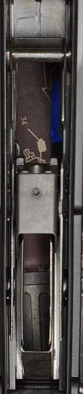

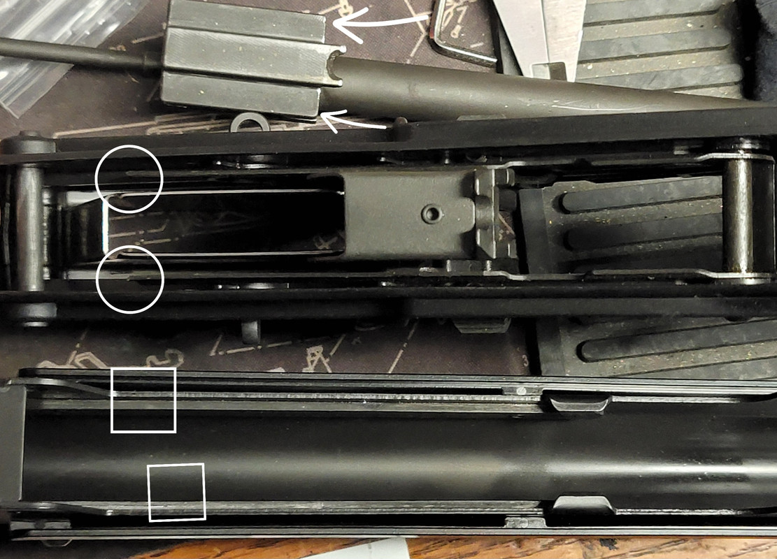

Bolt-Stop investigations
Based on some internet searching, my hunch is correct that the thin bolt-stop arms are at times getting wedged between the bolt carrier and the reciever, making it stick pretty bad when the operator tries to release. It has been posted by a few: this appears related to hot ammo insufficiently gas-adjusted, and to loose screws; where addressing that will fix it. I can't confirm that, but I will say I looked closer, and indeed my screws on the reciever were loose, which affects the "track" those bars run in - maybe. And I was running a wide-spectrum of ammo while Run&Gunning, with not all of it necessarily throttled down to the ideal gas setting, with some of the hotter ammo. So, I tighened the screws, and I guess we'll see. I'll tweak the gas next setting as well. I will say, this gun appears to require more gas adjustement based on ammo type, than any other I've run. Which isn't a huge deal, but a bit of a regulaion hassle to keep up with. |
You may want to loctite those fasteners with something high temp, not just tighten them.

Update 1/7/2023. Will post the details in additional separate follow up
Overall rifle is working well. Main item of note is the bolt sticking on lockback. Tightening screws and softening recoil with ammo and and gas settings has done little (nor did I expect it to). I suspect the arms are serving and sticking between the bolt carrier and receiver walls. I have to rack the gun manually with some vigor, to charge the next mag, as the button is far too stuck to work most times. How do others address this issue? |
