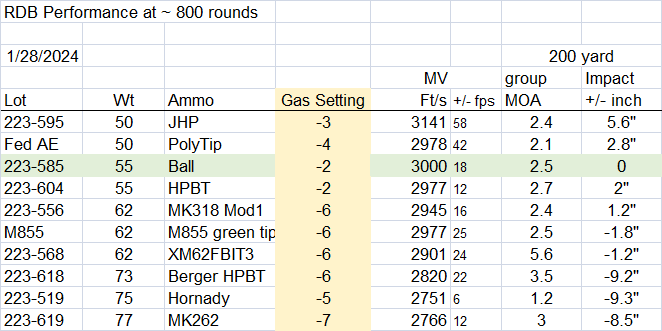

1/7/2024 update: 140 rounds fired.  Good reliability - still having stuck-bolt issues on bolt-lock.
Gun reliability remained good, and did some gas setting adjustments, now that the gun is a bit broken in.  Accuracy was still decent, but only that.
With 55 ball and 55 HPBT giving in the 1.6-2.2 MOA level performance; as was MK318, which is decent enough. (-3 and -2 gas levels; and -4 gas for the MK318)
60 gr Nosler was terrible, and couldn't even keep on the paper (Ah Nosler) -5 gas
69 Sierra Match King opened to 3.1 MOA (-6 gas)
73 gr Berger's and 77 gr MK 262 were more meh, at 2.5-3.5 MOA level (-8 and -6 gas respectively)
The 2.5X scope seemed to work well, and the gun was a pleasant joy to shoot.  And the new handguard looks and feels great.  Didn't shoot mag-dumps to really warm it up, but did try steppign it up some, on some targets - but never was able to get it warm enough to comment on that.
Accuracy and zero were good enough that a 20 round mag got 20 hits on a 200 yard gong (12"), so decent enough.  I'll probably reach out to KelTec customer service this week about the bolt sticking, basically the bolt carrier, the "lower receiver", the bolt-stop itself, and the receiver (upper), are the parts involved and have too much play.  I think with the bolt-release bent in just a bit, that probably will fix it.  Or the guides in the inside of the molded "lower" receiver will do it, I suspect as well.  I'll see what they say.
Total round count: 680 rounds fired through this rifle so far.

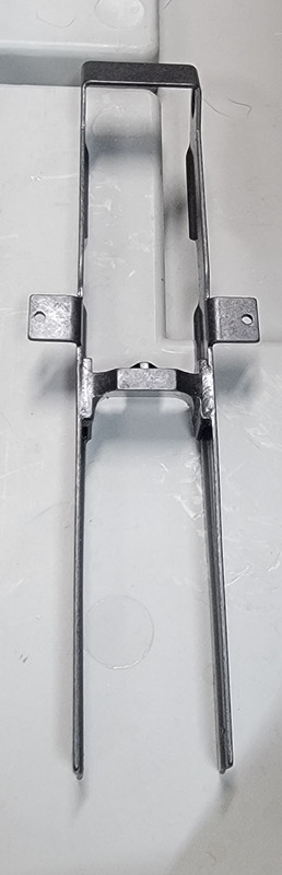

I emailed KelTec and asked if the had a thought on the sticky bolt release issue, and if the could send a new bolt stop.
They did.  But alas, I don't think this will help.  Dimensions are same as current one.  You can see in the below photo where I have the new one engaged against the end of the old one.
I guess my best next option is to increase the size of the internal alignment nubs (you can see one in the bottom left of photo), maybe with JB weld or electrical tape..
1/24/2024 11:33:59 AM EDT
[b]
https://i.postimg.cc/tJZKhQfv/20240123-143056.jpg
https://i.postimg.cc/668qH7xg/20240123-143610.jpg
https://i.postimg.cc/3NsP1fQ8/20240123-143742.jpg
https://i.postimg.cc/DfRZR22Z/20240123-143810.jpg
So, being a KelTek owner now, and having the spare part in hand already anyway (which will be a Major PITA to install, if I have to), I figured eh - let's see what we can do here.  It's a KelTek.
Plan:  Apply a light application of JB weld to the side of the end of the arm, so as to guide it away from the edge of the upper receiver rail just a tiny bit.  note while it's a loose fit in the lower, the bolt-lock lever arm rides inside the rail in contact with the rail, of the upper (see below photo), when assembled.  But only when it goes up, to lock the bolt.  Theory is, if I can get that arm just a bit off that rail and push it inwards just a tiny bit, then it won't wedge between the bolt carrier and the rail upon contact.  that's my theory at least!
So, I mixed up JB weld.  Degrease sprayed the piece, and taped around the area to avoid carry-over.  I then wedged the arms in a bit, for better temporary access.
Mitigation action 1)  and with a toothpick, applied a tiny bit of JB weld on the sides at the end of the arm, and then scraped it clear with a little angle on it, to prevent interference with the receiver rail as it goes up, and to aid pushing the arm in, if it contacts there.  This might actually have worked, though no live fire yet.  I am trying to simulate by pulling charging handle back and then releasing it so it will impact with vigor, to simulate live fire application - but of course, those no live fire like live fire, so we'll see.  So far, this actually appears improved... maybe.  I will say, working with JB weld is... tricky.  So this took a few attempts, and isn't perfect what I wanted - but I did get some on there I think how I want... I think.
Mitigation action 2) I also put a little JB weld on the arm across from where the alignment strut is in the frame of the lower.  Thinking maybe that will help push the rails in too, if they try wiggling out.  TBH, I don't think this actually worked and I probably didn't put near enough here.  You can't really see any of what I'm talking about in the photo, but if you have an RDB, they have a plastic molded spot (under the two sling hook spots actually), that is supposed to contact the side of the bolt-lock arms to keep it aligned, and mine are way too short to actually do jack shit.  So if I can make them bigger, maybe that would help.  Or in this case, I put JB weld on the arm, to make it potentially bigger, to contact those two bump spots.  But not enough, so I pretty much failed to actually implement the idea right - though the idea itself still isn't a bad idea.
Mitigation action 3) NOT YET DONE.  So after some deeper investigation, what I'm seeing is that the bolt carrier has some wiggle in the receiver.  It's not visually obvious in the photo, but pushing it to either side with the hands, does create a gap.  Interestingly, the gap is only on the right side, ( Starboard Side, we'll say; per gun assembled and upright).  The Port Side doesn't have enough of a gap, for whatever reason.  And sure enough, there's already a scratch on the rail inside the receiver, on the starboard side, exactly there.  So, Mitigation action 3, is to just file down the starboard side of the bolt stop a touch, so that it engages on the Port side, and not the Starboard side.
Mitigation action 4) NOT DONE YET.  I picked up a stick-welder for like $60 off the Amazon Deals threat in TEAMS.  So I might just weld a very slightly fatter/bigger face where the piece contacts the Bolt Carrier, so it literally can't fit in the gap.  In theory I could try that with JB Weld, but I don't trust JB weld to take a job that involves being directly impacted like that. (can I?).  Problem there is I likely will have to pull the part out to do that job, which - see above, will be a MAJOR PITA to remove from the plastic lower frame.  And of course take care not to increase the total mass appreciably, so that the mag-spring tension will still lift it reliably quickly.

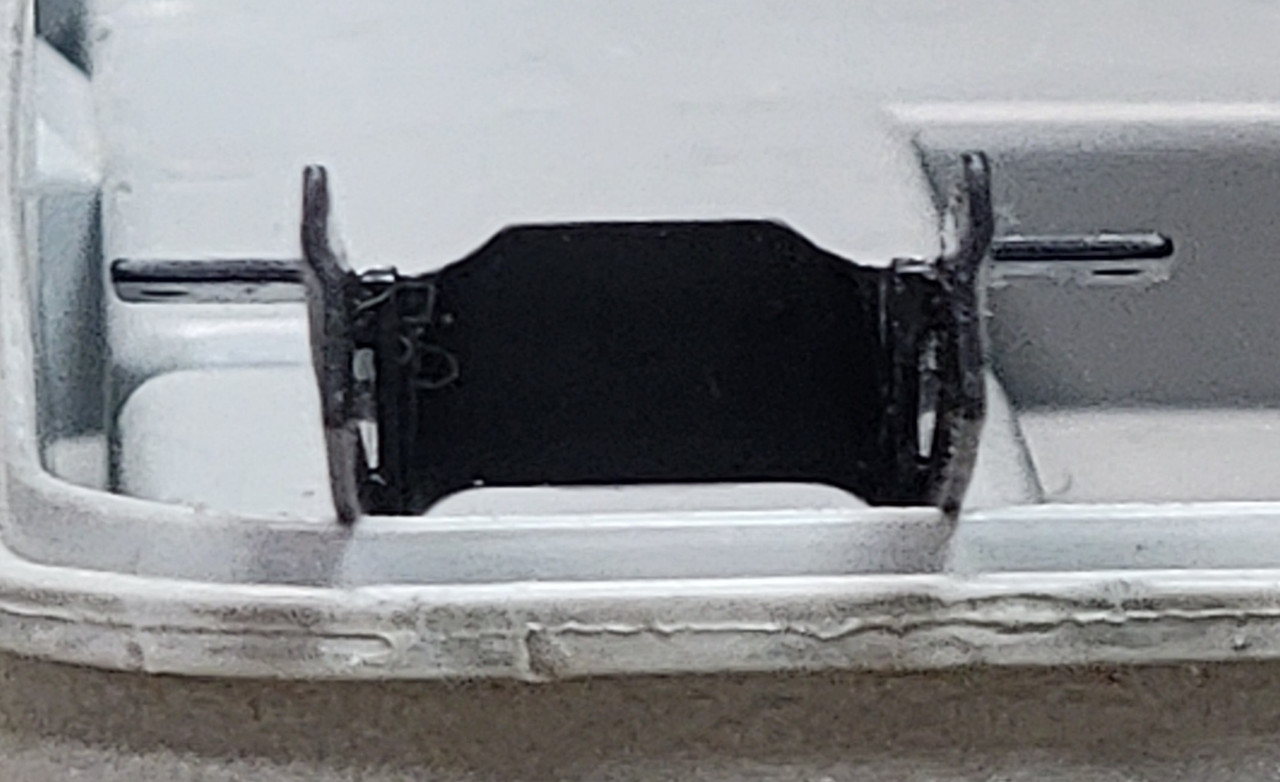

It worked!
My scheme to mitigate the dreaded RDB stuck-bolt-lock issue some folks have, totally worked.  I ran close to 20-30 magazines to bolt-lock today, and none of them had any problems after my simple JB weld trick.  Gun ran smooth and easy with the factory bolt-release button all day long.  Whereas before this, about 80% of my mag-locks were locking up the gun requiring a high-vigor manual cocking action.
Here is Lazy's guide to eliminating RDB stuck bolt issues.
Short answer: A spot of JB Weld on the outside of the bolt-lock tines, to prevent them from being thin enough to fit and wedge in the gap between the bolt-carrier and upper receiver; but light enough application to not affect mass and free-motion of the bolt-stop mechanism.
Long answer:
Problem statement: For those experiencing the operations hang-up of the bolt-getting stuck in the lock back, to the point where the release lever isn't usable, and it takes a high vigor manual cocking action to break free.
Cause:: This is caused by tolerance/play between the receiver rail and the bolt-carrier, allowing the tine at the end of the bolt-lock to get wedged between the reciever and the bolt carrier, locking the gun up; after the last round of a magazine.
Corrective action procedure:
Step 1: Identify which side this is happening on.  This will be evident by scratches forming on the inside of the receiver rail, where the bolt-stop tine (the end of the 4" long bolt stop part, where it engages the face of the carrier to stop the bolt).  In my case it was on the right (starboard) side.
Step 2: apply protective tape on the inside of the lower receiver so that drips and overages don't get stuck on the ejection chute outside wall or on the plastic lower.  (I used electrical tape applied to the inside surfaces flanking the bolt-stop tine; for both tines.  (where "tine" is the end of the long stamped-metal bolt-stop that engages the face of the carrier)  I.e. Tine is clear, but the receiver components around it are now covered in electrical tape for the duration of the application procedure.
Step 3: JBWeld and toothpicks.  Carefully apply a small 1/2" run (ish) on the outside of the metal tine, towards the end.  This can be quite thin, 1/32" layer.  The purpose of this is to every so little, push the tine in, so it no longer is aligned with the tolerance-play gap formed between the bolt-carrier and the receiver rail.  So that now it just engages the face of the bolt-carrier.    Note this application is only effective where the tine part gets raised above the lower-receiver and into the channel-area of the upper.  So only 1/16" down the tine is needed - if that.  Don't apply to the contact-face of the tine that engages the face of the bolt-carrier, as that part will get impacted and I can't say if it will hold up long to that.
Step 4: Using clean toothpicks, scrape the face and top of the tine clear, and then with a clean toothpick, run it along the top of the tine at a 45 (or so) degree angle, which will put small angle on the JB weld that's applied along the vertical outside surface of the tine.   Do this for both tines.  This way as the bolt-stop tine gets raised by the empty mag engagement and contacts the upper receiver rail, it won't just stop, but push in a bit, which is all you need.  We're talking 1/64" is all it takes to eliminate this problem.
Step 5: let sit for at least 8 hours, then pull off the tape, reassemble, and make sure everything is running OK by hand action (i.e. make sure you don't screw up and JB weld something frozen somewhere)

Here's what it looks like with the successful JB weld addition.  It looks thicker and sloppier in the photo than it really is.  It's all but invisible to the naked eye, if not looking for it in on a disassembled gun.  KelTec also reached back out to me, and said ship the gun back to them if I like; but I declined saying it's running fine now.
Here's my latch for the charging handle.  I think someone said don't HK slap the RDB too much, or it'll cause wear - I guess there?  I have pushing almost 1000 rounds on this gun now, if you can believe it, and it looks fine to me.  I will say, I don't dry fire this gun, and as such don't do a lot of empty gun bolt release with a pulled back charging handle.  So my charging handle doesn't slam forward very often.  I do this partly because I suspect the RDB has over-strong hammer springs to compensate for teh long throw of the hammer to engage (to keep lock time down).  So with that, it probably whacks the firing pin rather hard, and so I don't dry-fire it any more than I have to.  Which also means I don't rack and release the bolt very much.  For the most part, my charging gets run at the start of the day, and that's about it, unless there's a bolt hangup.
On other notes, I put at drop of blue nail-polish on the gas system at position max (0).  And I'm running a cheap $25 USB charged flashlight/green laser; though haven't given that a work-out yet on this gun.

1/28/2024 update - range outing accuracy and zero testing for preparing a ballistic table for the gun: 140 rounds fired. No failures - aside from a couple anticipated jams while doing gas adjustment for setting optimizing.
Also, verify that JB weld spot on bolt-stop arm to move it away from the rail a tiny bit, worked.  And it did, the gun no longer locks up on bolt lock, and the bolt release works well now.
Below is performance accuracy and impacts of different ammo at 200 yards.
With this, my nominal practice is to make a gun-specific ballistic table; with the gun zero'd at 200 yards with the 55 ball, and then the sights left at that setting, and note what zero that means for all the other ammo, and perpare the ballistic table for the gun at and left at the zero for the 55 ball.  Which i'll work on now and post below if I get to it any time soon.
A couple items of note - the overall accuracy is about expected at 2 -2.5 MOA nominal with ammo it's OK with.  Not great, but serviceable.  Of interest a couple trends:
-There really was no trend with bullet weight and accuracy performance.  Light or heavy on in the middle, nominally was about the same.
-POI at 200 yards very much did shift with weight, with lights going high, and heavies going low (FWIW, opposite of AUG; though I can't say what that means or why).
-Accuracy with ammo it had hated, has gotten better.  With M855 giving 2.5 MOA, and the 75 gr Hornady ammo (over IMR8208) it really quite liked.  Don't read too much into the 73 and 77 gr ammo accuracy, as those are American Reloading pulled bullets, and rough-life treated bullets at that - they don't shoot that great in any gun.
measured throat erosion after cleaning, which is noted a couple of posts above.
-Older lot of 55ball, and I guess with a conservative charge that day or something, as it clocked a bit slow IMHO.
Also updated the gas settings table.

As a reloader, one occasional experience will be a blown primer, from brass with a worn primer cavity.  In the AR15 platform, that can typically end up in the trigger and jam the rifle up.  I don't encounter this often at all - quite rare - but it does happen over enough rounds.
One little noticed feature and appeal to the RDB is the casing doesn't tilt away and allow a loose primer to separate until over the down direction ejection chute.  It would appear a blown primer is less likely to end up bouncing around the internals of the gun and result in problems in an RDB, compared to most other guns.  Indeed, other side eject bullpups like Tevor and AUG also are less likely to have trigger issues as well.  But the blown primer could still end up in the mag well area and action and cause cycle close problems.  Where in the RDB, there is nothing below where the casing finally tilts away from the bolt face and exposes the lose primer.  It will simply gravity fall down the well.
Or at least, that's how it looks.  An under-praised advantage unique to the RDB - I think so, at least.
