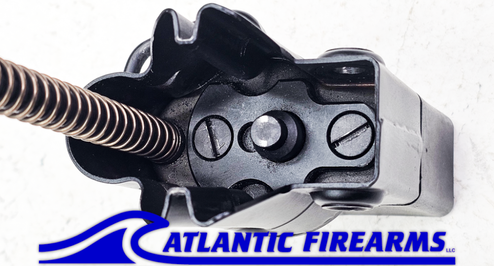

Originally Posted By ATLANTIC-FIREARMS:
What do you need to know ?
Locking piece, carrier buffered or not, and is the recoil rod tied to the stock end plate like a g3 or standalone like mp5?
2/4/2025 8:03:39 AM EDT
They do not have a buffered carrier and yes they have a sear block
ATLANTIC FIREARMS.COM

Well this photo dashes some hopes and dreams with the recoil spring assembly being tied into that end cap.
That’s confusing

Originally Posted By Damon_23:
That’s confusing
That’s confusing
It is, and it's got me wondering if that's not actually a 91/G3 back plate?

Definitely adds another layer of asspain getting a brace on this thing.
Could be. Doesn’t look like the buffer in the hk33 stocks I’ve seen photos of (below). Just looks like a G3 stock buffer.
2/4/2025 3:53:06 PM EDT
[Last Edit: D_Man][Edited] [#38]
Could always unscrew the little 2 inch long plastic stock on the back and try screwing on a 91/93 series stock that uses the metal plate to get a full fixed stock look.
Otherwise, can't you remove the recoil rod if you really wanted by cutting out the mushroomed bit inside the end plate?
ETA: Or use any buffered stock like the MKE A3 and just get an aftermarket recoil rod assembly like this: https://hkparts.net/rifle-smg-parts/hk-53-5-56-223-recoil-assembly-complete/
2/4/2025 4:12:52 PM EDT
Originally Posted By D_Man:
Otherwise, can't you remove the recoil rod if you really wanted by cutting out the mushroomed bit inside the end plate? /[/url]
That’s what I did to rehab an old A3 retractable stock for my G3k clone.

So I'm guessing the standard folding SB tactical brace won't work with these?
Guess I'll just grab the A3 MKE stock and be ready to form 1 as soon as I order the 53.
2/4/2025 4:19:17 PM EDT
No, you will not want to use any kind of MP5 stock for these.
2/4/2025 4:24:47 PM EDT
I'm still a little confused... what you guys are saying is that the MKE HK33 style stock that AF is selling will not fit the AP53 without modifications? or at all?
If true, that's a shame as I bought one of the stocks awhile ago in anticipation of these coming in the country - expecting a quick SBR conversion.
2/4/2025 4:31:03 PM EDT
Could be the incorrect photo shared above (maybe a G3 stock).
Worst case, dremmel goes brrr and you can still use your HK33 stock. Or just get the separate recoil rod shared above.
2/4/2025 4:31:39 PM EDT
The MKE HK33 A3 stock should be usable, because it has the buffer in the stock.  But, since the gun's recoil rod and spring are essentially riveted to the endcap that comes with the gun, you'll either need to cut it out and clean it up to use it, or buy an aftermarket "free-floating" recoil rod assembly like I linked above.
Additionally, since these guns have non-buffered bolt carriers, you'll want to make sure whatever stock you use has the buffer in it.  HK changed designs through the years, sometimes they had a buffer built into the back of the carrier, and those guns used stocks with just a little rubber disk in them (like these ).  And other times they used no buffer on the carrier and had it instead in the stock.
The picture from AF shows an attached recoil rod and spring to the backplate of the stock, which means, most likely, you will need to purchase another 53 recoil rod, but then you also have to deal with which stock to use bc it needs to be buffered since the carrier is not buffered. Below is a pic showing a buffered 93 stock.

Went ahead and ordered a recoil rod, bc in the event you have to butcher the stock one from the end plate, I don't want to be caught empty handed when they are out of stock bc every needs a new recoil rod.

Somebody in HKP said Century/MKE are working on a fix for this issue, but who knows how long that will take. This whole thing really turned me off of this 53. Going to still get one but this sure threw a monkey into the mix.
