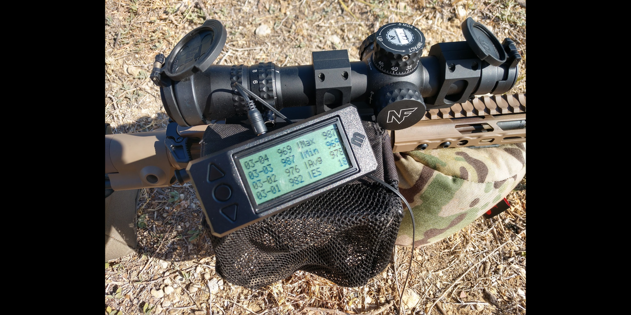

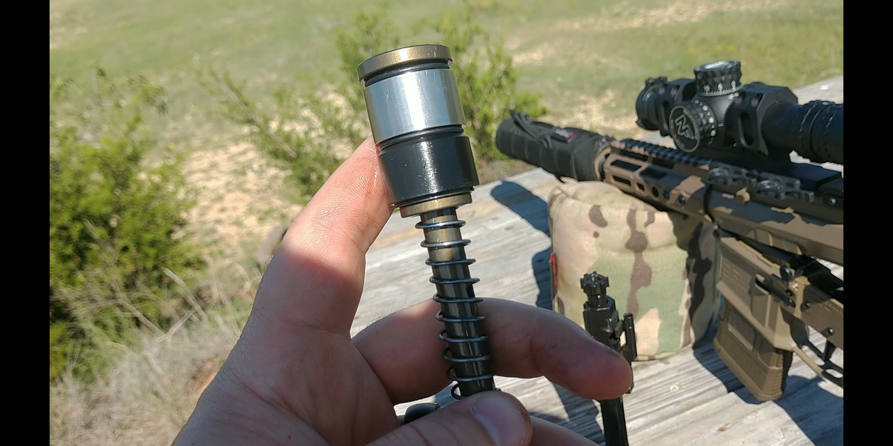

10/9/2022 9:35:28 AM EDT
[Last Edit: Demphna2][Edited] [#16]
Originally Posted By airgunner:
Seems like the options for a good 300 sub powder are limited with no perfect or ideal choice? CFE BLK is commonly recommended (and easiest for me to find) but apparently not a quiet as other options. Lil-gun can apparently be really quiet but after reading about the issues that Obsessed detailed above, I have no interest in dealing with that no matter how quiet it is. N110 probably won't cycle (but I have read some state it will cycle in a short barrel/pistol gas barrel?). I've read a lot of good things about N120 but Vihtavuori powders are hard to find locally and I'm not crazy about the price or it being really gassy.
I started using Vihtavouri N110 and then tried N105. Holy magic powder. Burns way cleaner, definitely way more quiet. And accuracy was awesome with both. This was with 190 gr Sub-X bullet. I haven't tried any other bullet combo yet.
N105
N110
I had no issues cycling N110 like I thought I would. This is with a V7 6.5" barrel. They use a proprietary shorter than pistol gas tube length with a port size of .104". And I'm using a TBAC Ultra 9. Good suppression and back pressure.
N105 proved to be more challenging to get BHO. It cycled from the get go, but wouldn't lock back on empty. I'm using a maxim brace with a JP SCS XS, so there's only 2 weights (one steel and one tungsten).
I tried 2 steel weights, the lightest spring, and a titanium BCG. I videoed the BCG in slow motion to see how close I was getting. Which was damn close.
I was running a B.A.D lever at the time and after watching it in slow motion, I decided to take it off. Too much play going during cycling.
The solution that got it running was seating the bullet further out, using one steel weight and one delrin weight, using the lightest spring (85), and using a 2A titanium BCG.
Some things to note:
I did use Gordon's reloading tool to get an idea on muzzle pressure and play around with seating depth and powder charge in relation to muzzle pressure. For N105, seating the bullet further out makes the powder less efficient and slower burning which was exactly what was needed to push it over the edge.
I did try CFE Blk and H4198 previously. 4198 provided good numbers and accuracy, but it was gassy and loud. CFE Blk was even worse. Unless using for supers, that powder is worthless in my opinion. The premium you pay for VV powders is definitely worth it to me considering you can get 100% burn from N105 in 5-6" of barrel. N110 is burning close to 90%, whereas CFE Blk is somewhere around 60% give or take in a short barrel.

I thought we discussed that here a couple months ago,  but I can’t seem to find it.
I had ok results working up to 10.8 gr. of N120. That load gave me around 960 fps from the 10.5” AR15. Bolt did not lock back, using standard CAR buffer & spring. When I added a silencer, it did lock back on the last shot.
The same load gave me right at 1000 fps from a 16” Noveske barrel. Nonissue locking back, suppressed or otherwise.
Both AR15s provided 5-shot groups around a 1” at 50 yards.
The 10” Contender with SSK .300 Whisper barrel shot that load at 1015 fps. Again, most groups were around an inch, but the best group of the day was .386” @ 50 yds from this gun.
I also tried 6.5 gr. of AA#2, which works great from the Contender, but is unlikely to cycle in a semi-auto.
I tried shooting one into a line of milk jugs of water to check expansion. Unfortunately the bullet went through all 6 jugs and was not found.
