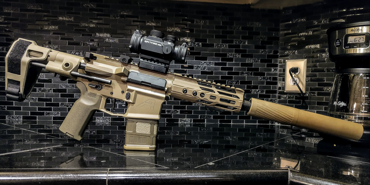

Alright guys, need to tap into the minds of all the 300 blackout masters.
6.5" V seven barrel. I shit canned my subsonic project exactly a year ago, but I'm back at it. This time using 190 gr Sub Xs. Using H4198 and everything is working fine.
I have gone down the rabbit hole a little bit researching about minimizing port pop, utilizing faster powders, and adjustable gas blocks/carriers all in the hopes to make this little bastard as quiet as possible.
I do realize that an AR reciprocating system is loud enough on it's own, but I think there is an opportunity to reduce the sound a little bit lower.
1. The gas block and tube are proprietary to V seven, if I'm going to mess with the gas, I would want to try a titanium adjustable carrier. As a side note, all reloads down to 900 fps held the bolt open on the last round without the suppressor.
2. I have read that fast powders such as Accurate #9, N105/110 would yield more quiet results.
What are your thoughts?
https://photos.app.goo.gl/ZevFDNPQd9XV6hJ99
Video reference for current subsonic reloads noise (still fine tuning).
