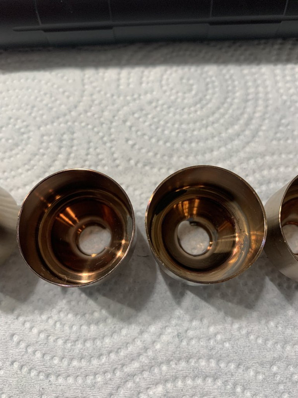

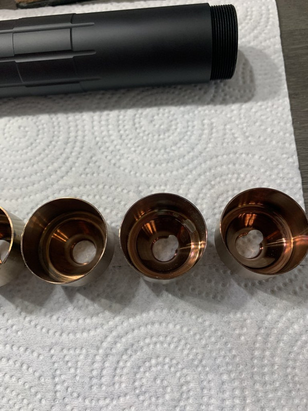

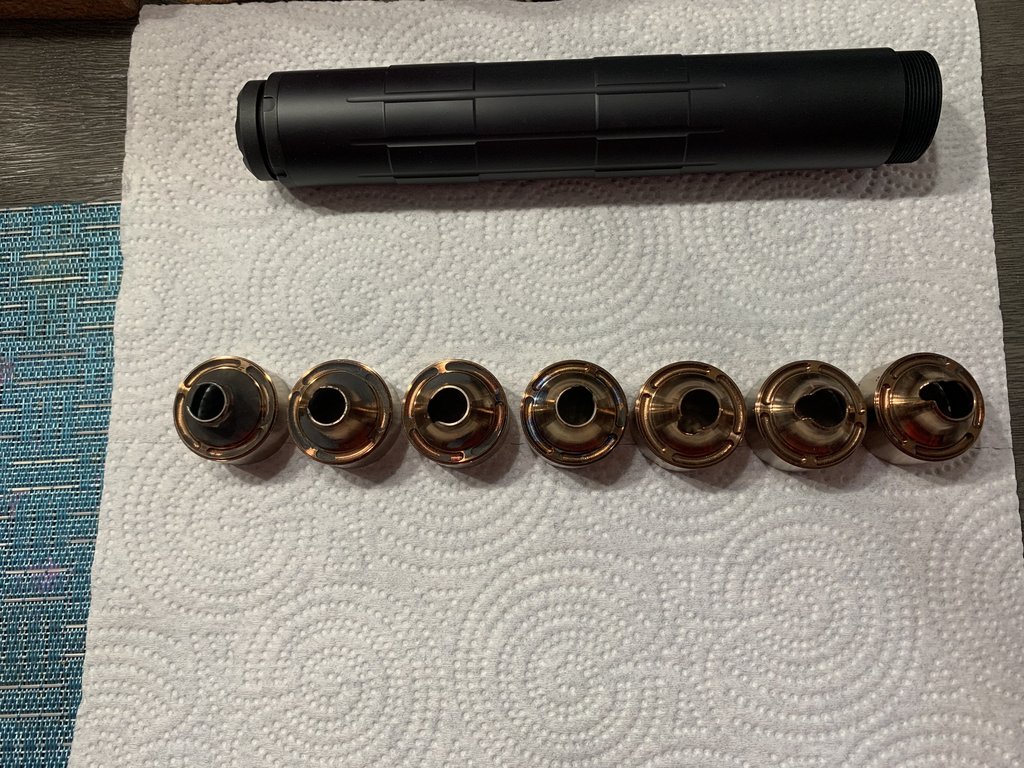

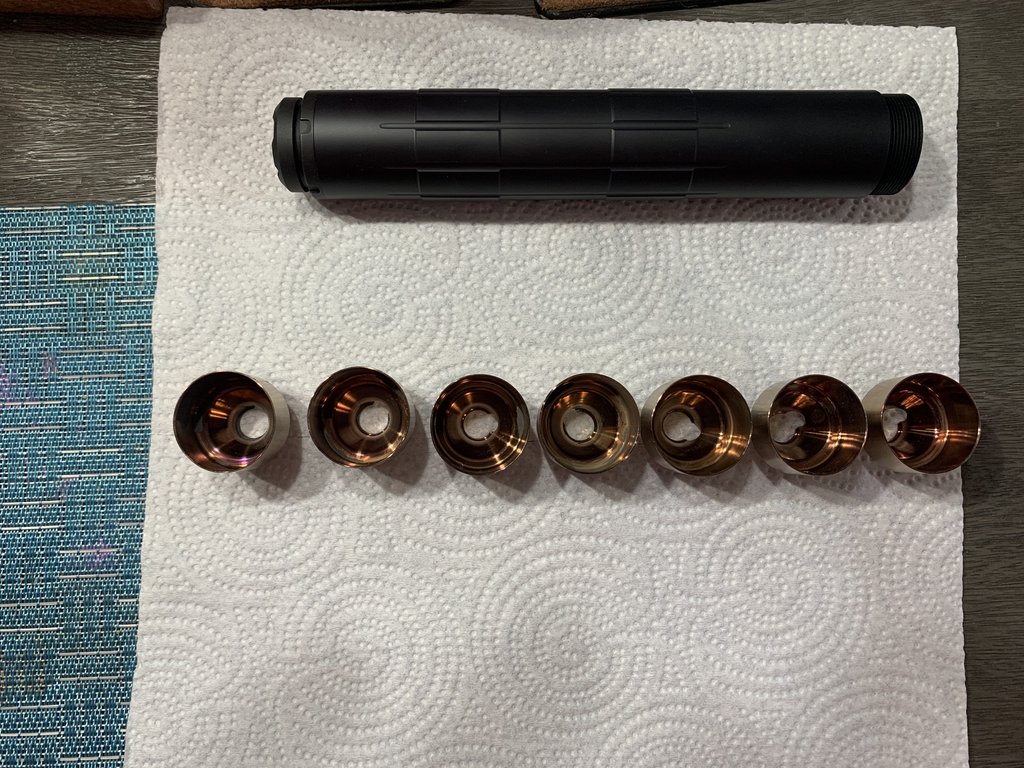

I picked some up at PSA.  Here's my experiences with it.
I have a GEMTECH MULTIMOUNT and per the old website states should come in at 6.5oz, It's a very negated suppressor. Weighing in at 8.1oz before cleaning.  It was so bad that the 1/2x 28 L.I.D. The adapter would not fit and the baffles would not budge. There was a ring of lead and carbon inside the blast chamber that must have been 3 millimeters thick. Without being able to install the 1/2x28 adapter, I would not be able to use the baffle removal tool.
So I 3D Printed a plug for my 18x1 Adapter, poured the solution in the suppresser, and let it do its work
Day1:
After 4 hours the last Baffle (7) came out without any effort, using a pick. it was supper clean after a little brushing.
Day 2:
Buffel 6 came out the next day but noticed a white haze.  Has to use a nylon brush on it, but otherwise no carbo or lead.
Switch out the solution in case it was spent.  I do think the solution does get weaker.
That night baffles 5 and 4 came out, and required some effort. Switch out the solution one more time and let it sit overnight again.
Day 3:
The solution was super dirty, but the remaining baffles were not budging.  Emptied the suppressor and used an AR-15 BCG Carbon Removal Tool to work on the ring of lead in the chamber. Took an hour but got the 1/2 x 28 Adapter in and was able to use the baffle removal tool.
It did not take very much effort to get the remaining baffles out with the tool.
Put the 4 baffles in the used solution as they were still dirty.  I also put some solutions back in the can to keep working on the ring of death.
Day 4:
Took everything out and washed them with hot water and dried them. Used CLP on the steel part of the can.
The white haze showed up on any aluminum baffles that had more than 12 hours in the solution. The blast baffle is titanium and does not have a haze to it.
here are the results.  I may put the first 4 baffles back in some new solution.

I soaked my sealed AAC Aviator in the cleaner for 3 days. Just dropped the whole can in a mason jar and would agitate once or twice a day. The finish is fine except the end cap looks like it lost a little bit of finish. I forgot to weigh the can before the cleaning.
It looks like it did a really good job. it is much cleaner and I could see the port/ hole on edge of the blast baffle that was filled with crud before. It also sounded better.
