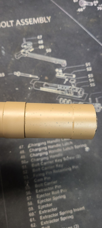

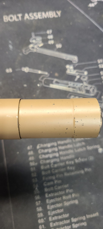

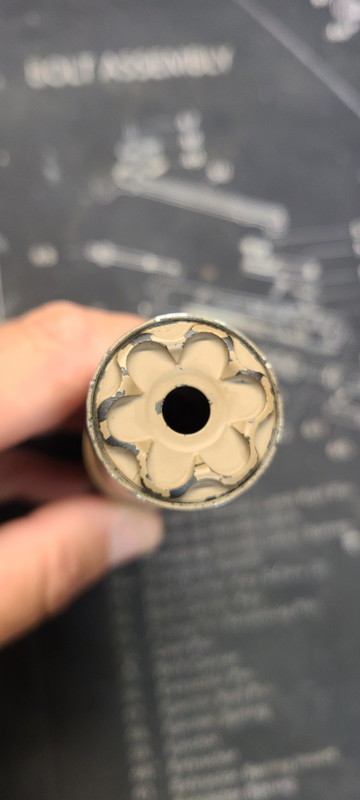

I just cleaned my mustang after 500 or so rounds. I took it apart and put it in a zip lock bag with enough to cover the parts. 24 hours later it was like new, did not even need to wipe it. I dumped the used solution in a gatoraid bottle. I will try to reuse it until it stops working, then I will take it to the dump, they have a hazmat section ( limited hazmat )
6/14/2024 10:21:49 PM EDT
Just the baffles or the whole tube?
6/15/2024 12:08:03 AM EDT
The whole thing.
A few pics, middle of the rear stack and the outside.
Total round count about 800 or so.
6/15/2024 3:38:31 AM EDT
Interesting.  I didn't know the Mustang baffles are basically miniaturized Obsidian baffles.

StaccatoC2 thank you. I thought I read somewhere where it damaged the cerekote on the tube...guess not.
6/15/2024 10:44:54 AM EDT
It does, its taking the fde off my mustang after just a couple uses. I no longer soak the whole thing. Just the baffles. I've posted this where I can to help people out, but people are still soaking the whole thing. Ive already posted that about a week ago in this very thread.
People are probably just not seeing it because most silencers are black, but you are definitely stripping off the finish.
6/15/2024 11:24:52 AM EDT
People are probably just not seeing it because most silencers are black, but you are definitely stripping off the cerakote.
Yikes. I'll stick with the plan of plugging the end cap and just filling it to soak.
