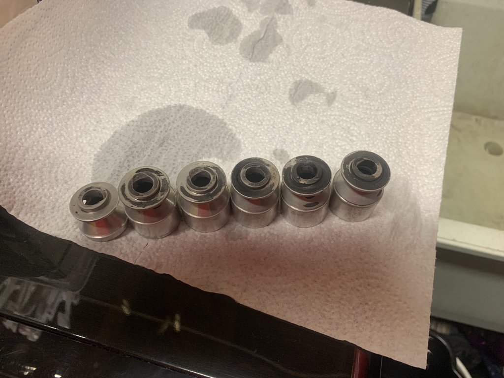

Just soaked these aluminum baffles from my 7 year old Huntertown 9mm can, they were pretty dirty and never could get them no where near this clean.
Soaked them, took a nylon brush and scrubbed them off, rinsed with warm water and this is how they turned out.
Not to bad.
Not to bad.
https://i.postimg.cc/JhtQSwjZ/F3-D6224-F-0-D08-41-A0-A9-C1-5-D26-EC3-ED295.jpg
https://i.postimg.cc/qB2xPx6b/A95-EC7-B4-D281-430-D-8-D33-62-E13-EFE31-D6.jpg
https://i.postimg.cc/m2wNDZw7/7171-CA7-E-B440-4175-A756-2-FFA80-B3-F74-B.jpg
I have never seen spacers like that on a can with K baffles, they could almost double the amount of baffles in there. Or make the can a lot shorter. Normally K's are stacked right on top of each other.
@arjohnson
1/29/2024 8:06:56 PM EDT
@arjohnson
It’s a Huntertown arms can, probably why they’re out of business.
Not to bad.
@arjohnson
The k baffles nest into the prior baffles spacer like an AAC Halcyon. Takes up some volume but keeps baffles from bonding to tube with carbon.

I've got an old Bowers CAC9 I use on a MP5 shooting mainly cast & coated projectiles, lots of full auto blasting. I don't really keep a tally on rds shot since I last cleaned it but if had to guess I'd say at least 2K so it wasn't terribly dirty.
I've had the baffles soaking for two weeks and simply wiping each baffle with a cotton patch and then soaking them again. Jar holds about 8 oz and I have not changed the solution. At this point two baffles still have a minimal amount of crud on them and had I changed the solution they would probably be like new already.
I am pleased with the results, yes it is slow compared to soda blasting but not nearly as messy! I'm not ready to toss my soda blasting gear yet but it will definitely take a back seat to the Breakthrough cleaner.
