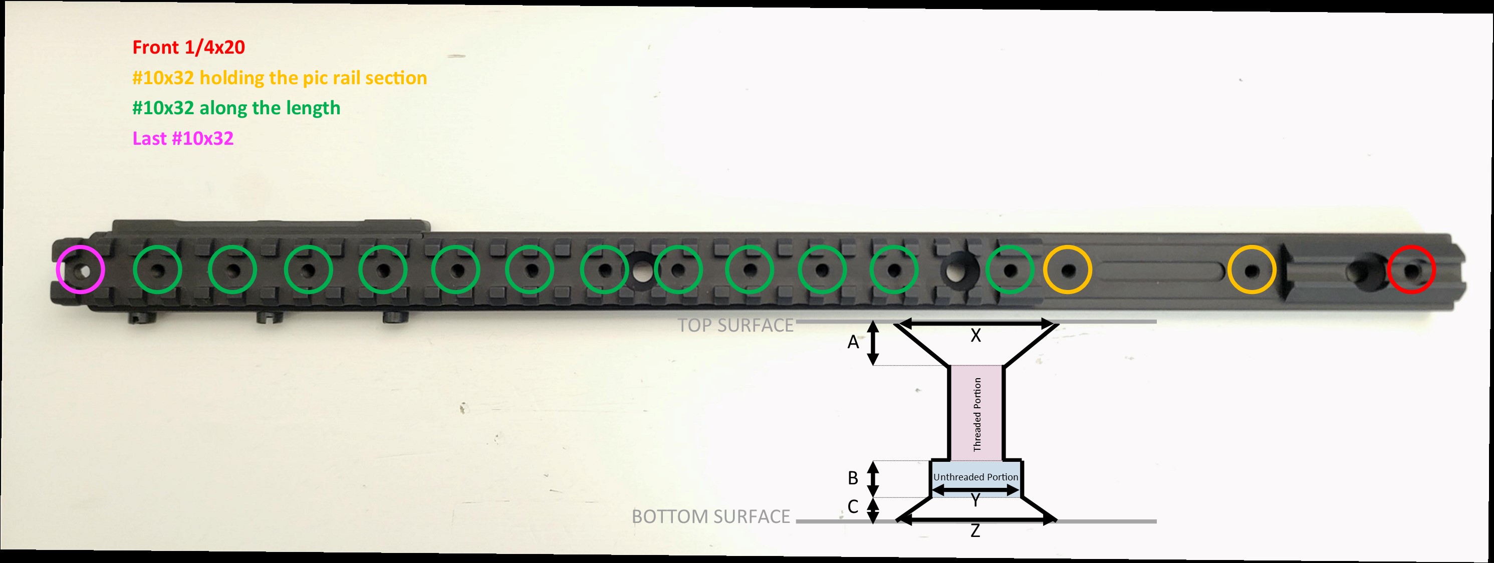

I got the PRI PEQ rail in anndd... they are threaded through holes just like yours, all of them. Good news is everything else other than the maker's marks looks spot on (other than the color). The forward arrow mark on the rail clamp is sightly different and there's no forward arrow mark on the removable pic rail, but even I am not autistic enough to care about that.  This is gonna be a long shot but @Engineer5 or anyone else with an actual ARMS item, any chance you can help us out with these measurements?
There's 4 different threaded hole types which I color coded. I know Red and Green have an insert. Pink, that last one, is drilled through thinner material just wondering it is any different from the Green. And the two Yellow ones are for the pic rail section, I don't know if those have an insert or are just threaded holes on the ARMS.
I've seen different things from different photos but the most general hole shape is in the side view, the insert doesn't seem to run the length of the hole so there's an unthreaded portion below it. I'm looking for the depths A, B, C and the widths X, Y, Z. Could be the bottom isn't countersunk so C = 0 and Y = Z, etc., but I don't know. Seems like on Engineer5's there is only a very slight countersink on top with A very small and X almost the same as the threaded portion. I'm just going to assume that the threaded portion is the right dimension for the helicoil of the right size and the chamfer angle is 82deg, but if that seems wrong would also love to know.
https://i.postimg.cc/HTpV7MLJ/38-MEASURE.jpg
This is next level autism, I love it! Just keep in mind that we have to anodize after machining but before the steel goes in.

[Last Edit: Slu54][Edited] [#18]
See my post above. Yes based on Engineer5's and the reddit poster photos I think they are helicoils. Definitely easier to do since they are easier to source and dont require any proprietary dimensions for the hole to ensure good fit without damage. The holes are also easy to center with a threaded hole center since they are already threaded. I just need hole dimensions I listed. As you can see from the photos you posted the helicoil does not run the length it is only part way through.
If you look at the clamp bar of the PRI sleeve it has two holes with thread inserts, but I'm more interested in getting it exactly like the ARMS. I am also not sure if the two holes holding the removable pic rail section are sleeved (can't tell from the photos you posted since the screws are in), how the last hole differs, and obviously the front larger 1/4"x20 hole.
Did PRI share any hole dimensions at least for their insert holes?

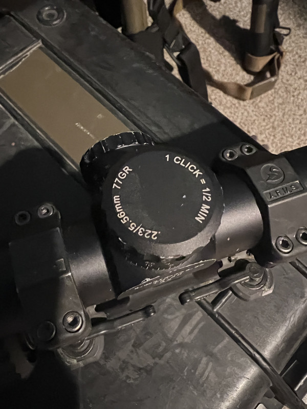

This is what the Custom Shop did for me 15 years ago.  Still pisses me off to this day.  I gave them explicit instructions on what to engrave and they did their own thing anyway.  It's the last piece I need to correct.
