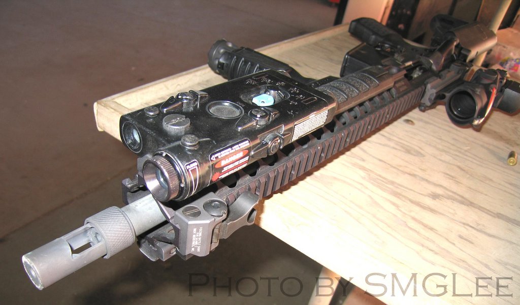

10/10/2006 8:49:57 PM EDT
10/10/2006 9:09:14 PM EDT
lol I was gonna say, Chen yer missing the lens caps on yer PEQ2-A too?  Took me a while to realize it's mine
