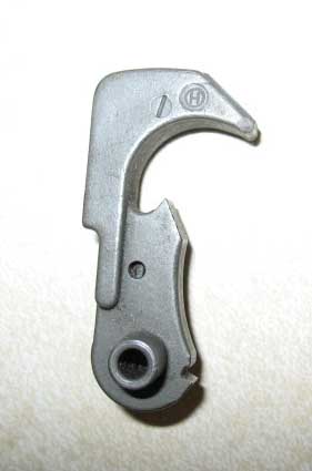

So willyp has this documented example:
I found these that have the similar hash mark:
I hash mark
II hash mark
this one doesn't look like the other 2 but have a III type of mark
thoughts?  are those H&R as well without the H mark?  I haven't actually seen an H marked hammer in person.  Has anyone else come across one?
PrivateSnafu or WpnsMan have any experience with these?

I have an H marked hammer, but it's not in a circle.  Or is it  HI ?  I also have a selector like yours with the II, mark on it. The selector came in an SGW/Olympic lower kit from 1984. Back when they were selling FA parts to the public.
I ran the H marked hammer passed Rob and WP and they seemed to think it was a modern vendor.  It may have a capital H and 3 dots.  Sorry, I've not much wisdom to add.

yeah i've seen bolt catches with the capital H and dots.  i think they were reportedly modern contractor parts.
8/17/2015 5:35:06 PM EDT
I've only encountered H marked hammers on rebuilds or as spare parts.
Probably a sub-contractors mark as all the H&R FCG parts on original rifles I have encountered had numbers within a circle (1-4) on the Hammers/Triggers and numbered or blank selectors.

That hammer looks to be single hash marked as opposed to a circled 1. Never seen an H marked hammer in a H&R. Trigger looks H&R though.

The H marked hammer that Willyp has was removed from a H&R demil. Unfortunately the right side of the receiver was missing, so this was probably from an Anniston rebuild. And not an original as it left H&R as first thought.

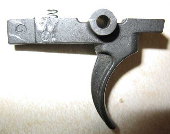

All the H&Rs demils I've handled that have not been rebuilt have hammers and triggers with raised numbers in a recessed circles like the photos below.
The numbers 1 and 2 are usually on the right side and 3 and 4 are usually on the left side.

awesome info guys.  so the difference btw the 1 in a circle and the hash one is the hash one lines touch the circle and the 1 doesn't touch the circle edge.

I've seen circled numbers on hammers and triggers in GM production, same as the bolt catch. It is possible GM and H&R used the same sub-contractor for portions of their production.
