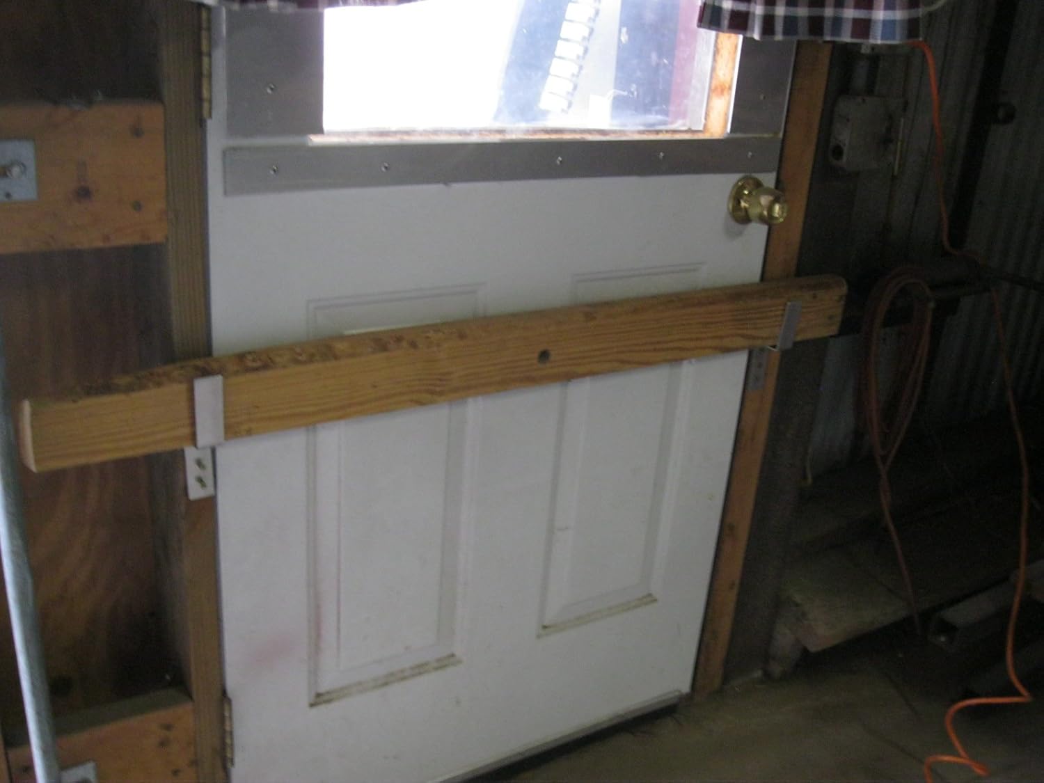

Unfinished basement?  Maybe something like this
I'd try to get something that would allow the 2x4 to be turned the other way for more strength.

I was thinking something like that for the doors but would also like some steel doors and frames so I can get in with a key if I need. I have a single door at the back and double doors on the side.
