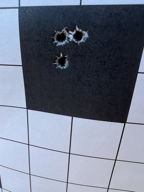

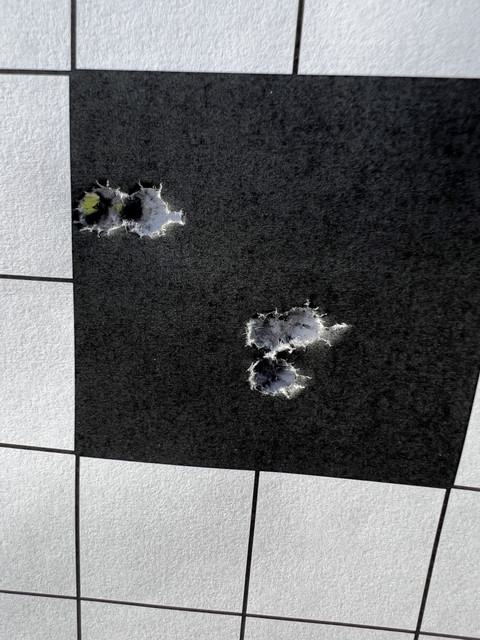

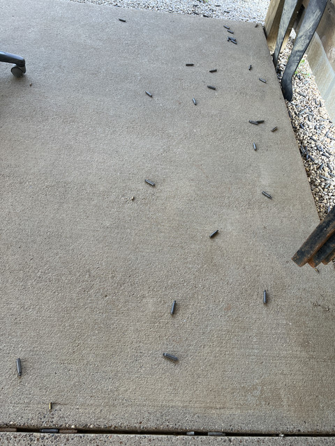

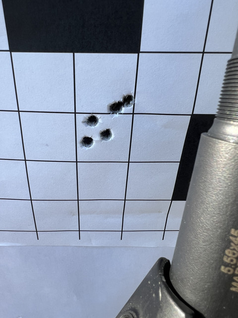

I took my 16" 1:9 M1 NATO to the range yesterday.  It was 99F with high humidity (less than ideal shooting conditions):
I was shooting Wolf steel case 55gr:
These are my 100 yard groups off the rest in the picture above (the white squares are 1.0" x 1.0"):
The yellow arrow points at the 200 yard backstop (same as the 100 yard in the foreground) except the 200 yard also have an 8" diameter round "steel gong".  I can hit it 100% of the time with the RMR piggybacked on the ACOG (off a rest only):
I've owned / shot these guns for 36 years.  EVERY SINGLE ONE I've used has produced similar results. If your AUG is not then chances are its the Indian not the Bow.
https://i.ibb.co/XZntfGsy/IMG-5608.jpg
https://i.ibb.co/1Yj3RxGW/IMG-5607.jpg
https://i.ibb.co/pjRW5JBh/IMG-5606.jpg
https://i.ibb.co/4wGqMts7/IMG-5604.jpg
https://i.ibb.co/v6jXc8BM/IMG-5603.jpg
https://i.ibb.co/dwz2zRmV/IMG-5598.jpg
https://i.ibb.co/tkvpK7N/IMG-5599.jpg
https://i.ibb.co/p68BFjcq/IMG-5600.jpg
https://i.ibb.co/Y4MKZrcq/IMG-5602.jpg
https://i.ibb.co/PsSKLr3w/IMG-5605.jpg
