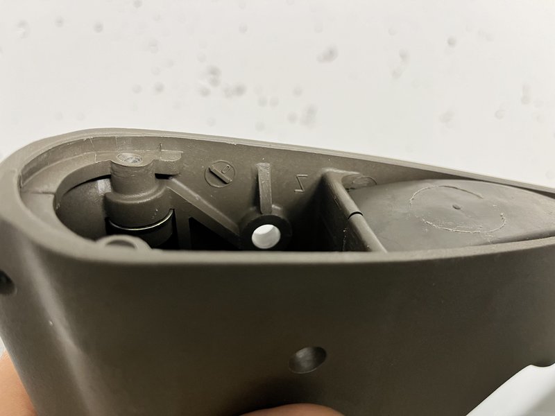

Trying to decide if I should file the corners down…purchased in January/february 2022 if i remember right.
Attachment Attached File

Link Posted: 3/8/2024 8:42:46 PM EDT
[Last Edit: casktcrw] [#9]
https://www.ar15.com/media/mediaFiles/155148/71407509091__3B31852C-D729-4649-8AC3-BCA-3153582.JPG
It looks like it’s just the top that’s got sharp corners. I wouldn’t fuck with it if it were another gun, but the way they… Handwork the stock… I don’t think it can make it any worse.  Somebody, not here, suggested to me that they don’t believe the black ones are breaking. They might be, but I’ve yet to see a photo.
Link Posted: 3/8/2024 11:08:45 PM EDT
Can anyone decipcher the date code on my stock? It doesn't have the same code style as the one pic'd on Page 1...
Link Posted: 3/9/2024 7:13:27 AM EDT
https://a4.pbase.com/g13/07/240307/2/174397084.55ab07c6.JPEG
https://a4.pbase.com/o12/07/240307/1/174397080.PUkfqAYL.20240308_210000.jpg
Hard to read but i will guess that’s the material code not the date. Where i work parts have two marks, kinda similar loking, one for date one for material. On the date, there is an outer ‘wheel’ with months 1-12, you rotate the inner circle with arrow to indicate to a month, and there js a two digit year on the sides of the arrow.
Link Posted: 3/9/2024 10:56:29 AM EDT
When did you purchase that AUG/stock. It may not have a date code. I have some stocks that don't. (prior to 2019)
I bought it a week ago...but I'm the third (at least) owner, so I'm not sure when it was bought new.

Just took my AUG apart. Looking at the date code, the arrow is pointing to “2” with a 2/1 below it. I’m guessing manufactured in February of 2021?
Would my stock be in the range of potential issues?
ETA: Looks like it could be but I also haven’t heard of any black stocks cracking.
Just put my Aimpoint pro on it this morning. Will probably take the BUIS off but wanted to throw them on there. Also removed the spacer on the Aimpoint after I took this photo.
https://www.ar15.com/media/mediaFiles/155148/IMG_0238_jpeg-3159630.JPG
Don’t you nean a 2 to the left of the arrow, and 1 to right? That would be a typical dateclock core.
I sure would (and did on mine, made it match the later one I got).
