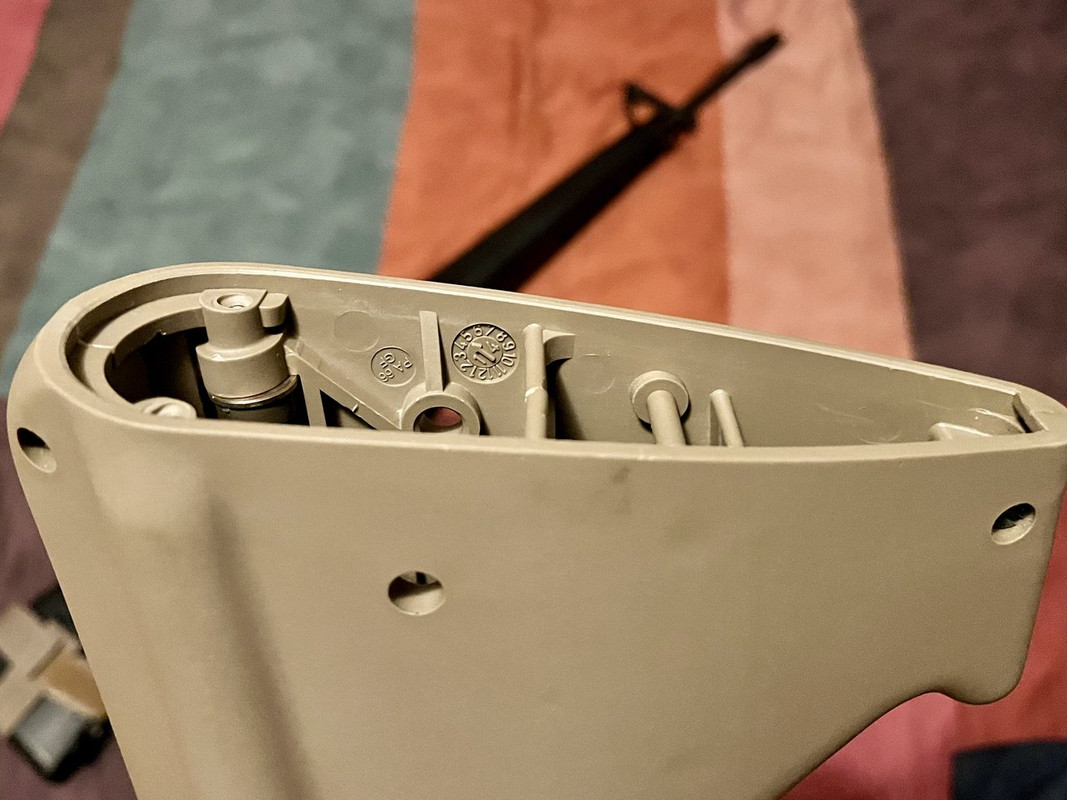

Let me know if I’m missing something here.
Old stocks didnt crack
New stocks do. Started at least several years ago, persists to this day. Noone knows why.
Sometimes they crack right away, sometimes after 3k rounds. Sometimes they break into 2, or 3 pieces. Locations vary. I was scrolling r/aug and it seems someone is posting their broken stock on a weekly base.
Then two incidents of the receiver bushings falling out.
I finally accepted all of the ‘shortcomings’ of the design. Just to stumble onto just how pervasive the issue is.
Pj dude told me this in entirely new issue.
One video from a couple of years ago describes CS acting surprised. Others describe steyr replacing stocks for a mere scratch just in case.
You’re killing me here steyr. Im been lusting after the aug for so long, but there is always something.

It is a known issue that started during COVID. Best guess is Steyr had to go to an alternate polymer supplier and/or there was a qc issue with the supplied polymer.
The  interior corners on the crossbolt pocket also are very square/sharp on the newer stocks compared to older ones, they may have had to go to a new mold or had refurbished one (or all) of the existing stock mold (molds wear over time from the injection molding process and either have to be refurbished or replaced to keep them in spec) and this creates stress riser in that location. Most of the stocks that have broken propogate from that location.
It may be a combination of the sharp interior corner and a polymer issue stacking up.
That being said, the occurrences are pretty rare in the big picture and IMHO reddit is, well, digital scuttlebutt of the worst type. A lot of tye broken guns get post led over and over, which makes the issue seem more prevalent.

the new post with a 2023 stock that completely split from top to bottom at the rear is pretty bad though

I’ve worked in the polymer injection industries in the past and this seems like a polymer blend issue.. wrong blend.. wrong/different polymer.. wrong drying process… or a mix of them.
Could also be that the injection process was not set correctly.. if there’s not enough pressure some parts may result weaker.

I have posted about it before.  It is a design flaw- no design should have the sharp corners the AUG has, but they got away with it for decades due to good polymer.  When that got screwed up, things started breaking once in a while.
I have a couple of them in the batches that have had breakages.  Great guns, enjoy shooting them, but I won’t be picking them for an end of the world situation where I can’t get a replacement stock (or other parts) from Steyr if needed…
One has the sharp corners radiusing bandaid fix done by Steyr, I copied that on my other one.
If Steyr was smart they would do a couple things:
Redesign any sharp corners.
Thicken the material near those same corners as well.
That would put the concerns to rest pretty well.
If I did have to use an AUG for end of the world needs, I would be quite tempted to try to reinforce those areas with some epoxy or similar internally and externally.  I just hate anything where you always have a concern at the back of your mind, however minor.
All that being said, I would buy another one today.  I just don’t plan to use one in situations like that which might arise…

Someone at Steyr with an MBA got a cookie for saving .50 Euro per stock by changing from polymer A to polymer B which is "JUST AS GOOD but cheaper" ( though he wouldn't know polymer science from a stick up his ass ) and saved the company a whole bunch of money.  Reputation be damned, I bet he got a nice promotion while AUG owners get screwed.

There is no such thing as an A3 stock, only A3 receivers and A3 M1 receivers- they both use the exact same AUG or NATO mag stocks.
The statement "there isn't too much novel in plastics" is not true at all.  There is a reason there are thousands of formulations of plastics out there, and nylon as the base polymer is only one of many, with additives also having a huge effect on the properties of the final product.  It is like saying "all steels are the same" because they have iron as a base component.
AUG stocks are made of Radel polymer, or at least were, as were the magazines, the stock and the magazine being different formulations (the magazines being a formulation optimized for translucency).   As I said, supply of materials became very difficult during COVID, and my bet is that one of the subcomponents mixed in to the polymer became hard for the Radel supplier to get, they had to go to another supplier, and something in that caused the downstream issue of stock cracking that we are now seeing in the last 2-3 years.
To be honest, if you are this worried about it, I would not buy an AUG at this time.  There is no proven way to tell if a stock is going to break at this time, other than to shoot the rifle and see if the stock gives out.  Steyr will replace it under warranty, but that obviously does not help if it gives out at a critical moment.

That's why my money is on polymer change that was either A: a money saving step in favor of the company coffers  or ( and this could be ) B:  "supply chain issues".

Since we’re talking about stocks…
Does anybody know the background on unmarked AUG stocks?
I acquired a NATO one years ago from Zib Militaria and I got a completely unmarked one (besides date codes and polymer used on the inside)
Can you post a picture?

As I said it’s not Steyr marked and the mold is not even designed to accept mfg marking in the usual spot
3/4/2024 4:34:15 PM EDT
https://i.postimg.cc/DZf5vb2m/IMG-5018.jpg
https://i.postimg.cc/j2mh4gyJ/IMG-5021.jpg
https://i.postimg.cc/R05DBF6n/IMG-5022.jpg

Dang,  I have never seen that before, very cool.
My guess is it was made for some country or organization that did not want the markings on it.
NATO stocks have never had exterior brand markings on them. That's normal.
