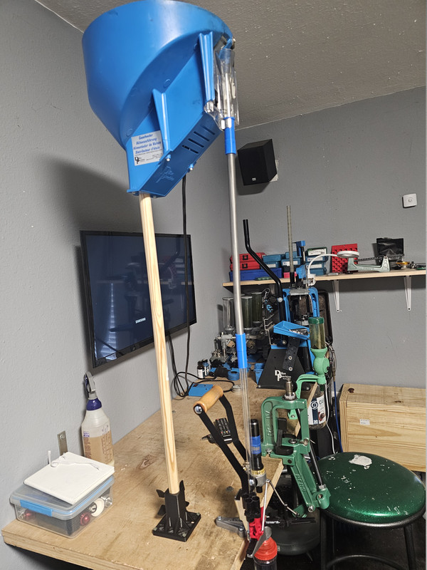

Alrighty Got the 3d printed parts up and running very much trial and error Ended up needed a longer bolt holding the case feeder to press, only 2-3 threads were avilable. So off to Lowes for 1/4x20 4in bolt and good to go now. The case adapters are a bitch and half to get off and on BUT 100% better than adjusting those 2 nuts each time And oddly if the case tube is empty, 9mm shoots out with enough force to end up on it's side. Won't do it if there is a case on top of it Also I broke one of the fingers of the decapping kit so Lee is sending a new one ![]() Got some brass tumbling right now to test it fully and see how it goes but overall I am VERY VERY happy with this press and the 3d printed parts As it sits now Attached File |

Originally Posted By craig24680: Alrighty Got the 3d printed parts up and running very much trial and error Ended up needed a longer bolt holding the case feeder to press, only 2-3 threads were avilable. So off to Lowes for 1/4x20 4in bolt and good to go now. The case adapters are a bitch and half to get off and on BUT 100% better than adjusting those 2 nuts each time And oddly if the case tube is empty, 9mm shoots out with enough force to end up on it's side. Won't do it if there is a case on top of it Also I broke one of the fingers of the decapping kit so Lee is sending a new one ![]() Got some brass tumbling right now to test it fully and see how it goes but overall I am VERY VERY happy with this press and the 3d printed parts As it sits now https://www.ar15.com/media/mediaFiles/80967/1000008901_jpg-3474721.JPG @craig24680 Can you pm me the site where you got your 3d parts for it? Also what is the total height from the very top? I would like to get the inline fabrication QD mount and the matching part for it to swap this press and my rock chucker on my reloading bench. They offer 3 different heights (no height, 4" and 7.5"). I need the total height of yours to take into account for the right size. Thanks! |
Originally Posted By Mav3rick: @craig24680 Can you pm me the site where you got your 3d parts for it? Also what is the total height from the very top? I would like to get the inline fabrication QD mount and the matching part for it to swap this press and my rock chucker on my reloading bench. They offer 3 different heights (no height, 4" and 7.5"). I need the total height of yours to take into account for the right size. Thanks! Originally Posted By Mav3rick: Originally Posted By craig24680: Alrighty Got the 3d printed parts up and running very much trial and error Ended up needed a longer bolt holding the case feeder to press, only 2-3 threads were avilable. So off to Lowes for 1/4x20 4in bolt and good to go now. The case adapters are a bitch and half to get off and on BUT 100% better than adjusting those 2 nuts each time And oddly if the case tube is empty, 9mm shoots out with enough force to end up on it's side. Won't do it if there is a case on top of it Also I broke one of the fingers of the decapping kit so Lee is sending a new one ![]() Got some brass tumbling right now to test it fully and see how it goes but overall I am VERY VERY happy with this press and the 3d printed parts As it sits now https://www.ar15.com/media/mediaFiles/80967/1000008901_jpg-3474721.JPG @craig24680 Can you pm me the site where you got your 3d parts for it? Also what is the total height from the very top? I would like to get the inline fabrication QD mount and the matching part for it to swap this press and my rock chucker on my reloading bench. They offer 3 different heights (no height, 4" and 7.5"). I need the total height of yours to take into account for the right size. Thanks! @Mav3rick as mine sites with the 3d printed case collater, 22.5 in from top to table top WITH the lee QD system https://cults3d.com/en/3d-model/tool/lee-app-acp-universal-case-feeder-a2chrzz Bought from this guy, not mine and I don't get money/kickback - It's a game changer for sure, set the pilot for one length and GTG I would recommend getting a longer 1/4x20 bolt, say 4in to ensure you have plenty of room as factory one is VERY tight |

Originally Posted By craig24680: @Mav3rick as mine sites with the 3d printed case collater, 22.5 in from top to table top WITH the lee QD system https://cults3d.com/en/3d-model/tool/lee-app-acp-universal-case-feeder-a2chrzz Bought from this guy, not mine and I don't get money/kickback - It's a game changer for sure, set the pilot for one length and GTG I would recommend getting a longer 1/4x20 bolt, say 4in to ensure you have plenty of room as factory one is VERY tight @craig24680 Thanks! Appreciate your help! |

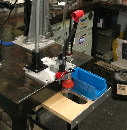

Originally Posted By SG55xdude: My case feeder is adapter is supposed to be here Saturday. This pic is from the ebay ad that I cropped. They have their app and case feeder mounted to a metal plate as seen in this Pic. Ive read someone else saying mounting the app to a metal plate will help it be more rigid. Is there really any benefit to this? My reloading bench is very solid with brackets attaching it to the wall studs. Is it really going to matter whether its bolted directly to the wood bench vs adding a plate. Im not sure in my head how the plate would matter much. Im just trying to decide if I want to buy anything else for it for mounting purposes or not. https://i.postimg.cc/rmP8NchT/s-l1200.jpg If your bench is properly constructed the plate will not help much. There shouldn’t be much flex if you only decap or sewage. |
Free men do not ask for permission.
I can't imagine a metal plate adding anything if the bench and top are rigid. That example picture has a very thin bench top so maybe the metal plate helps. I use 2 pieces of 3/4" plywood glued together for the bench top along with a Lee Bench Plate mounting system so it's easy/fast to switch out the press being used. It adds a little bit of flex because of the mount design, but not enough to be a problem using the APP or any other press I have. Having Dillon case feeder swaying back and forth would probably cause a problem. You just need to make sure the mounting rod is securely mounted. I can't imagine why a large metal mounting plate would be necessary unless you want a system for swapping out the press easily. |

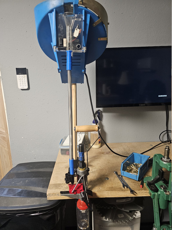

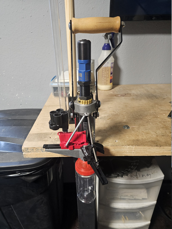

| I got my dillon case feeder adapter today so I mounted the press. I have been running around so im resting and looking at the instructions at everything. I gotta say the instructions suck. I think i can figure everything out but they didn't put much effort in the manual. Mainly i plan to get the case feeder hooked up and working right today. |

I just made it where I didn't have to trim the spring or stretch it out. If I find it has problems ill shorten the dowel, tube, and spring. I may just trim the tube and dowel at some point I just wanted to throw it together to see how it works. |
