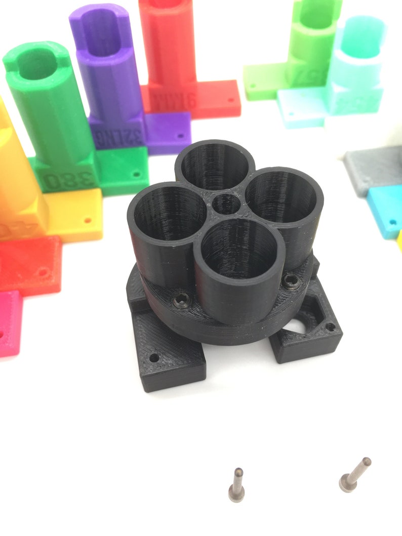

Anyone able to help with one of these Universal Case Feeders for the APP?
Link to Product on Etsy
Having some issues with getting the case feeder part that attaches to the press (black part) positoned with the bolt.  I'm not able to put the bolt through the same way as the factory one so I'm a little stuck.  I got it semi attached and working but I have to adjust the position everytime I spin the tubes.
Hard to believe this guy doesn't have instructions or a video.........

My set has been sitting as I had no instructions either. In for some help.

Bumping this to see if anyone has come up with a way to attach this.  I need to decap some brass last night so I fiddled with it every time I spun the tube and yeah I don't want to do that.
I'm out of work after this week so maybe I can figure something out while I look for another job and try to get my entire disaster of a house spruced up.
Mine looks similar to those. Looks like you would have to take it apart and drop the long threaded 1/4" bolt in from the top. One jam nut all the way to the top of the bolt, then 2 more nuts to set the height.

The 3d printed kits that use those inserts (like posted up towards the top of this page) is exactly what I am asking about.
I have changed mine over the 9mm, as I was done with all my 45 for the moment. Just having to take it apart, reposition the bolt, nuts/height, makes for a slower caliber change.
Changing a insert and case pusher would be so much easier and faster.  Just was curious if they work well enough to get one.
I think I will break down and order one after the holiday season.
12/15/2024 9:58:05 PM EDT
I got one of those kits. It came with no instructions or pictures.
After fiddling with it for awhile, I set it aside.
If you figure it out, post it up.
