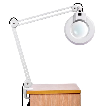

After you get a good overhead light for general lighting of your area, you could also kill two birds with one stone and get an Adjustable Magnifier Desk Lamp like this at WalMart for about $42.
Not only does it allow you to throw the light specifically where you need it, it's also great for seeing those small parts more clearly.  I use mine all the time.
7/3/2017 12:17:18 PM EDT
https://i5.walmartimages.com/asr/06cd09d6-a282-480b-984b-82af97a96fd1_1.eb68c1a2d3626b90dad003a33a8a284e.jpeg?odnHeight=450&odnWidth=450&odnBg=FFFFFF
I like that. I'm assembling ar lowers for my buddy and sometimes those little parts are hard to see.

Fluorescent lights or LED equivalents should be used overhead to establish your ambient light level.  Use the fixture shown above, for specific tasks/locations.
