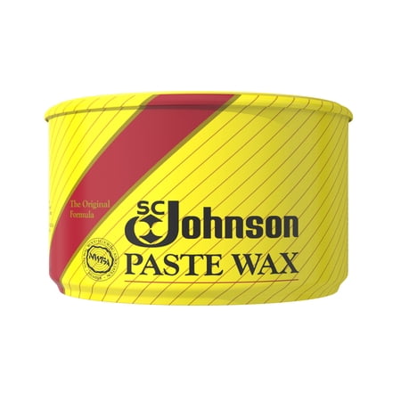

One last thing, and you did not state what dies are in play.  If lee, or some other less expensive type, pull them apart and start polishing.   When you go to put them back together, a light coat of Johnson paste (with the excess polished off) was will keep the parts from rusting.  It also does wonders when its used on the powder dispenser parts instead of any oil/grease lubes as well.
