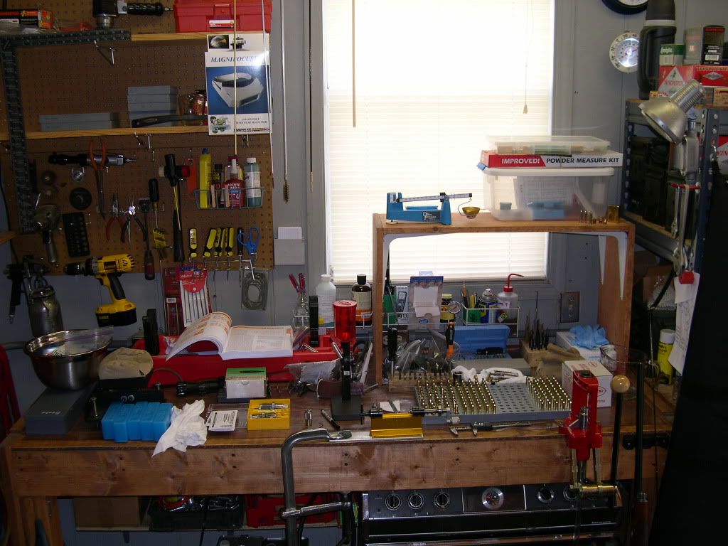

Here is a pic I took of my train wreck of a bench while trimming some 223 yesterday. I have the trimmer mounted to a strip of aluminum that I clamp to the edge of the bench.  I put a trash can in the floor under the trimmer to catch the brass shavings.  When I am done trimming I unclamp it and store it in the rubbermaid container until the next time it is needed.
