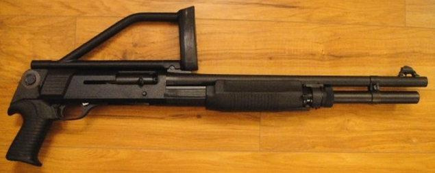

The only ones that I know of off the top of m head are the Saiga 12's, and one version of the Benelli M3. The common Benelli M3 has the recoil spring like the Remingons, bu here was a rare top-folding stock that was made at one time. These have the recoil spring around the mag tube if I recall correctly, very similar to what Home-Invader was talking about. These are hard to come by, and are bringing in top dollar.
Here is a pic of the Benelli M3 Top-Folder:
