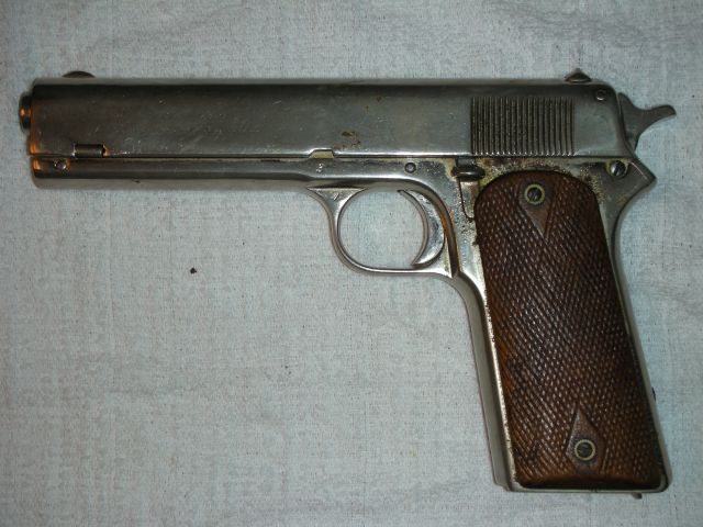

Well, she's not the most sexy thing I've brought home, but I picked this up today....  A 1905 Colt .45 Rimless/Smokeless s/n 3xxx.

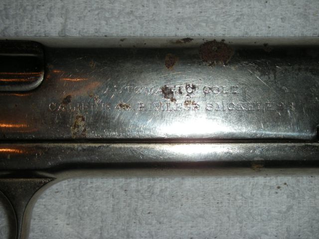

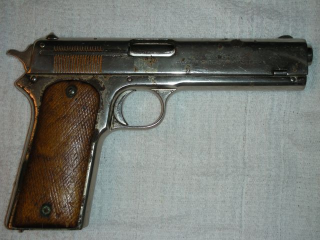

Things I've noted so far include the pony stamp on the slide at the back left, the patent stamps, Hartford stamp, triangle proof with a "T" inside, an original grip on one side and handemade on the other, a totally worn out bbl and no mag.  It's sitting in a bath of BreakFree right now as I can move the slide back about 1/16", but can't release the front button under the bbl to release the weird slide catch pin.  We'll let it soak overnight and see what happens.  It's been nickled (argh) and I was told it's been a paperweight on a desk since about 1978.  I'm hoping I can get the old girl back in firing condition....
Any ideas on getting the slide to release?  Manual says to press the takedown plug which allows the slide lock to release.  Just nothing happening right now.

Next up - A previous owner had it nickeled or chromed so some of the stampings are covered over, and barely visible.  Should I just accept the fact it's now nickeled, or can the nickel be reverse-removed?  And then, should that even be attempted?  Is there a greater chance of screwing it up for removal vs leaving it as is?

OK, so it's been sitting in Liquid Wrench for a few days now, but I still can't get the takedown plug to move.  I went to the autoparts store today for Marvel Mystrey Oil and all they had was a red bottle that appeared to be a fuel additive.  Is this what 'yall are referring to?  It said for gas or diesel engines, red bottle, black lettering.  Just wanted to make sure before I dropped the gun in it.
I'm also guessing after some close inspection that the gun was at some point taken apart, and the major components like the trigger, receiver, slide, take down plug and hammer were nickle plated, then the gun was reassembled.  All the parts that I can see INSIDE don't appear plated and they all seem to be there.  That leaves me to believe the take down plug that is giving me fits was plated, then forced into the receiver that was also plated and the clearances are now way too tight, thus the take down plug won't move at all.
Would some heat applied to the receiver mass (maybe 200*F or so) be hard on the receiver or existing nickle?  I was thinking about applying some heat to open it up a bit if it'll move, or at minimum, if corrosion has bonded the take down plug to the receiver, allow it to break free.
My long term plans are to get her open and cleaned up, then look into removal of the nickle finish and a reblue.  And it's a 1909 date of manufacture 35xx.
Thoughts?????

Today was an excellent day!  I took the gun over to a friends house who is somewhat of a 1911 guru with a lot of the 1903/1905 variants in .380, so he knew what he was looking at, just bigger.  It's been sitting in Liquid Wrench for several days and was dried best we could get it with a towel.  He simply took a 3/8" wooden dowel about 1-1/2" long and a little mallet and banged on the take down plug a few times and it moved enough to slide out the slide release bar.  Once that was out, he tugged a bit on the slide and it came off to the rear.  All it's internals seem to be there too.  Then, with he drove out the two barrel pins and the barrel came off.  However, the guide rod and spring remained in place with the take down plug so he just tapped it out from the inside since it was accessible with the barrel off and it came out.  With a few minutes of light filing to remove a tight spot of nickle plating on the take down plug, it went back in slick as a whistle.  We took it apart and reassembled several times with no problems.  Our best guess is whoever nickle plated it stripped it as I guessed, plated then reassembled.  Since the plating process added thickness to the receiver and take down plug, when it was assembled, well......  it got stuck and that's where it's been for the past 30 years - stuck.
Here's what she looks like today:
I also noted in pencil a persons name and "Holly Hill, KY" with the date of 1/6/48 written on the handmade replacement grip.  (the one on the left in the pic)  I'm starting that search now to see if they are still alive or if anyone knew/knows him.
Finally, I looked on Triple K's site and they have a 7 round M1905 magazine for $34 so that's next.  Well, and a letter to Colt to see how it was configured, who it was shipped to and when.
Stay tuned......  Next up is my decision on what to do next.  Either 1)keep it like it is, or 2) send it to Turnbull.
