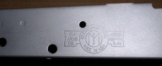

Campy, is it true the OOW receivers need to be fully heat treated before assembling into a AK?
12/24/2003 5:21:33 AM EDT
From the picture that they have one their website, it looks to me they we treated, but they need to be finished either parkerized or blued.
you see all that discoloration? Thats from being heated up (I hope that's not rust).

OOW receivers are heat treated ONLY around the big holes.
Here's what an OOW receiver that's been properly hardened by AK-USA looks like:
12/24/2003 6:57:44 PM EDT
www.kythri.net/pictures/oow-ak74-akusa-heattreat_1.jpg
www.kythri.net/pictures/oow-ak74-akusa-heattreat_2.jpg
www.kythri.net/pictures/oow-ak74-akusa-heattreat_3.jpg
www.kythri.net/pictures/oow-ak74-akusa-heattreat_4.jpg
How long was your turn around on haveing that thing heat treated? AK-USA has had mine about a month and Im very ready to get it back.
12/24/2003 7:07:36 PM EDT
Wow, my turnaround time was about 2 weeks or so.
Call Chris and see what the hold-up is.
12/24/2003 7:16:50 PM EDT
Thanks kythri.  I emailed him a couple of days ago and he said he was waiting for them to get back from the heat treater. So I guess I'll wait a little longer.
