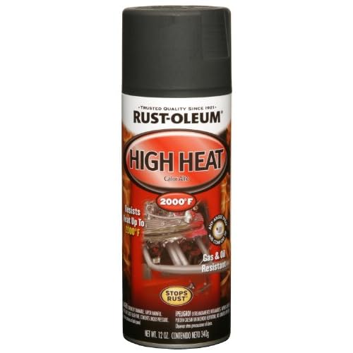

It really depends on how nasty the wound is.
I've tried the "pen"...it's paint and it sux for matching park or ano.
We've all tried Sharpie...temporary.....color is off and can sometimes look purplish.
The sh!t that I've used with success for small scratches is B-C Aluminum Black.
That's the best I've found for small scratches.
It's a clear (blue tint) liquid that chemically stains raw aluminum.
You can even apply it with a toothpick following the scratch.
For reference, I just did some work on an FSB that would have needed a re-park.
Instead I rattle-canned it with this.
Looks just like park....too early to tell about endurance, but so far so good.

The rattle can paint I tried on mine wipes right off with hoppes 9.
2/24/2013 5:02:32 PM EDT
They're not all equal.
I'm hopin' "Gas & Oil Resistant" means something. (see label)
No reason to put anything on it but oil, anyway.
Harsher stuff goes in the bore.
