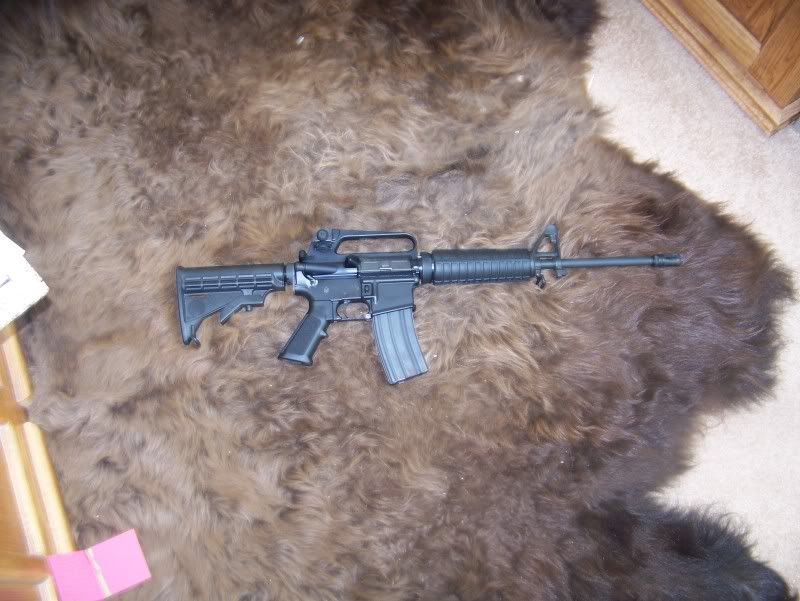

Here is my lower that I finish with a dremel, I have one of those presses and didn't use it, I don't think I could get it high enough. I just ended up using the router attachment so it could ride along the sides of the lower.
http://img.photobucket.com/albums/v412/bobalouy/80ar-5.jpg http://img.photobucket.com/albums/v412/bobalouy/80ar-2.jpg |
Here is my lower that I finish with a dremel, I have one of those presses and didn't use it, I don't think I could get it high enough. I just ended up using the router attachment so it could ride along the sides of the lower. http://img.photobucket.com/albums/v412/bobalouy/80ar-5.jpg http://img.photobucket.com/albums/v412/bobalouy/80ar-2.jpg That looks quite good, how long did it take from solid to complete FCP? |
Here is my lower that I finish with a dremel, I have one of those presses and didn't use it, I don't think I could get it high enough. I just ended up using the router attachment so it could ride along the sides of the lower. http://img.photobucket.com/albums/v412/bobalouy/80ar-5.jpg http://img.photobucket.com/albums/v412/bobalouy/80ar-2.jpg Wow, I have to admit that i some pretty impressive machine work for having been done with a Dremel! |
