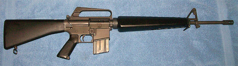

Here is a pic of mine.
http://i13.photobucket.com/albums/a282/glazer1972/P1090003.jpg
Ugliest couch I've ever seen.  No wonder you keep it outside near the JungleGym.
I've got the same thing in 5.45.  I'm still not able to decide if I should cut it down to 16+ inches just to make it more comfortable for offhand shooting.  Anything passed 16", my groups start to get wider too fast without a bench rest.  I don't know if my shoulders will lit me shoot a long barrel anymore.

Glazer: Really like your build, looks like a good shooter. Is that a free float barrel?
Yes, it is freefloated.  Daniel Defense Omega 12.0.
