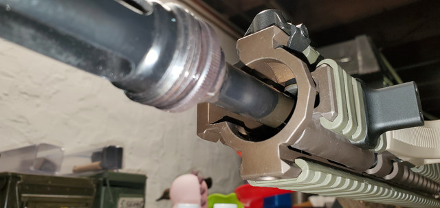

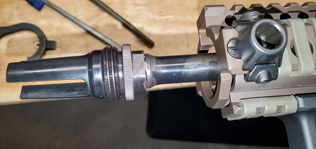

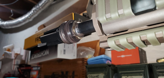

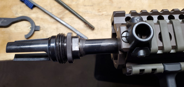

Hey, this is an old thread, but I have a question directly relevant to this. I have this Colt barrel with a permanently attached flash hider. It was attached to using the brazing method with 1100+ degree silver solder.
There is notable discoloration and what seems to be paint used to refinish it. I'm okay if it's just ugly, but noticing the gaps around the flash hider and the discoloration makes me worried about potential damage to the barrel or not meeting the legal standard.
To test, I tried to remove the flash hider, and it seemed pretty secure. Is there any risk to my barrel, the heat treat, or anything else? Or if it's just ugly, is it pretty much good to go? What do you guys think?
Note: I will be using this with a suppressor, and without.
2/27/2021 4:42:46 PM EDT
[Last Edit: s4s4u][Edited] [#9]
As long as there isn't any obstruction, send it.  I'd check with a rod after threading on the suppressor.
