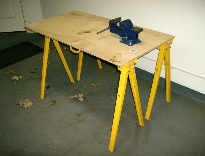

I'm sure there are as many approaches as there are gun nuts on this site. My two car garage is precisely that, no fat chicks included. So the metal sawhorses here allow me to fold the whole thing up and get it out of the way, but it's plenty sturdy enough for barrel wrenching.
Yes, I know I really should sweep up.
