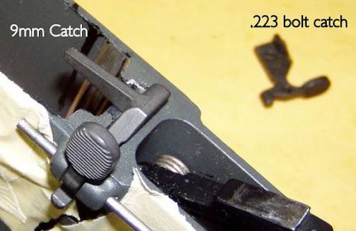

Hahn offers a top loading, bottom loading as well as a dedicated block  (you need to remove the bolt catch to install it).
Both the hahn bottom loader and dedicated block will have last round
bolt hold open using a standard .223 bolt catch. The top loader requires
a long finger 9mm bolt catch to engage last round bolt hold open. This
dedicated 9mm bolt catch does not work with a .223 upper. You have a
choice with a top loader, you can ether use the 9mm bolt catch and have
BHO and it becomes a dedicated 9mm lower, or use a .223 bolt catch and
have no BHO (but a swappable block without tools).
