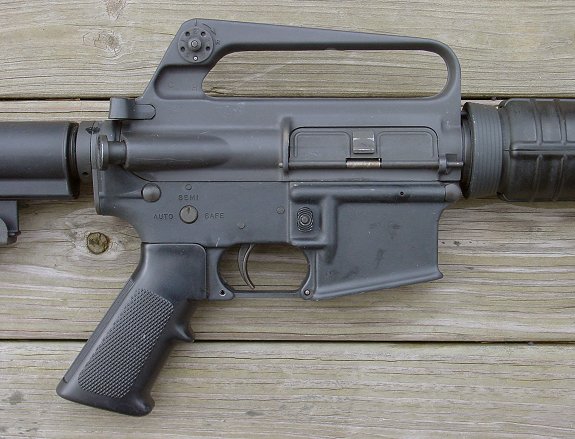

Pretty straight forward really; here's an M733 with the A1 configuration:
Here's the variant with the brass deflector.
Here's the M933 Variant with removeable A3 Carry handle.

I would venture to say its not so simple.  The first one is an A1/A2 config, while the second is the later A1/A2 (possibly A2/A2) with case deflector.  They both look like they have A2 FHs as well, and the first one sans case deflector has a round forward assist which is also an A2 feature.  Both have 3rd gen stocks, not the 4th gen stocks found on current Colt production guns (and what should be featured on both of the members of the Enhanced Series - the 738 and 938).  The first one looks like a mid-production gun while the second one looks like a late (not current) produciton gun.  That 933 is also an early 933 because it lacks the 4th gen stock.
The first one has a bird cage flash suppressor, you can tell because it uses a lock washer rather then a peel washer.
First one is mid 1980's, middle one is late eighties or early 90's.  And like you said, bottom is not a 733.
