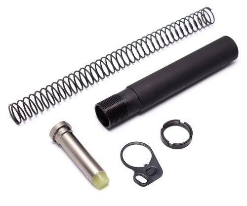

Since I built my AR pistol I have found some things about AR pistol buffer tubes so I want to post this thread to help those that are planning on building AR pistol and may need help deciding on what type of tube they should go with before spending their hard earned money and then not what they are after.
For those that don't care to use SB15 then you have few choices like Phase 5, PWS, KAK, few other no name brands that probably same manufacturer that built for Phase 5.
Then for those that plan on using SB15 or similar products then best to go with Spike's, KAK, Guntec, RRA, and few other no name brands out there.
I went with Phase 5 and found out if I wanted to use SB15 I will have remove the form from the tube in order to fit it but I don't want to remove the form so I may just get KAK buffer tube for $32 and swap it out.

the foam comes off the phase 5 very easily. but it's still a pita to get on the sb15 because it's a large diameter.
the rra tube fits better in the sb15 but gets really hard to push on around the textured area.

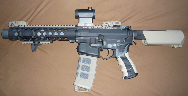

Hell, I've got a CAA Saddle on my SB15. They're lightweight plastic & will fit nearly anything.
pictures??
Picture of the ass end:
The whole thing:
I kinda like the look of the straps, but you can mount the saddle with the Industrial Velcro you buy at the hardware store. The stuff works great & it'll stay put, as long as you prep the surfaces properly.

Why run a sig brace on an SBR like that?
Nevermind.. the OAL is long enough I see now

I though the for grip was a no no?
12/14/2013 6:49:29 AM EDT
It's okay if your OAL is 26" or more. Mine is just over that, using a Vltor A5 receiver extension & an 11.5" barrel.
