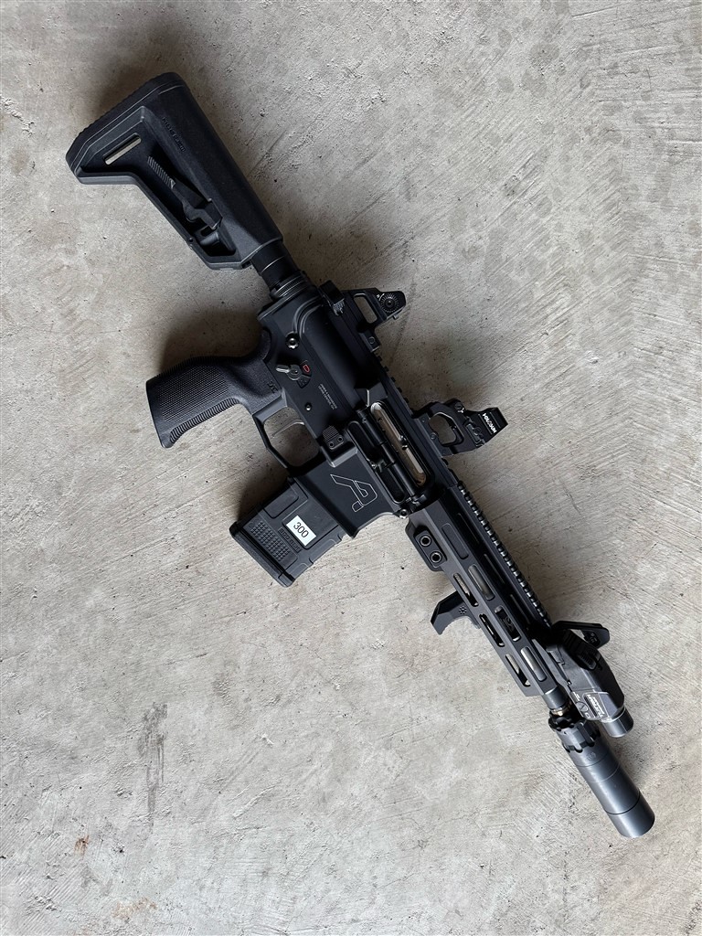

New 300 BLK PMAGS just arrived, MOE SL-M buttstock ordered. Even if it doesn't collapse any shorter on the mil-spec std length RE, it looks good to me. Plus, it's a tad lighter than the SL-K.
Why aren't mfg's making shorter tubes to take advantage of these stubby stocks? Look like a lost opportunity to me. And stubby buffers & appropriate springs too. Every one and their brother is doing short / PDW setups. Magpul, are you listening?
I know folders are all the rage, but someone besides me has to have a "want" for these...
Carry on.

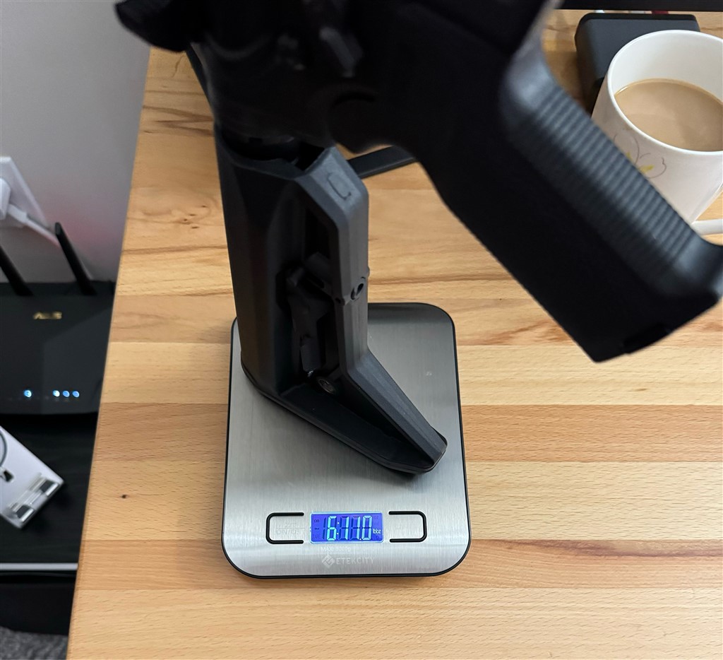

New Rugged fixed piston spacer, Streamlight TLR RM-1 WML, also decided on a new style Arisaka finger grip. And, swapped back to Magpul MOE-K2 pistol grip.
Now @ 6lb 11oz with empty 20rnd mag.

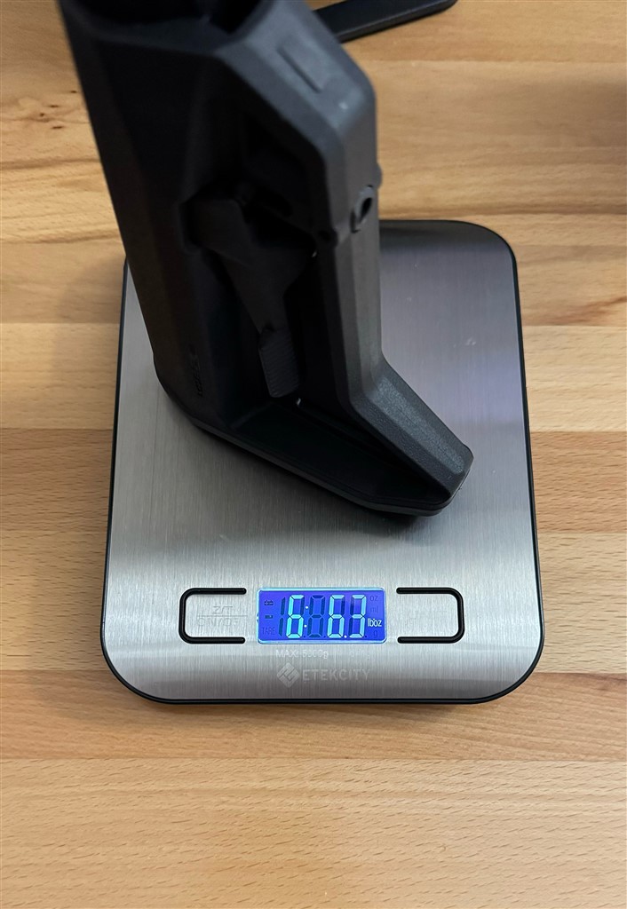

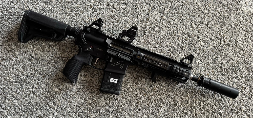

MOE SL-M stock on. A little loose compared to the SL, they don't have the internal metal retention springs to help with a tight fit on the tube. No room for them.. Still, I like it.
Lord help us all
10/29/2024 1:54:40 PM EDT

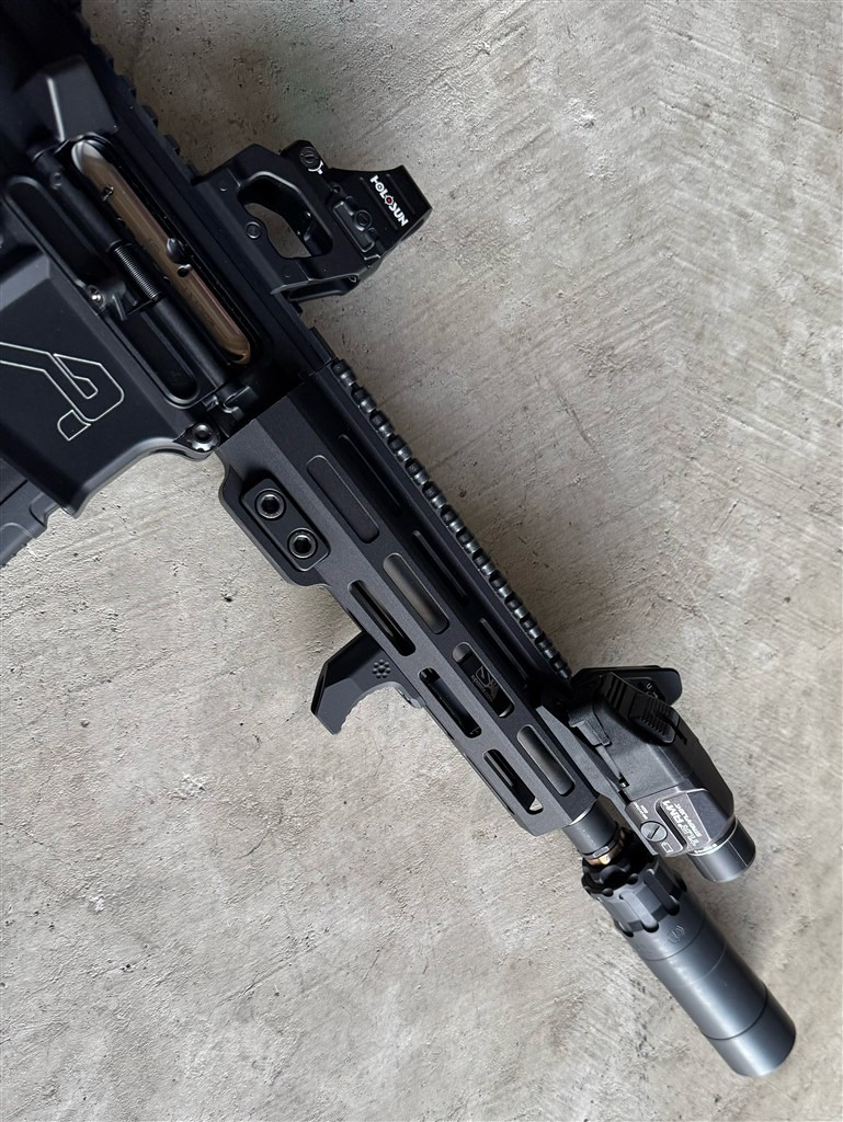

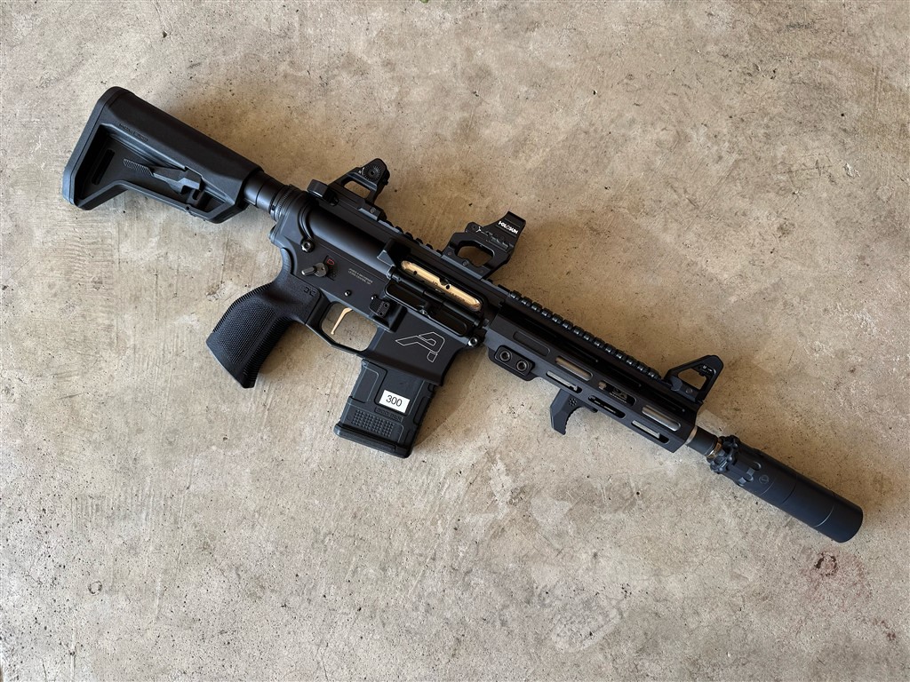

Better light. Changed back to the Driven Arms grip, swapped in a Magpul extended mag release button (had in the spare parts, forgot all about it.)
Without the can, it's a short one no doubt. I really like the MOE SL-M buttstock. Even if it's a bit loose (compared to the SL, which are super tight on the tube.)
Next up, KAK rail when it gets here later this week. As much as I like Arisaka goodies, I'm just not dig'n the handstop I ordered. I ordered another Emissary Development Handbrake for this one. I've got them on the 10.5" & 11.3" builds and really like'm. So.. why not.

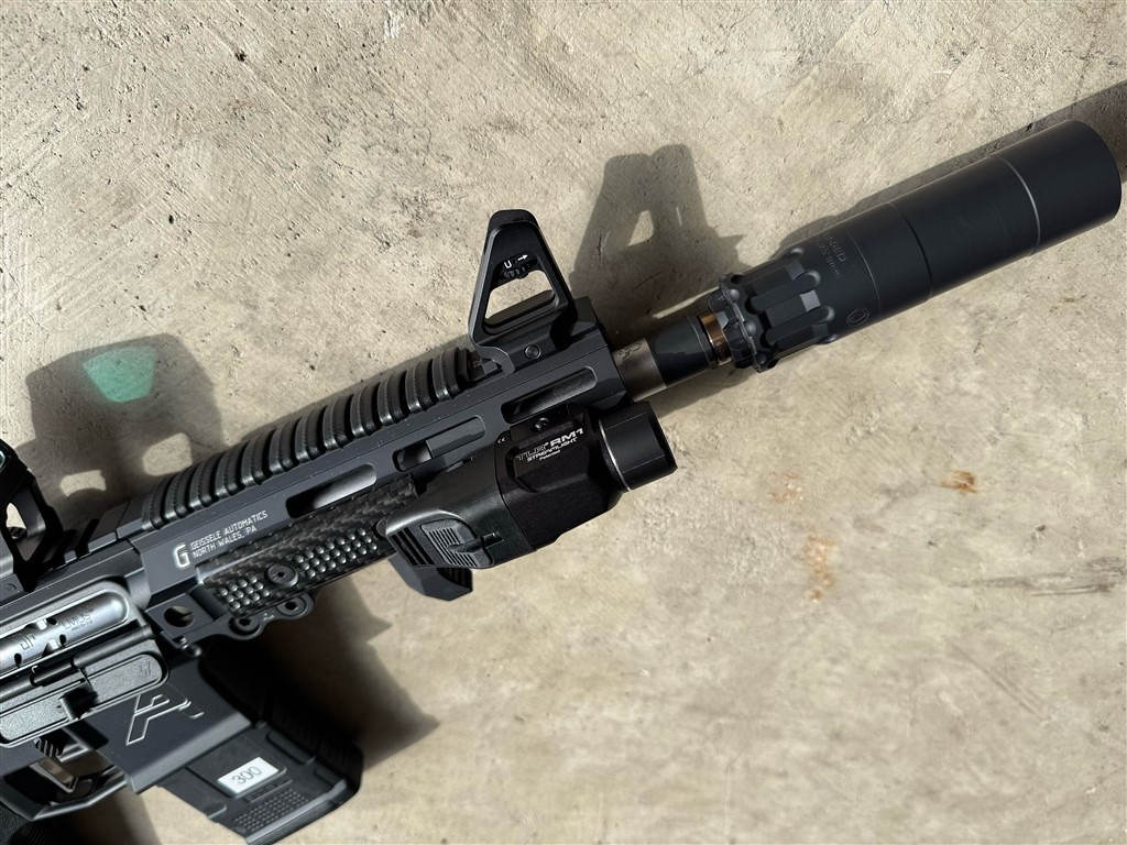

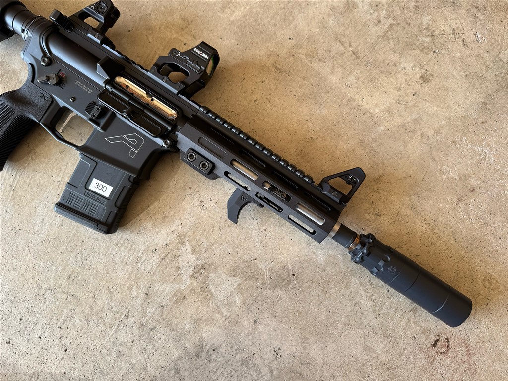

Well, new KAK rail came today, and it's on. Didn't really save much weight, but I like it none the less. 2 things that I needed to do:
File a slight amount from the tiny ant-rotational tabs that interface the upper receiver. Should NOT have needed to do that, but I did. No big deal
Time the barrel nut. They should come out and tell you it needs done, but they don't. It's the way the cross-lock blocks interface with the barrel nut. No real big deal, but again TELL US it needs done!
Grand scheme of thing.. who cares, it's on. I like it.. nice and slim with loads of M-LOK slots to use for whatever. I just ordered some RailScales polymer "mini-dot" M-LOK covers for the sides (2.5 M-LOK slots.) I've also got a Magpul cantilever mount for the WML coming today too.

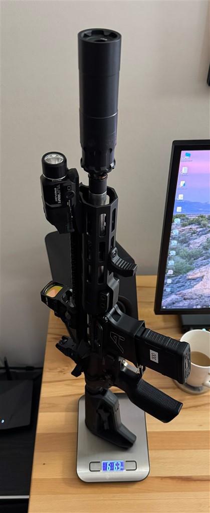

As she sits right now, 6lb 2.5oz with can and empty mag. It feels a bit heavier, but numbers don't lie. Chicken Dinner.

WML cantilever mount came in, light mounted. 6lb 6.3oz w/can & mag.. Schwing
I did opt for the polymer version of the Magpul WML mount. Should work fine for this, if it was a battle riffle I'd go aluminum.

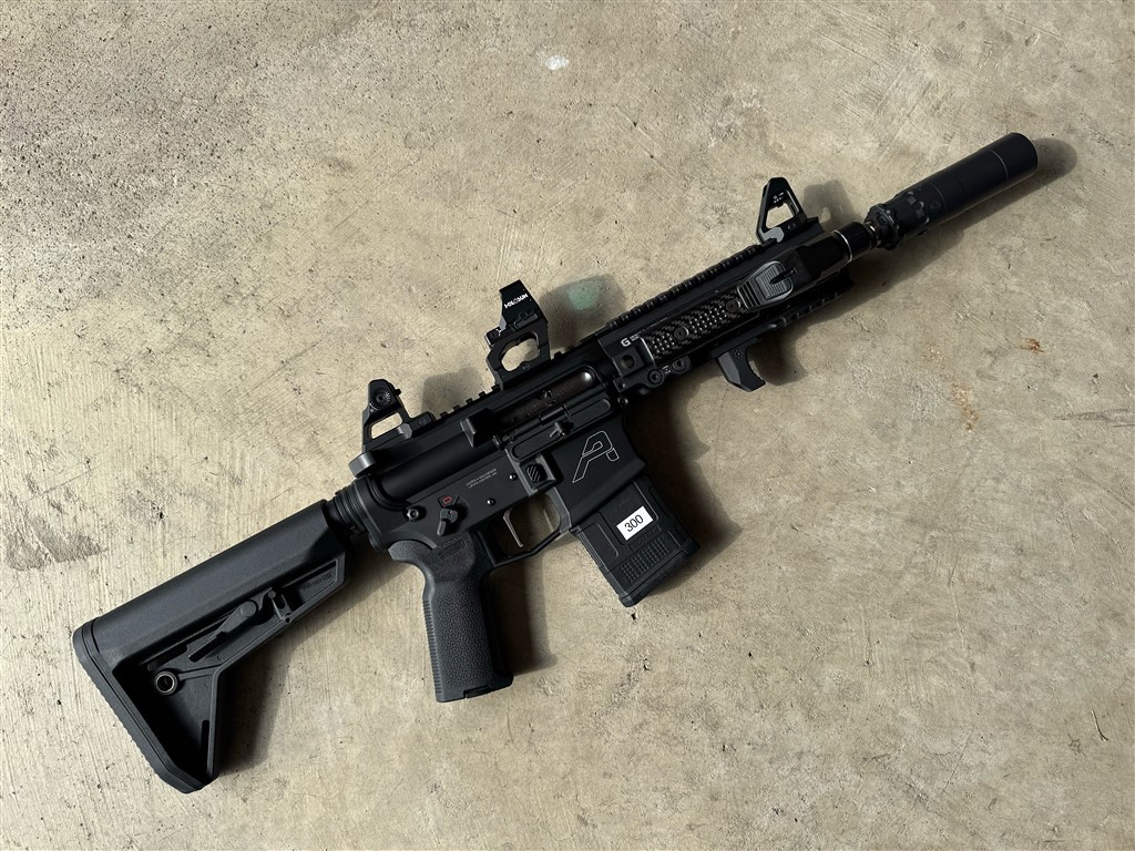

Now shods Arisaka 300 series WML body & offset mount, Malkoff head and Surefire clicky. Perfect. All in all, still a touch under 6.5lbs with empty mag.

Suppressor mounting system now on point.
Griffin Plan A taper mount mini flash hider in Ti
Griffin Plan A Alpha hub mount for the Obsidian 9
Lord help us all
11/23/2024 9:10:11 PM EDT
Originally Posted By spyderboy03:
Looks nice! How big is that gas port? I just ordered a BRT tube for my Noveske. The 8.5" Criterion Core I had was definitely gassed better.
@spyderboy03
I just measured mine with a drill bit index - 3/32 bit fit, so 0.09" rough size.

11/23/2024 10:20:37 PM EDT
Originally Posted By ar556223:
@spyderboy03
Thanks! Sounds appropriate about right. My BRT tube is a .093 which makes it equivalent to a .091 gas port, and it runs great. Could still be considered over gassed with suppressed supers but I do want it to be able run subs when suppressed as well on occasion.
11/23/2024 11:16:04 PM EDT
Nice build . I'm prone to copy that .
11/25/2024 6:33:05 PM EDT
Thanks brother. Labor of love, no doubt. 😎

12/2/2024 10:58:27 PM EDT
https://media.fotki.com/2v2ZuVUV3x9T3R.jpg
https://media.fotki.com/2v2ZuVUmzx9T3R.jpg
That build looks really nice with the new suppressor mount, kudos!!
