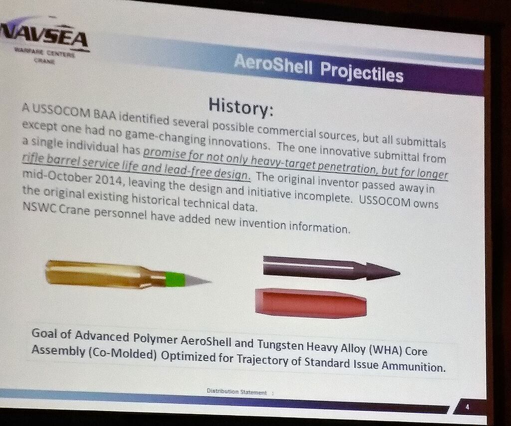

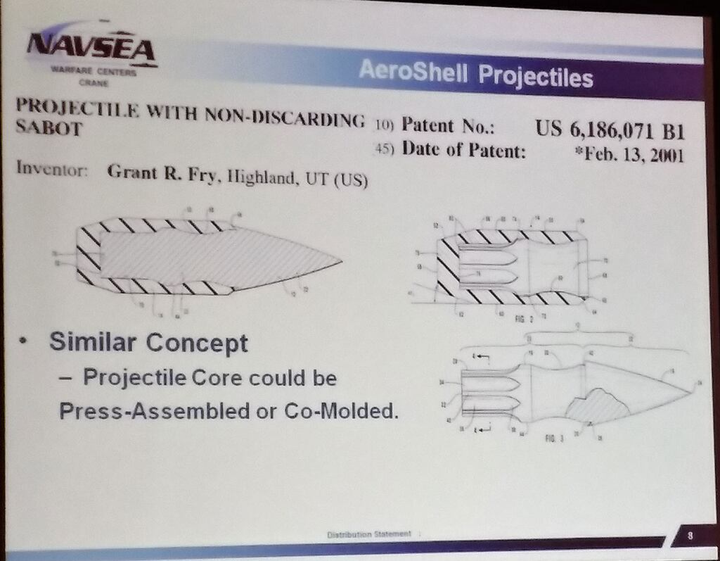

Originally Posted By banzai70:
What about a polymer jacket instead of a copper one? One that wouldn’t fragment on impact.
Regardless, The future looks interesting
This was being looked into under the 'Aersoshell' concept. Sadly this is the only public refference to it I have found. But it seems like it would be superb for AP loads and potentially cheaper.
I also suspect the new PXT rifling would make it more viable, to cause less damage to the polymer jacket.
Biggest potential issue is a ballistics guy I know said they differences in density between the core and the exterior jacket might effect accuracy; no idea if this is true.
https://www.militarytimes.com/off-duty/gearscout/kit/2019/06/11/socom-wants-a-new-armor-piercing-sniper-bullet-heres-one-option-engineers-are-developing/
I've also thought we could see solid steel bullets with polymer driving bands, as currently used in Autocannon ammo. Shown in this slide, projectile with yellow polymer bands:

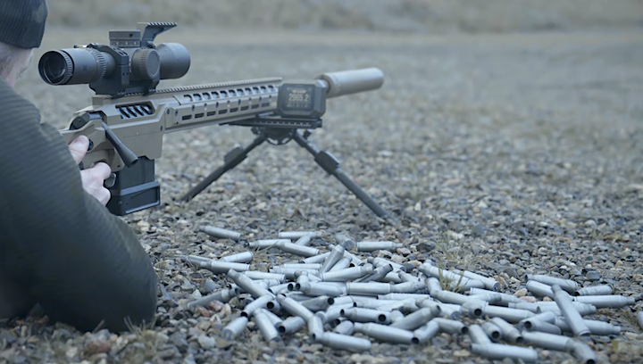

Seekins is also developing a High Pressure barrel similar to the PXT:
-Progressive rifling 1:100-1:9 ala PXT
-Rounded barrel rifling (also similar to PXT)
-GBN200 advanced barrel steel
-New type of coating
-Plans to open source the tech for other companies
https://gunsamerica.com/digest/seekins-barrel-technology-high-pressure-rifles/
Exclusive Interview on Seekins Precision's New Barrel Technology
Demonstration shows .338 Norma using Federal PEAK alloy cases firing 300gr @ 2950fps.

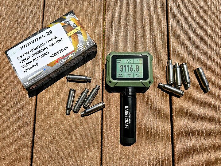

Start your engines, the High Pressure Age is officially upon us - Federal releasing 6.5cm PEAK @ 80kpsi, and is saying its safe for nearly all factory rifles (although a bit vague on AR10 compatibility).
Still, I strongly suspect we'll be seeing 5.56 PEAK released soon if this proves a success.
https://www.thefirearmblog.com/blog/tfb-review-federal-6-5-creedmoor-peakammunition-is-it-hot-or-not-44828803
https://www.federalpremium.com/65-creedmoor-plus-peak.html

https://cdn-fastly.thefirearmblog.com/media/2026/06/05/06015/post.jpg?size=720x845&nocrop=1
In context to this specific 6.5CM + PEAK ammo.... I sent a e-mail to Geissele asking if their MRGG is able to "use" this ammo.
Federal recommends it is suitable / approved in only firearms "approved" by  the various manufactures.
"So far , everything I have read says “maybe” in context to 6.5CM semi auto firearms… “Federal advises AR-10 users to consult the individual rifle manufacturer for recommendations on compatibility with higher-pressure ammunition.”
I understand the higher 80K in a S/A would certainly need a Adj. GB to help mitigate cyclic issues , and probably need to adjust the “buffer” setup. ( weight recoil spring strength, and buffer weight )
I also understand that this round would likely accelerate barrel wear. And possibly be “harsh” on the bolt lugs.
How much ? Who knows so far... but I am curious.
It was suggested by Federal that "G" has done semi auto testing with it.
I will also ask if the MRGG would be Ok without a "steady diet" of it , depending on their answer.
The added 300FPS is alluring.
