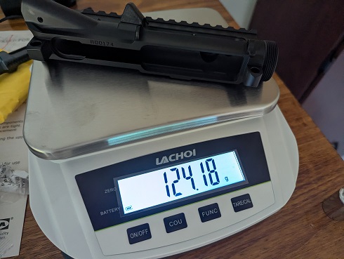

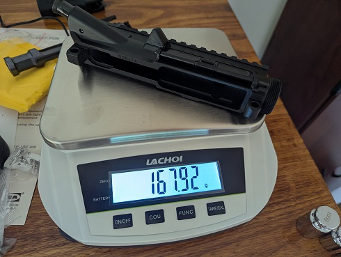

So I got my Roam R-15 upper.
Advertised weight was 5.8oz with the FA and dust cover installed.
My weight was 167.92g (5.92oz)
Stripping the FA and dust cover advertised upper weight is 4.3oz.
My Weight was 124.18g (4.38oz)
Normally converting to a slick side will reduce the weight by ~17% from what I've seen on before/after weights.
However the shell deflector for the Roam Upper is a polymer insert so the reduction wouldn't be as significant.
Depending how the rest of my build goes, I may go for the FA delete option anyway to hit my goal.

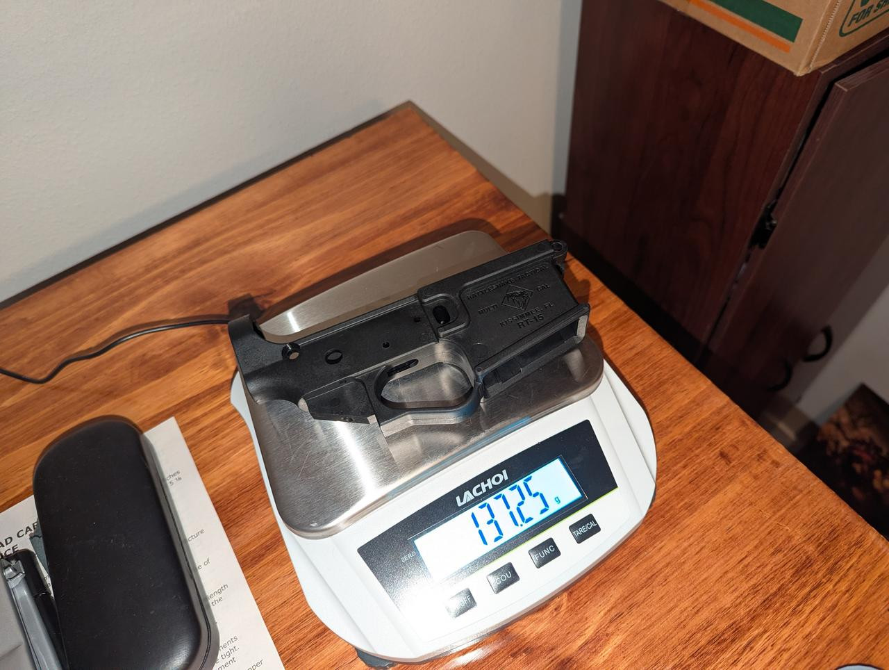

Saw in the ultralight weight picture thread that someone mentioned getting an RT-15 poly complete lower from Rattlesnake tactical. I bought one and did a teardown and weighed every component. The table below includes my measurements
ItemWeight (g)Weight (oz)
RT15 Poly Complete Lower Receiver697.2424.59
Stock206.67.29
Stripped Lower137.254.84
Buffer85.143.00
Grip73.862.61
Buffer Tube57.762.04
Buffer Spring51.831.83
Castle Nut16.600.59
End Plate14.470.51
Bolt Catch and pin11.370.40
Hammer and Spring9.560.34
Pistol Grip Screw and lock washer7.290.26
Trigger and Spring7.250.26
Trigger Pins4.060.14
Safety3.110.11
Mag Catch2.340.08
Takedown pin, long1.450.05
Takedown pin, short1.220.04
Trigger Disconnector1.210.04
Buffer Retainer and spring1.190.04
Mag Catch Spring0.670.02
Mag Catch Button0.630.02
Safety Detent and spring0.550.02
Takedown pin detents and springs0.50.02
Bolt Catch spring and plunger.190.01
