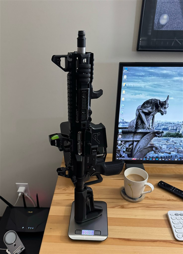

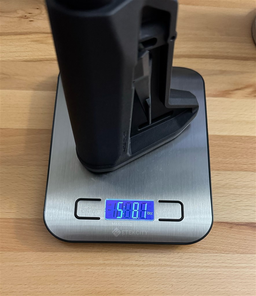

I know it's kinda cheat'n with a shorty (8" 300 BO build,) but it's worth posting. I'm not quite where I'll finally be as I'm swapping the G MK4 7" rail to a KAK 7.2" tomorrow. It should save some weight.
Anywho, at 6lb 4.9oz with my Rugged Obsidian 9 can in short mode, and an empty 20 round mag it's nice and light. Hoping the new KAK rail can offset my WML Streamlight TLR RM-1 light (not mounted right now.) But, everything else in place as it will be.
Thus far, I'm happy with it. JP LMOS BCG, KVP H2 tungsten powder buffer and JP spring. Steel SA Adj GB as well.
I know I could shave some weight by dumping the Scalarworks irons, but that's no gonna happen. They're so light and useful, they stay.

For giggles, before the new KAK rail comes in. I hadn't weighed this without the can & mag. 5lb 8.1oz
Again, I know it's cheat'n with a shorty.
But it goes to show that if you're going NFA SBR, you can keep them fairly light without spending STUPID $$$ on uber-light parts. I certainly could make it lighter, but I'm very happy with it as is.
Still, not cheap. But I've only got 3 AR15 builds, all suppressed SBR's. I haven't owned any carbine length AR's in quite some time.
Should be a bit lighter here in a few days.. we shall see what KAK brings to the table..
Edit: Just to be clear, this is a purpose built 300 BO HD gun. Subs only with the existing can.

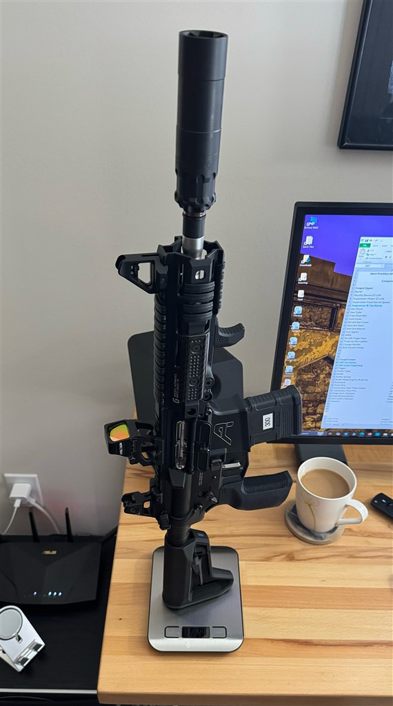

Current configuration:
Without red dot and suppressor
Rock River lower
Houge grip
G-SSA-E trigger
Aero upper
B5 car stock
Faxon 10.5” pencil barrel
SA adjustable gas block
Fostech Mach 2 rail 10”
G airborne charging handle
DSA Al BCG
Carbine buffer
Springco yellow
Lots of 2a and V7 small parts
Gemtech Trek T
Sightmark Mini shot M spec
Had it out on Saturday: it’s great

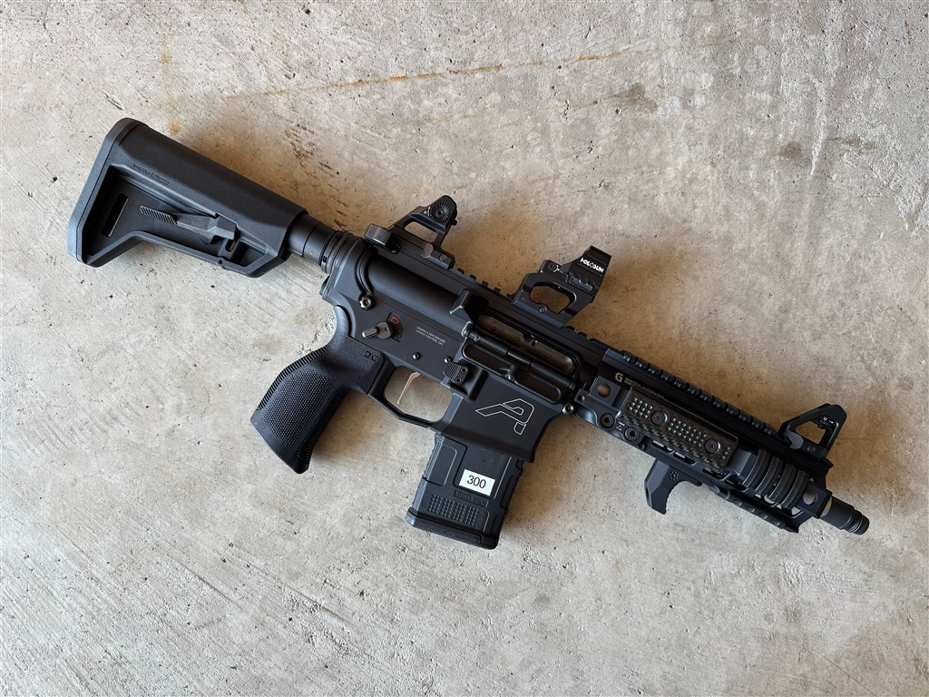

11/16/2024 3:10:23 PM EDT
Without the suppressor, but everything else configured including an empty 20 round PMAG 5lb 14.6oz
8" 300 BO build, I realize it's knida cheat'n with an SBR.. but still.
A little Ti here and there, but still H2 buffer and nothing else stupid light. Well, the JP LMOS certainly helps..
Lord help us all

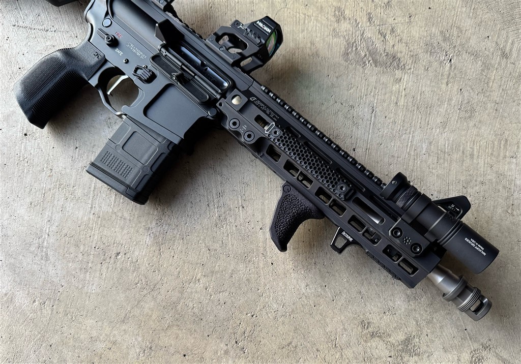

I'm currently re-configuring my 11.3" 5.56 build. It was a ~8.75lb piggy. I should have it down under 7lbs (with the suppressor) after I'm done.
It's a WC 11.3" barrel that's fairly light (18.48oz) Problem is it's built on my Mega GTR-3H billet lower, that's not light. But, I'll live with it nonetheless.
Big reason for getting these at a reasonable weight is my age, and strength level. 5 years of chronic back and neck nerve pain has me rethinking all of my guns. They need to be light, or they just don't get used.
A quest for an old fart that needs all the help he can get!
Edit: Oh yeah, all my guns run low mass BCG's (JP LMOS.) I've had great success with them for quite some time.
Lord help us all

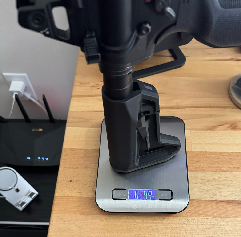

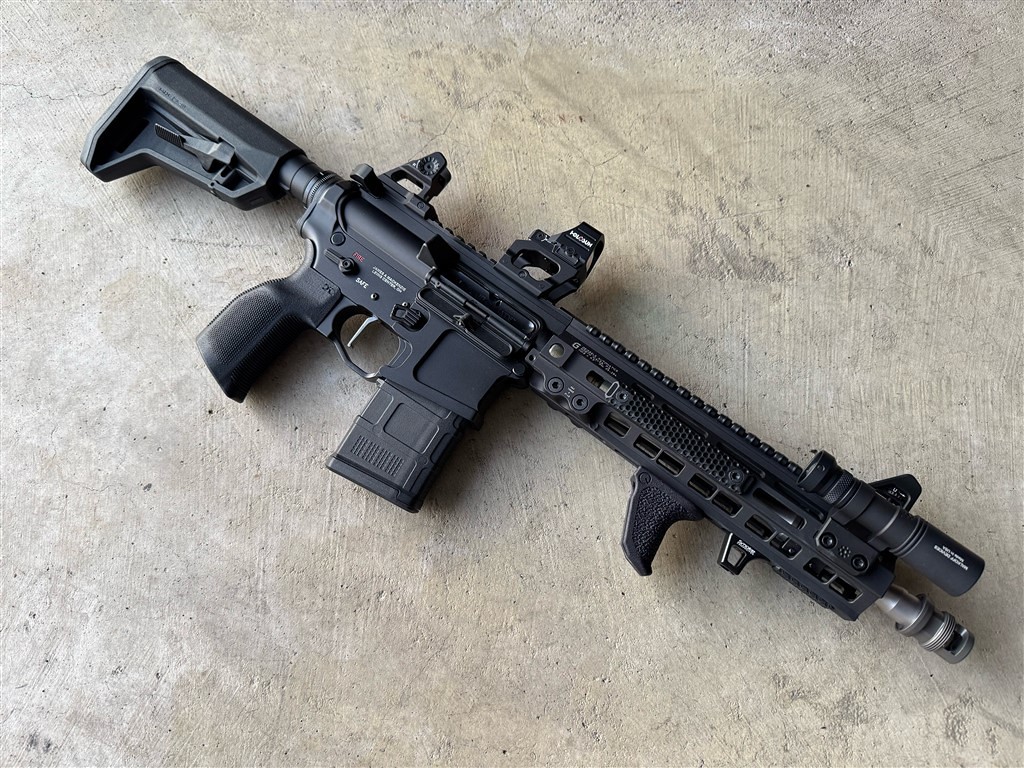

Recent reconfiguration of my 11.3" 5.56 build to drop weight. It was ~ 8.5-8.7lbs with the YHM Turbo-K suppressor. Not a bad weight, but the older I get the lighter I like them..
I was inspired to do this after the 300 BO build came out nice and light. Plus.. Black Friday prices on what I needed. Perfect.
Now at 6lb 3oz without the can mounted, that adds ~ 11oz.
Measured with an empty 20rnd PMAG. This is built on my old trusty Mega GTR-3H billet SBR lower. This is the 2nd stripped lower I bought quite some time ago, it holds a special place for me. A tad heavy compared to forged, but overall this came out great.

I forgot to post up the final config for the 11.3" 5.56 build. I ended up going with a KAK rail on this one too, just a tad lighter over the Geissele MK8.
I'll have to reweigh it, but IIRC it's still sub 6lb 3oz without the can mounted. I'm happy with it no doubt.

Was shooting for sub 3.5lbs and sub $1250 and met my goal quite nicely at 1181 total and 3.17lbs! Pic of parts list/weights/etc are below. I weighed every single part INDIVIDUALLY minus some polymer bits from the LPK being together on my "Truweigh Classic 1000g" pocket scale.
This scale is very cheap and just so happens to be SUPER accurate within +/- 2 GRAINS (1 gram is 15.4324 grains) anywhere from 10 grains on up to 100 grams, and all the way up to 550 grams with my calibration weights/checking known weight items like quarters etc and matches the calibrated scales at work too. Impressive little thing tbh, and it allows YOU THE USER to calibrate it as well if it does get out of wack, which i havent had happen in 6 years and MANY MANY weigh ins!!
not sure why the img REFUSES to embed properly, wish this site would adopt a NORMAL type of image insertion as it wont post even following the tutorials on pic posting here man WTF lol. https://gyazo.com/072c360a30fd53c684c068c49f5900a0

Originally Posted By MackDaddy1962:  Without the suppressor, but everything else configured including an empty 20 round PMAG 5lb 14.6oz
https://media.fotki.com/2v2ZuVUV3x9T3R.jpg
https://media.fotki.com/2v2ZuVUS2x9T3R.jpg
 Did you say you're running an H2 buffer w/ a lightweight carrier?

In other news...my lightweight AR sat till this weekend and somehow runs decent as is with the basic just the basic settings recommended by RCA on their key and PMC 55gr that these barrels are supposed to love. Didnt have much time to shoot so ill dial it in further but i love it so far. Under 4.6lbs with a sling and full mag of ammo with room to go lighter is excellent. When empty it feels like a toy even compared to my Nylon 66!
I don’t think it’s cheating, just a different category. We discussed having separate categories years ago but nothing came of it.
My ultra LW build started out as an SBR but they lost my application and I got pissed and canceled.
I ended up pinning and welding an aluminum extension on the barrel, now that’s a cheat!
@backbencher Sorry, I missed this one. Yup, H2 buffer & JP LMOS carrier. I've got all my SBR's setup this way. 11.3" 5.56, 10.5" 5.56 & 8" 300BO.
I do, however run them all with SA adjustable gas blocks as well. Gives me the option to tune them just right. All run 100% suppressed. I have no desire to run them loud.
I don't know, it just works for me anyway..
