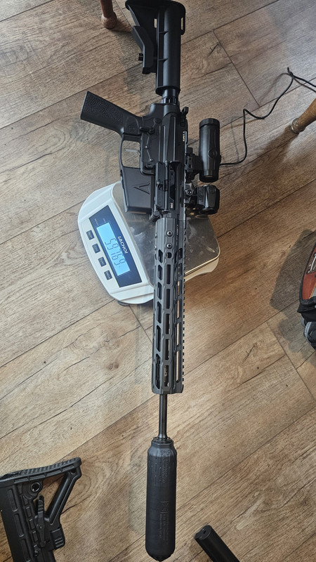

Here's my first foray into building a lightweight AR:
5.98lb with magnifier and can. Just barely making the sub 6lb target. In fact, just putting on the optic covers is enough to tip it over the threshold.
4.64lb without the magnifier and can
I'm excited to shoot it next weekend

Nice. Can you give us a parts breakdown?
11/10/2025 11:07:39 AM EDT
[Last Edit: prinkeps][Edited] [#15]
Originally Posted By L119188:Nice. Can you give us a parts breakdown?
Yeah of course.
Parts include:
V Seven 7075 enlightened receiver set
V Seven 11.1" hyper-light handguard
V Seven carbine buffer tube
B5 systems car15 stock assembly
Faxon match 14.5" .223 wylde pencil barrel with pin and welded Huxwrk muzzlebrake
Superlative arms titanium adjustable gas block
huxwrx flow 556ti suppressor
Breek Arms Micro warhammer charging handle
Faxon gunner lightweight bcg
Tubbs flatwire spring
Taccom ultralight buffer
Optic set is holosun SCRS GR MRS and holosun 3x flip magnifier
Geiselle maritime bolt catch
JP ambi mag catch
triggertech competitive trigger
hogue 15 degree grip
and the rest of the lower parts were vseven
11/10/2025 12:47:00 PM EDT
Impressive build. Thanks for the details

Originally Posted By prinkeps:
I had a goal to get an AR-15 to sub 3lbs without going the SBR or pistol route while still keeping a functional gas system.
I just got back from shooting it today and I'm happy with how it turned out.
https://i.postimg.cc/V0S08ht9/ar-weight.jpg
https://i.postimg.cc/xNkN2Zmz/ar-profile.jpg
The parts list:
Upper:
Barrel is Faxon 16" pencil with integrated brake that I had turned down.
BCG is a DSA aluminum sandcut, with IronCity Ti cam pin, V7 Ti firing pin, and RCA adjustable gas key
upper is Roam R-15 that I milled off the FA and the center of the picatinny rail
charging handle is luth-ar 601 style
gas tube is aero precision mid length
gasblock is B.A.D. Ti
Handguard is JAG composites ultralight 10.5" w/ aluminum screws
The optic is a Sig Romeo Zero on a custom 3d-printed riser made of ASA-CF
Lower:
Tegra Arms CF lower
LPK is polymer parts from a RT15 complete lower
stock is Smoke Composits short pull, open
Smoke composites end plate and castle nut
ultralight taccom buffer
pistol grip is 3d printed grip from ASA-CF with a layer of epoxy to prevent CF slivers
incredible. I have owned carry pistols that weigh more than this... Really curious how it shoots
@MacManus
2/17/2026 4:08:22 PM EDT
It's a pretty snappy impulse and the muzzle likes to climb compared to more sensibly weighted ARs so rapid followup shots take more effort.
The balance is pretty front heavy since the barrel makes almost half the weight. The polymer trigger group is better than I thought it would be with a pretty clean break.

@prinkeps thanks, I was curious what the recoil was like on the lightest (I think I've ever seen) a rifle set up in this caliber. My 3 gun rifle was like 12 pounds and rifle gas/big comp so no recoil but pretty loud.
