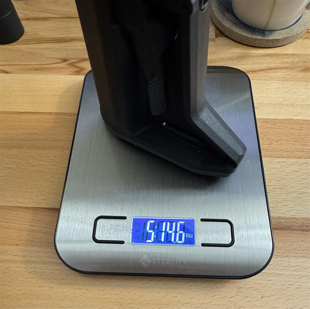

Here's my Cola Warrior prize table, built for everyday use, fairly lightweight, mostly aluminum and not plastic, AR-15.
Cola related parts include the SOLGW Cola branded lower, Geissele SSA-E trigger, an ALG EMR V1 12" rail from Cola West II, and an Arson Machine Co. MLOK QD sling mount on the rail.
Red dot is a SIG Romeo 5 in a factory mount.
Flashhider is an old steel Gemtech Bi-lock so I can run my Gemtech suppressors... it's not particularly light, but it is lighter than the newer versions.
The barrel is a 16" Ballistic Advantage pencil profile midlength in .223 Wylde with their factory gas block... it's pretty light.
This rail came off the prize table at my very first Cola Warrior which was held in Reno, NV... it's very light and handy with lots of MLOK mounting points.
This 12" ALG EMR V1 has a Cola Warrior marked Arson Machine Co. MLOCK QD mount out front from the prize table at Cola Northwest.
The upper is a lightweight DSA that, while light, has unsatisfactory tolerances and required shimming for an appropriate barrel fit... it's light but I can't recommend it.
Charging handle is a Radian Raptor LT... and like everything Radian it is very well made and it's also pretty light.
Polymer dust cover is from Strike Industries... very light and easy to install.
Forward assist is also from Strike Industries and was something I had sitting in the parts bin... not particularly light, and a forward assist is certainly not necessary on this build. In retrospect, a lightweight upper without a forward assist would have been the smart move but I got the upper for a deal and sort of on a whim.  Oh well...
The biggest, and most expensive, weight saving component is the 2A Armament regulated, titanium bolt carrier... crazy light, easily adjustable, outstanding quality.  Very impressed.
The bolt is a nitrided Faxon that was sitting in the parts bin... not sure if there are any reliable lightweight options when it comes to AR bolts.  This Faxon bolt seems to be of decent quality and average weight.
The lower is a run of the mill Cola Warrior branded SOLGW forged lower... not a lightweight lower by any means, just a quality forging with a fantastic rollmark.
Trigger is a Geissele SSA-E from a Cola fundraiser for a fellow Cola Warrior who was facing a medical crisis... fantastic trigger as usual from Geissele, and the serial number matches the serial number on my Cola lower, so that's kinda cool.
No clue on the manufacturers of the aluminum receiver extension or steel castle nut but the end plate is an IWC QD sling mount... just random, regular weight stuff from the parts bin and I could probably shed some weight here without sacrificing strength or reliability. I do trust the IWC QD mount though so I would probably keep it on this rifle.
Buffer is a generic carbine buffer with nothing in the tube, all weights removed... weighs one ounce and can't get any lighter.
Recoil spring is a red Sprinco... it's recommended by 2A Armament for use with their adjustable titanium bolt carrier and an empty buffer.
Pistol grip is a Magpul MOE with a steel screw and the stock is a Magpul MOE SL-K with a Magpul QD MLOK on it... these are just reliable parts that are on the lighter end of the spectrum but not specifically manufactured in the pursuit of weight savings.
Not sure of the manufacturer on the ambi safety but it's steel and works as it should... I could certainly save some weight here I bet.
Trigger guard is your typical Magpul aluminum model and all the other lower parts like the mag release, take down/pivot pins, bolt release, misc pins, etc. are your generic steel or aluminum items... going to titanium  on most of these should save a bit of weight at a serious hit to my wallet.
So I think that about covers it...
And the weight as shown comes out to... 5 pounds 9.75 ounces.
I think it's pretty good for a mostly aluminum AR with dot... and built with parts I would trust to take a beating and run reliably for a very long time.

[Last Edit: MackDaddy1962][Edited] [#48]
The little cheat'r. 8" 300 BO with Wilson Combat barrel. 5lb 14.6oz with empty 20 round PMAG. No suppressor.
The can and Plan A Alpha mount brings it to 6lb 6.5oz
JP LMOS BCG, KVP 4.3oz H2 buffer, a bit of titanium sprinkled here and there. KAK 7.2" rail w/aluminum barrel nut.
