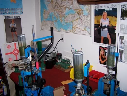

2/3/2007 12:17:50 PM EDT
2/3/2007 12:32:03 PM EDT
wow you really do save in ways. Next thing I need is to get a press that I can load 9mm, .40 and .223. any suggestions?
2/3/2007 1:05:24 PM EDT
Dillons, Like these. Great stuff! A Dillon 550B would suit your needs just fine. 380$ for the press, powder measure ect. You would still need some more items but this is a dandy press.
There is a 650 in the pic also. I use it to load 45 ACP.
